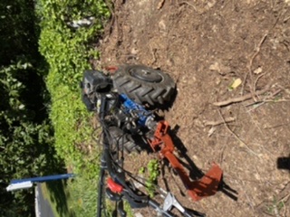

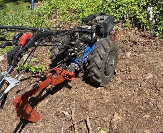

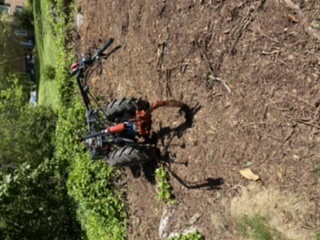

You are correct suggesting a more wide wheel spacing improves roll over stability. My wheels are set wide as seen in these photos. I can attest to improved wheel traction by adding wheel weights. A 65 pound (30kg) addition increased traction by an estimated 25%. I am now looking to buy smaller O.D. weights to put inside the wheel rim for another 100 ponds (45kg).

Am I right im believing that you have the larger 6.5x12x23'' wheels on your tractor?
