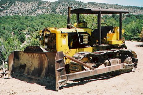

Okay I was thinking about this overnight. Not trying to be a complete idiot here but what was the primary purpose for a cable in the first place? Was this used for logging or winching or some kind of safetey?
I agree I could think of a lot of uses for a cable.
/ Anyone got a compact dozer????? #36
Oh, the cable just refers to the fact that the blade was raised by a winch, usually rear mounted, with a cable run to the front, either under or over the cab and engine, and a set of pullies ... no hydraulics. The attached pic isn't too good but you can just make out a round thingy behind the cab which is the winch.
