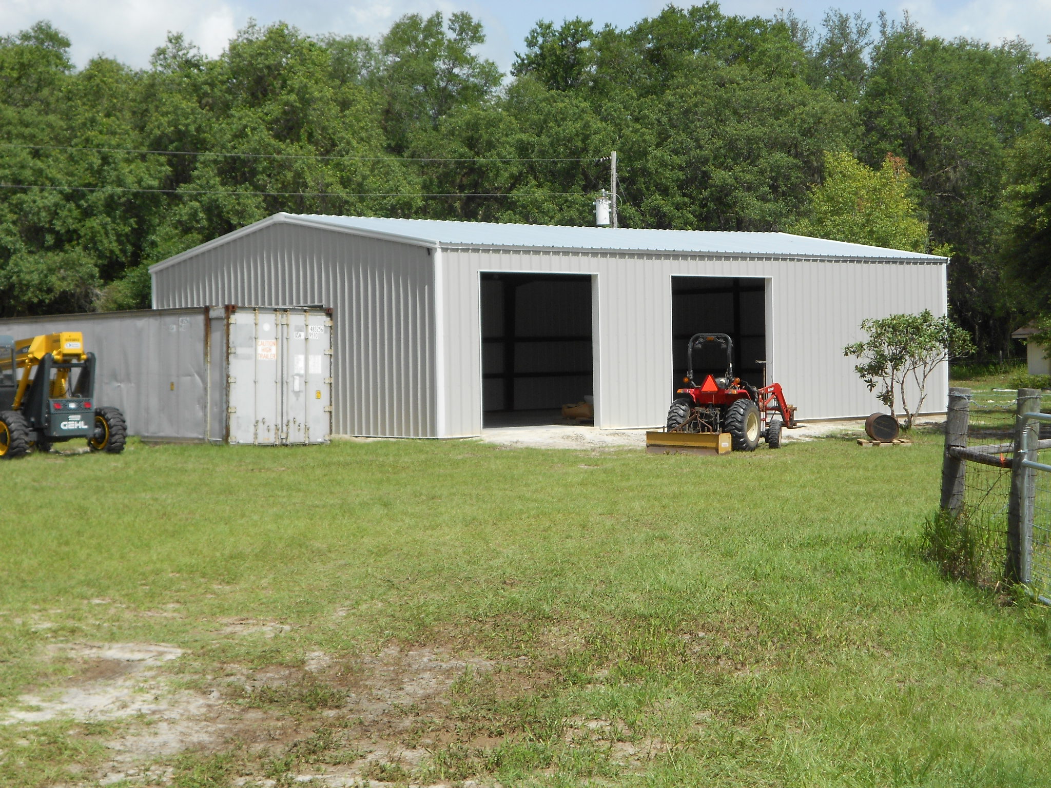

I bought my 40' X 60' X 14' red iron building from Hercules Buildings in Jacksonville Fl. a year and a half ago.
My total cost including concrete was just under $40,000. (concrete was $11,700. ) to give you some idea.
Many of the red iron buildings are made by a few companies that wholesale ONLY to dealers.
My installers were from south Georgia but came here from an install in Louisiana.
Shop several regional dealers for best price!

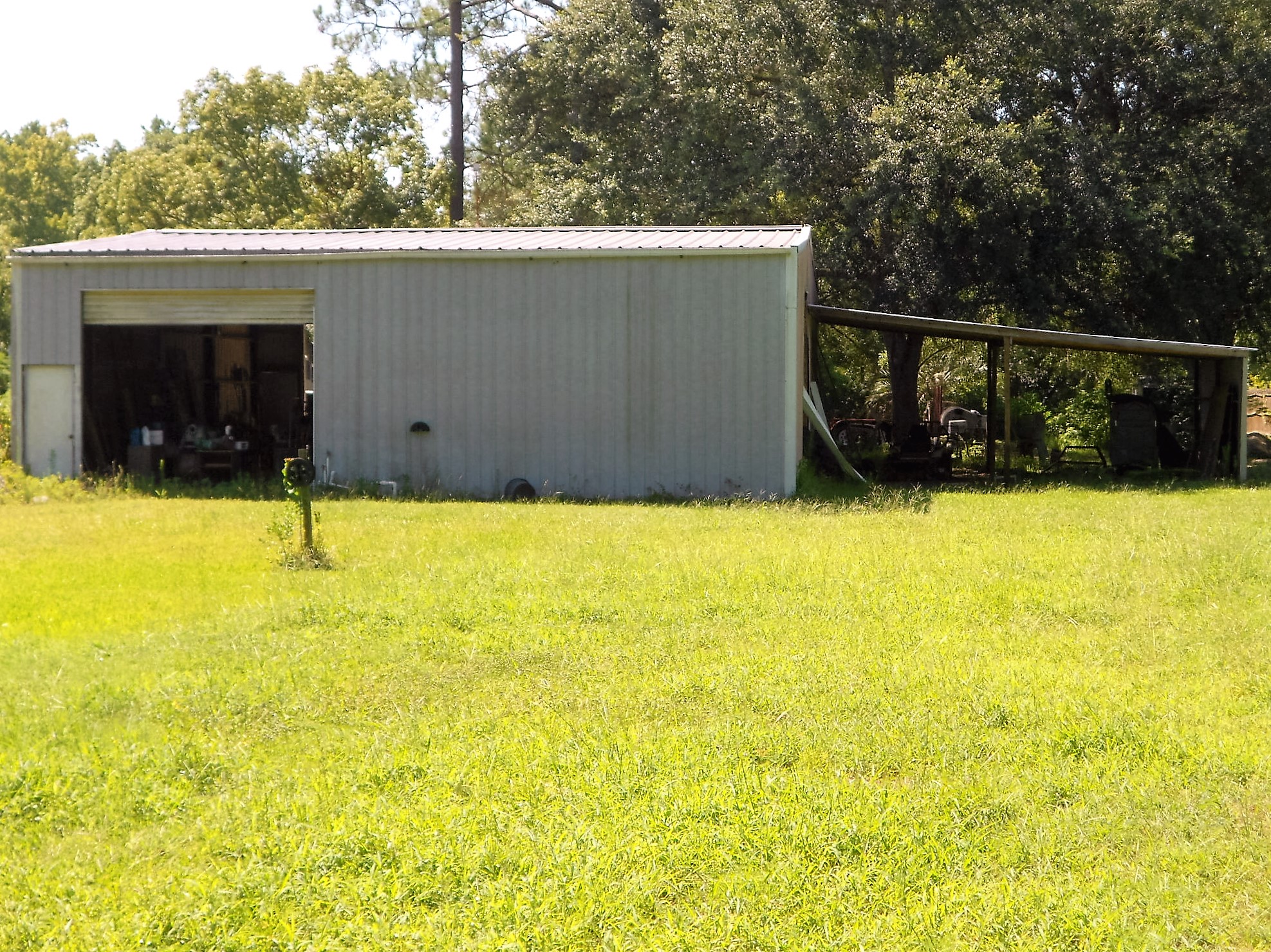

The other pic was at my last property and was 40' X 50' X 12' and was basically a pole barn with used power poles, 2" X 6" perlins.
It was a 24' X 24' garage when I bought the property years ago. I jacked that roof up and build the rest around it.
I had 40' X 65' concrete poured under and in front of it. I had under $7000. in it including $4500. for concrete.
