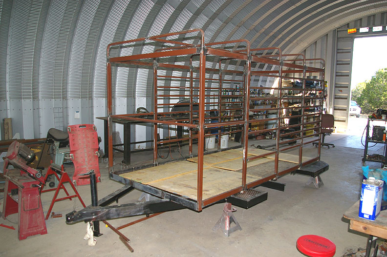

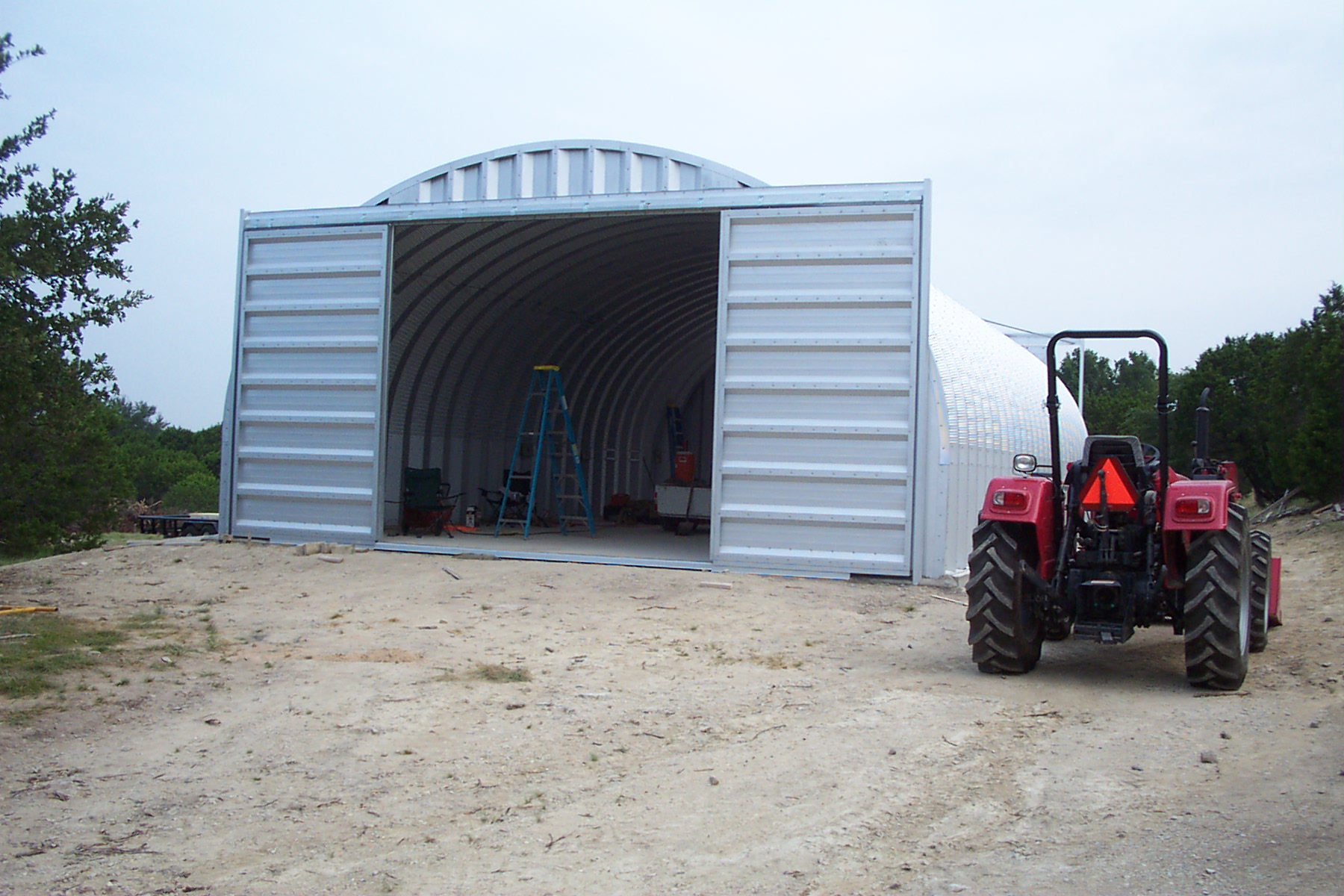

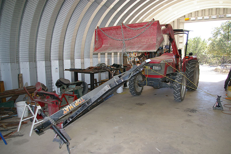

All this talk about how the Quonset style building cannot be used as a shop is interesting. I have been using a 30'X60' as a shop for over ten years. My work benches and an office are along one side wall and materiel and equipment storage along the other. The work is done in the middle. There are 14'X14' doors on each end and the height from floor to top is 16 feet. If I could have found the pics of it they would have been included. But, here are a couple showing an ongoing welding project. 4Feb16_015.jpg 18Feb16_29.jpg
