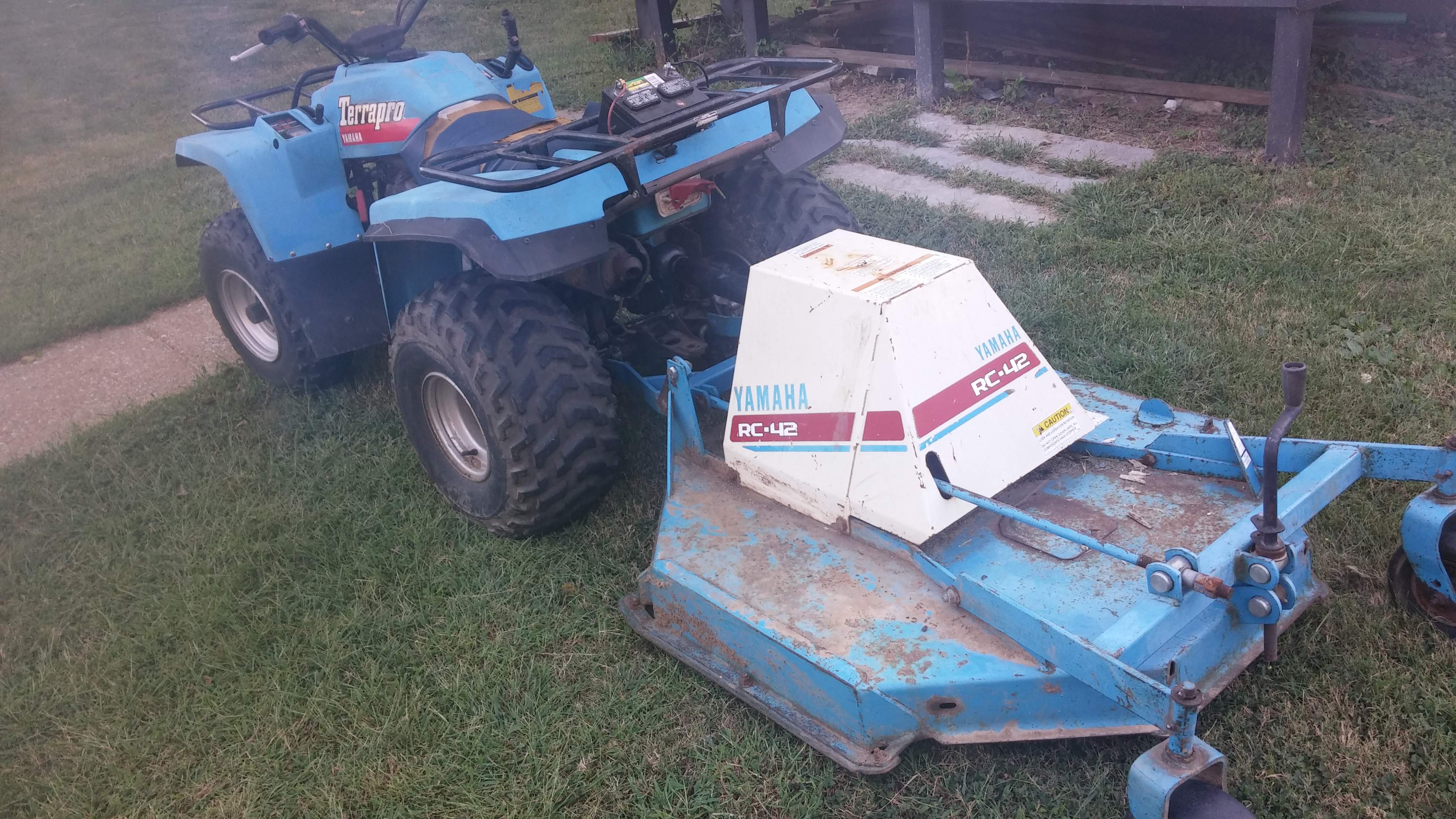

Bringing this one to life again, as every time I search for Terrapros, this site comes up. I'm brand new, here.
I just discovered these units a few weeks ago, and secured two Terrapros. One is in running condition, and came with the 42" brush hog. The second Terrapro I purchased may become just a parts atv. In searching for the attachment that I really need(RT 38 tiller), it seems that I may not have any luck securing one, even in poor condition.
If I am not able to secure the RT 38, I will be fabricating a tiller to use with the Terrapro.
If anyone has a Terrapro, or attachments, I may be interested in purchasing.
I will post updates here, if I go the route of fabricating my own tiller attachment.
Glad to find so many other Terrapro owners here.
Pictured is the Terrapro that is currently running, along with the "rough" cut 42" mower. 2015-09-19 18.05.17.jpg
