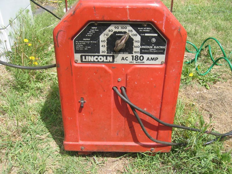

For those who didn't see the lincoln 180 AMP welder I got off craigslist for $100.00 . I'll post some pics here of it.
That's the helmet in the picture that he threw in with it.
I'm definitely glad I went with the lincoln.

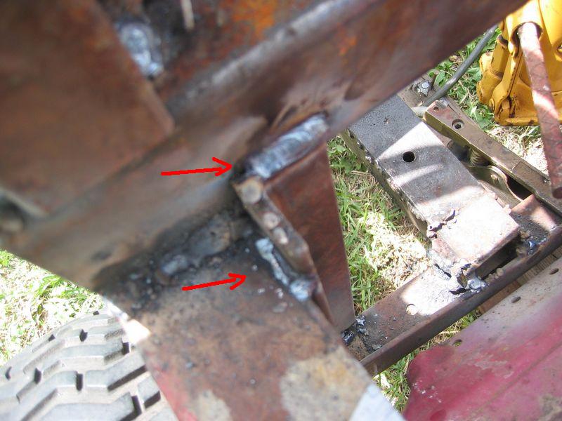

Those are the welds I did with the lincoln as well. This is a great welder.

man you got an awesome deal with a cherry on top!
