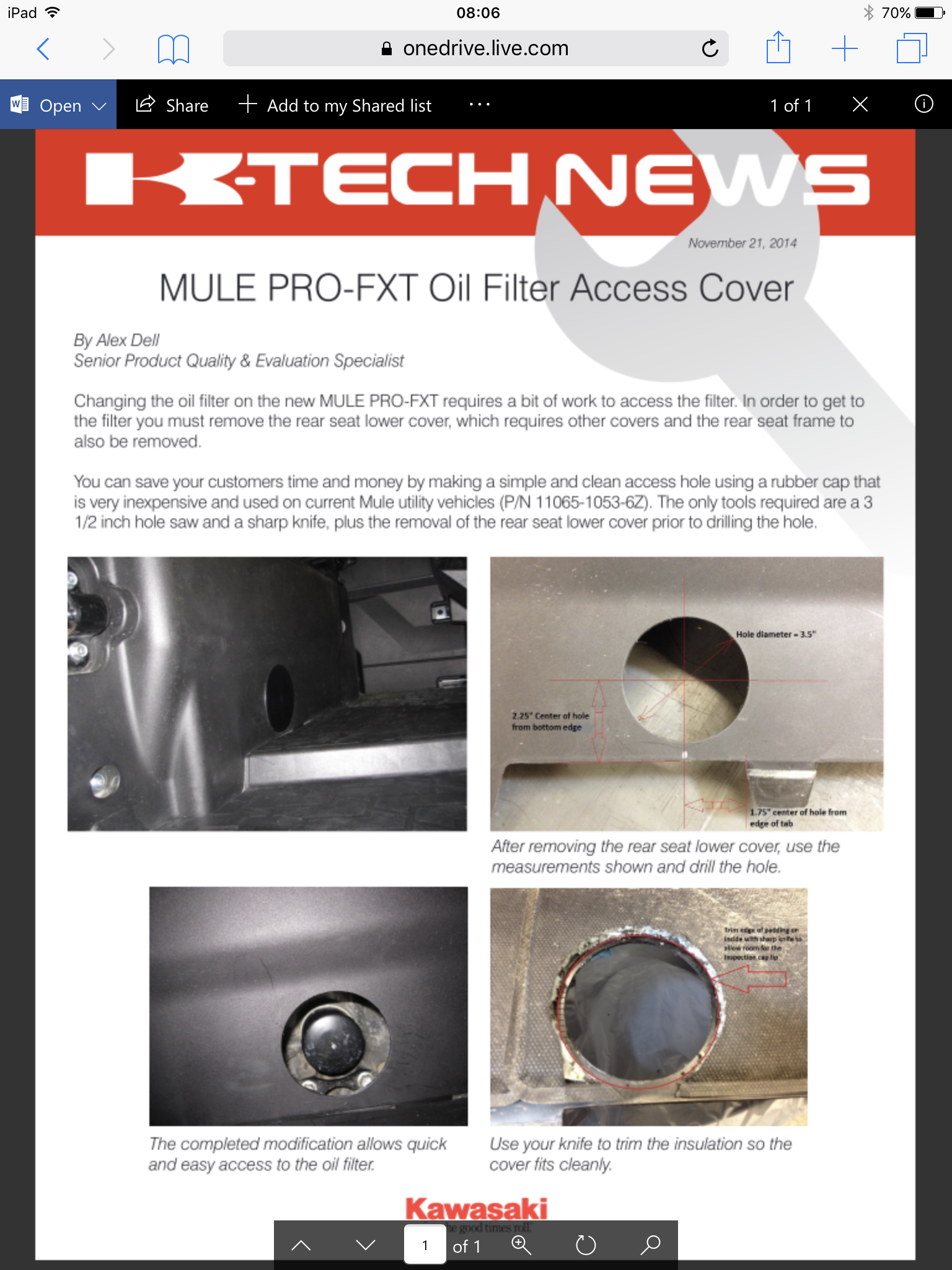

I'm coming up on my first oil change and I ordered a rubber plug from Kawasaki that will make oil changes much easier. The part cost $8 and the part number is in the attachment. Here's what you need to do to install it.
Did the same thing after my last oil change. Worth every dollar!!!!
