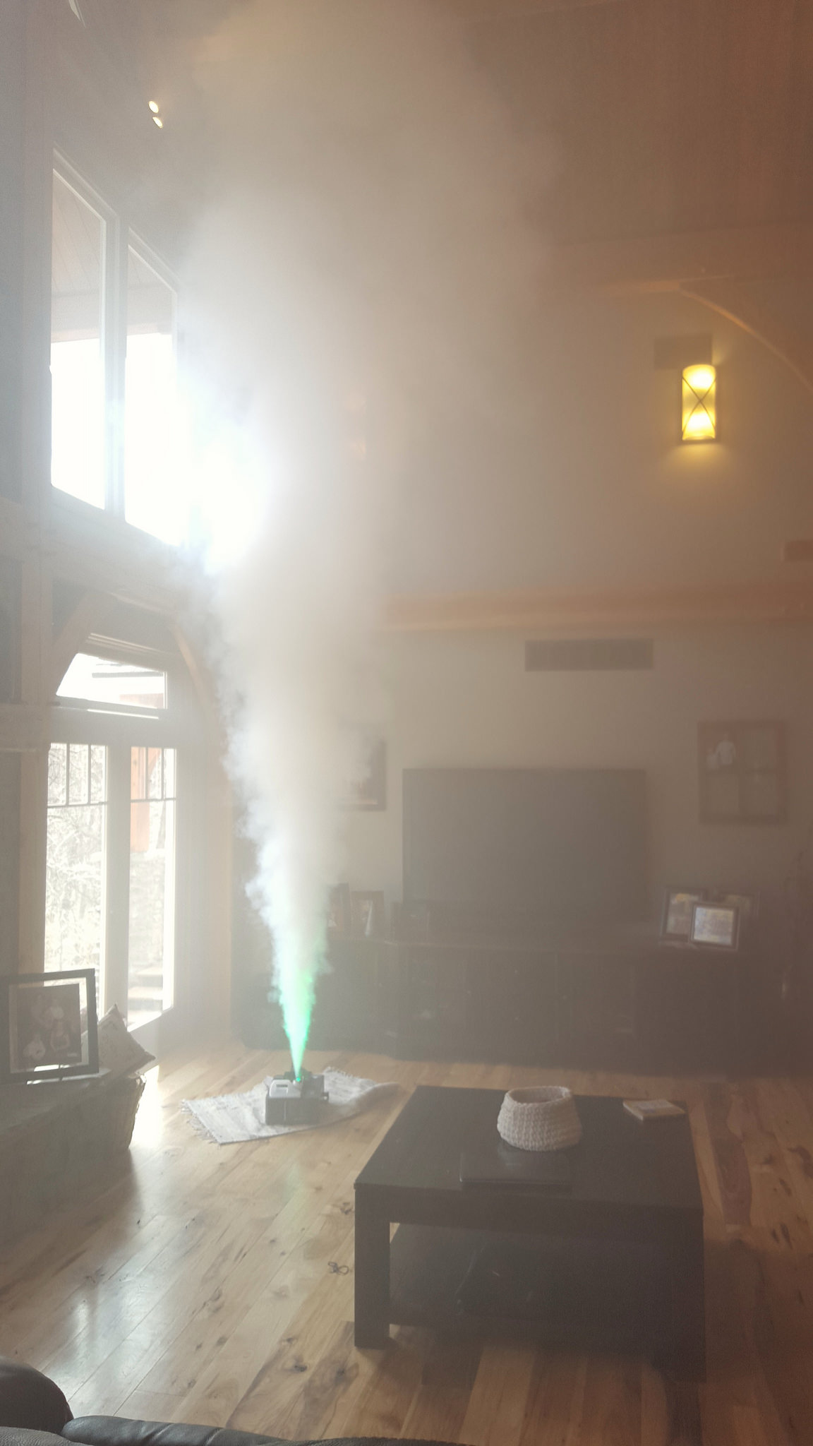

One of the most cost effective investments someone wanting energy efficiency on a limited budget should consider is a blower door test. I think it should be done on all new builds. It will typically only cost a few hundred dollars and is key to finding the air leaks in a building envelope. It's best done on a cool day if possible so that you can see the cold spots using thermal imaging. If you want to make it really interesting use a theatrical fog machine inside the house and reverse the blower door to create pressure inside the home. Do this on a day with no wind and you can walk around the outside of the home and see exactly where your leakage is. We did this both before sheetrock and used the fogger again after the house was finished. One of the biggest leaks we found was around our electrical service penetration. Just don't forget about the need to ventilate with and ERV or HRV with a tight home.
