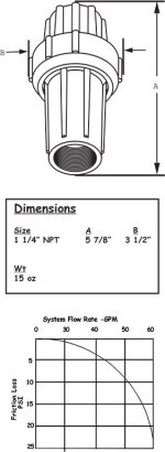

The CSV125 is the most common, I installed a bunch of them doing irrigation work where zones weren't sized correctly by the original installer. It's a 1 or 3 gpm bypass, depending on which version you go with. I put this one on with the 3HP pump, it's right at about 30GPM that the pressure losses get huge.
CSV125 – Cycle Stop Valves, Inc

I installed the CSV-1A- just checked specs-it is a 1gpm bypass

Most of my customers didn't want to spend the additional money for the CSV1A, you'd be surprised at how difficult it was to convince some of them to do it at all, given the expense of replacing a pump.
I did the plastic one initially because I installed it on my down pipe about 5' from the top, the brass one isn't really meant to be installed that way. The new one will get installed outside the hole.
