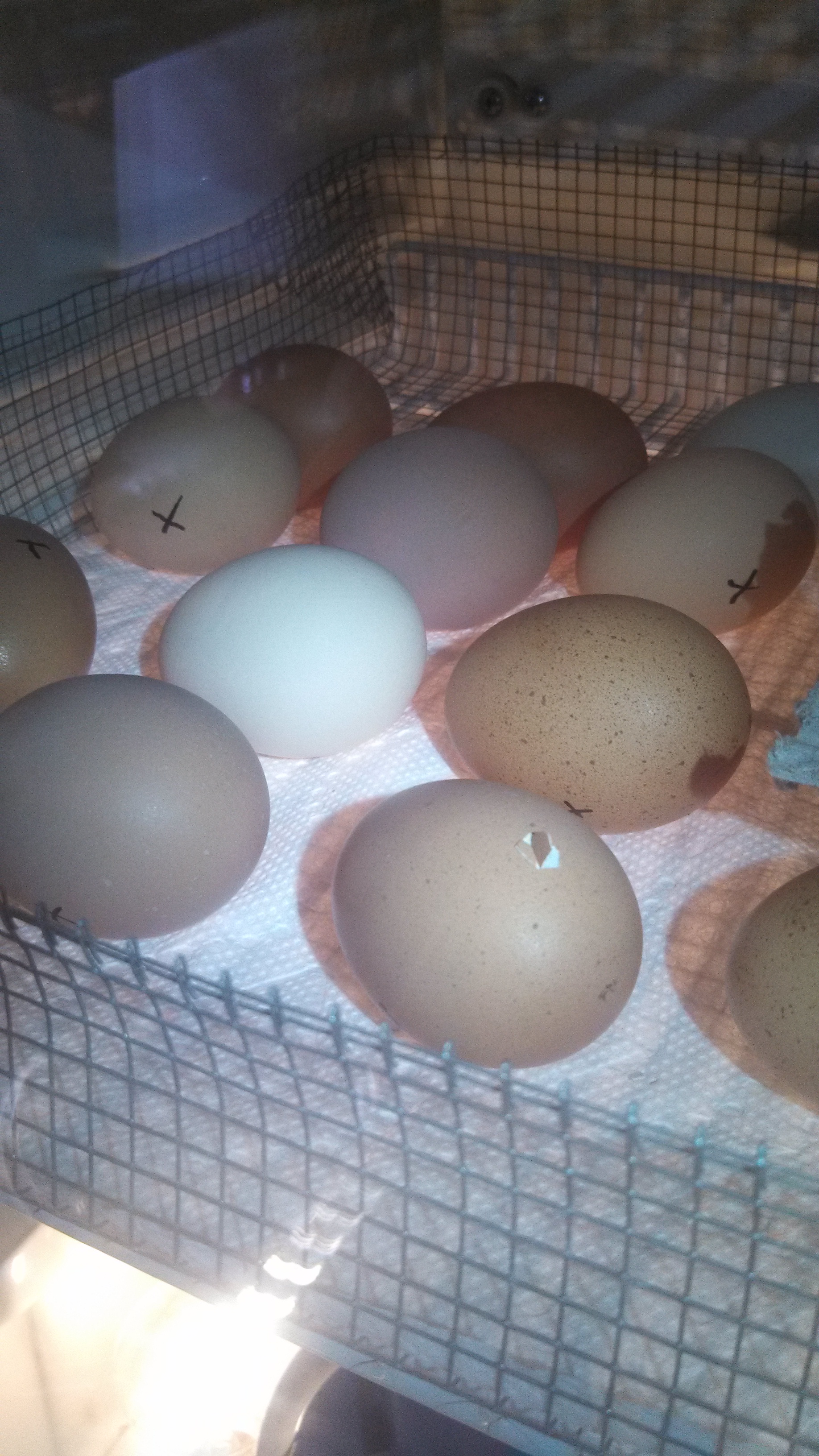

First one pipped about 4:03 and 4 more by 6:40.

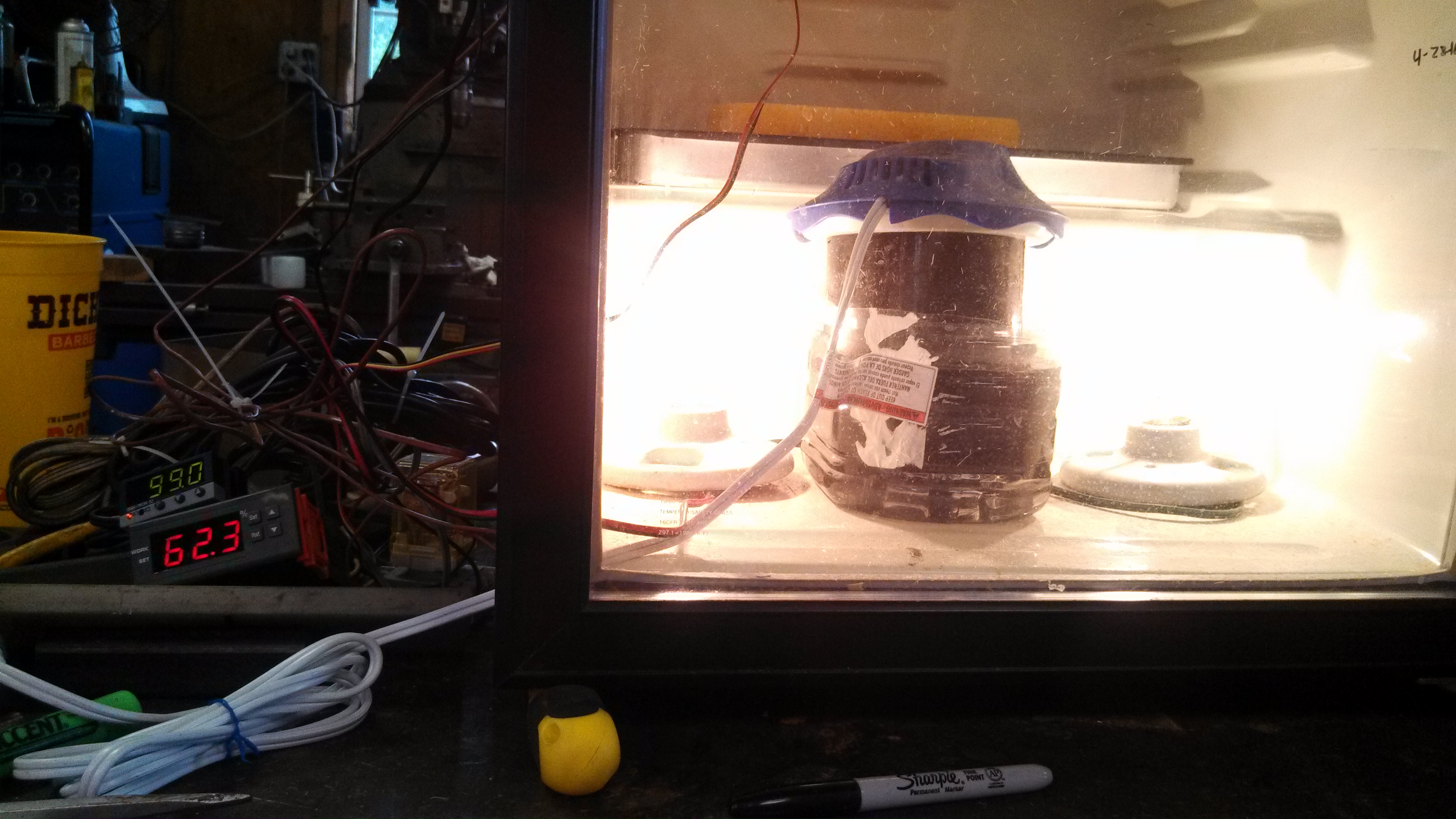

The temp was easy, mine vaired four tents of a degree F but I had the hystersis on the PID controller set at .2 F.
The sponge and water wasn't as consistant as I wanted so I swapped it for a humidity control activating a humidifie, the water bucket was long gone so I just stuck it inside a plastic juice container I cut the top off of. It controlls humidity to 1% of set point.
I bought a few of those fog machine wafers and hooked up a humidity controller. My buddy made that too. when humidity dropped, the fogger would make smoke and could quickly raise the humidity. I used a 2 gal water bottle I bought at Wally world and connected it to the water tray using a float valve. I never had any problems running out of water before the hatch was due. I did drown a few eggs before I figured out the proper settings. again, the humidity raised heck with the electronic thermostat. I eventually did away with everything electronic and just used a large water tray with sponge, along with the water bottle and float valve. Once i figured out the proper water surface area needed to maintain humidity, it was just about set it and forget it. Keeping it simple was a lot easier than trying to reinvent the wheel, but I gave it a heck of a shot.
   / Anyone here incubate chicken eggs?
#30
The PID and humidity control use thermocouples to measure the temp. I am using "K" type, what my friend gave me they have a range up to 1200 F or so and are stainless steel. The electronics are outside the area you are measuring. Not sure how high the humidity control will work but I wouldn't expect either controller to last as long if they were mounted inside vs out.
