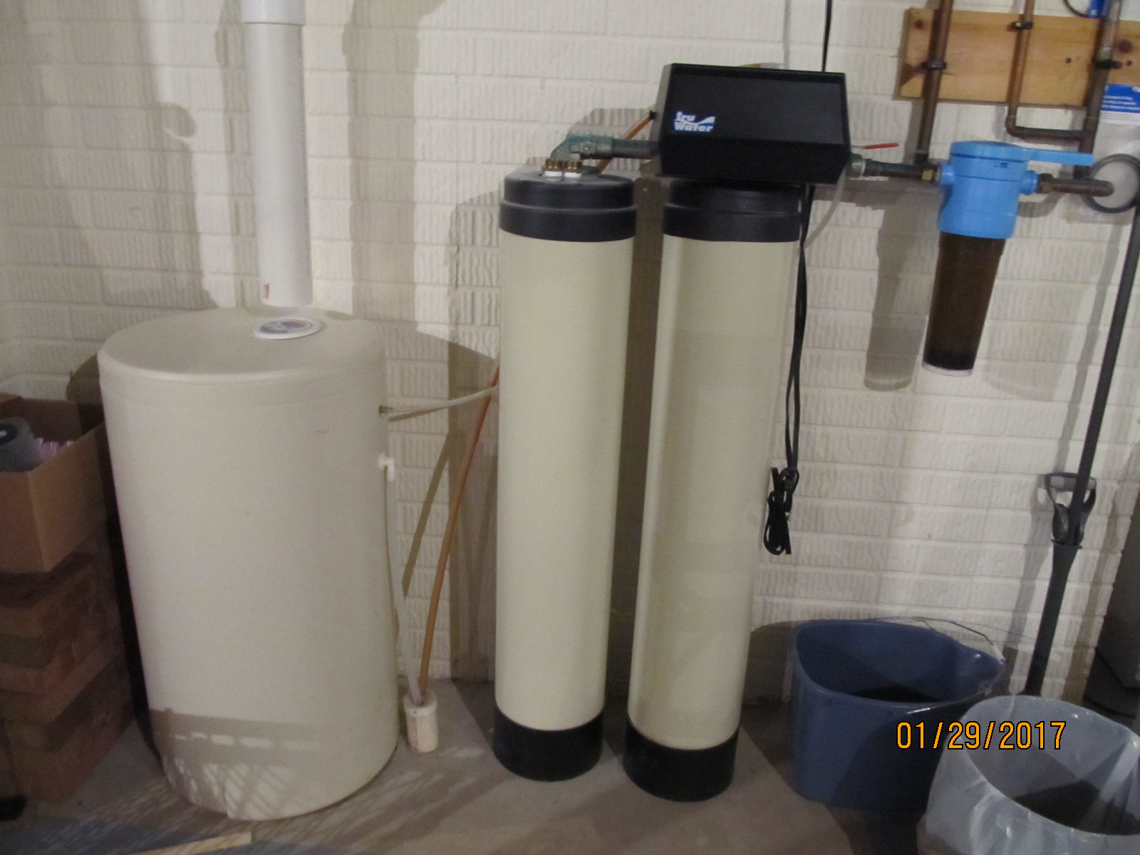

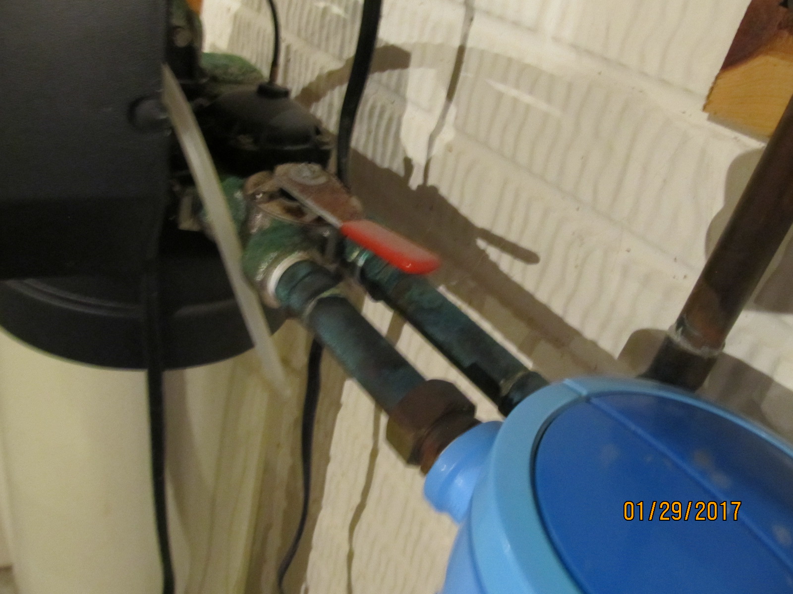

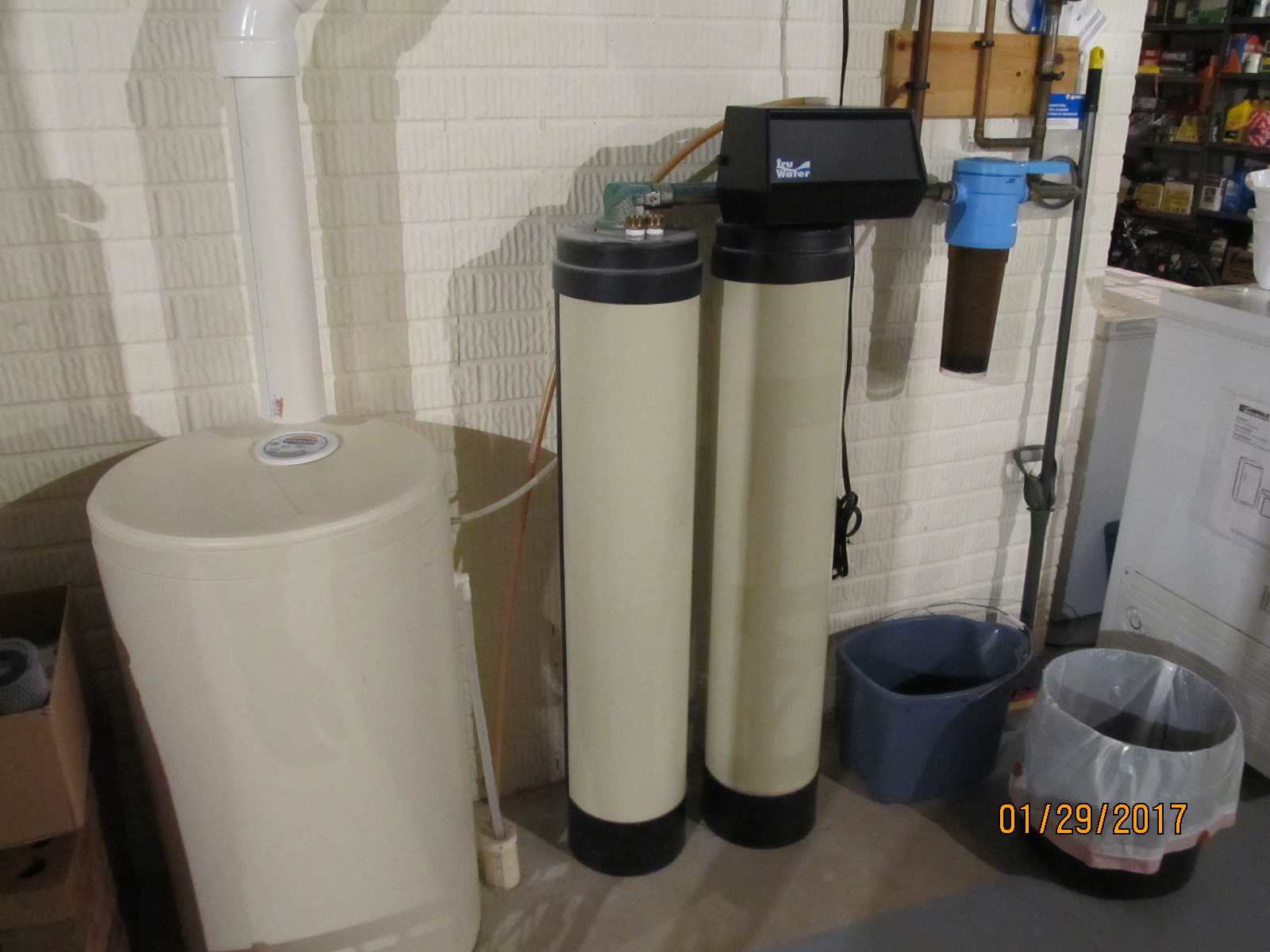

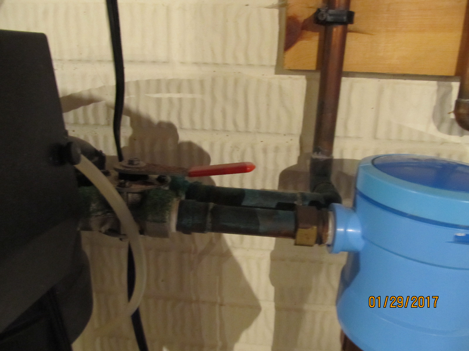

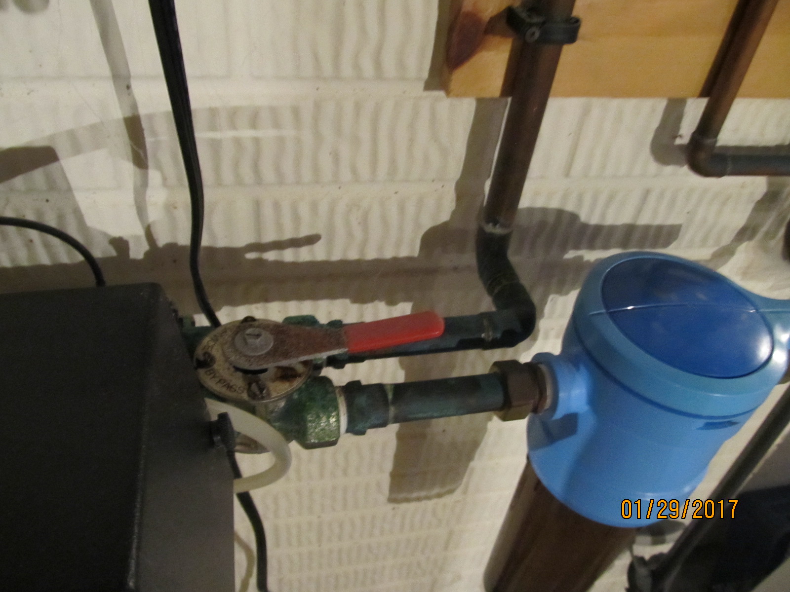

Here are the requested pics. Fittings look easy. I know how to solder anyway, so no big deal and all is accessible.
That's my water filter--blue-- on the right. The pump coming down into the softener tank is from the garage and allows me to dump the salt from there and it falls into the tank. It's just the way people do things around here.
If I do it myself, and I almost certainly will, I want to do it when things warm up in the spring.

This will be straight forward! Shut water off, cut the two lines the connect to the softenerclose to the fittings on the softener side and push on the Sharkbite 3/4" C/PEX male adapter (C=copper). From the male adapter you will need water flexes. The flexes will have to be 3/4" x 1" OR 3/4" depending on the softener you choose!
I don't see a water shutoff in the picks. If you don't have one you will need to add one. Most of the new softeners have a bypass built in so you don't need to worry about that.
I know PEX makes water flexes. They would work if you got a softener that has 3/4" fittings. Not my personal choice but an option.

I see two possible problems with the swap out.
One, your softener looks like a twin tank unit which are generally used with extremely hard water. Check your hardness first. If it's over 30 grains hard, you will need another two tank unit.
Secondly, be aware that not all softener heads have the in and out on the same sides of the head. You certainly don't want to hook it up backwards and pump mineral through your plumbing system.

speedbump...Water hardness test done shows 24 gr. harness and 1 1/2 PPM iron.
I have all the original installation paperwork and instructions.
   / Anyone here replaced their water softener on their own? #19
The GE will work fine at 24gns. I believe it's the same as the Morton unit listed above.
