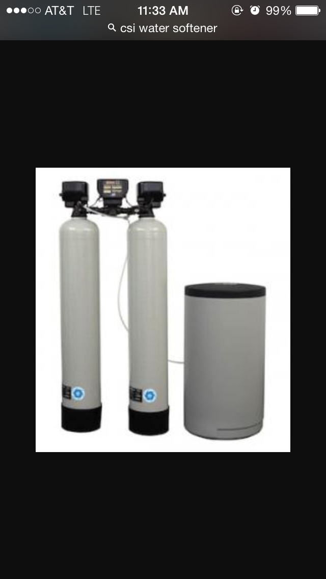

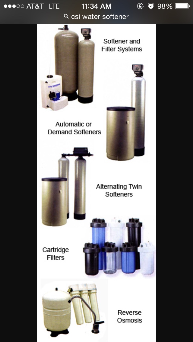

I did apartment maintenance and we always used sharkbites, In my own house that's all I use also.
So far I have put in a 10in whole house water filter on the main coming into the house. I put a water Spicket so I can hose things off in the basement when needed, and I installed a new twin tank CSI water softener. The water softener I chose was more of a commercial unit and I think I paid $1200 for it at a supply house, installed there $3500+, assembling the thing was the most difficult part lol.
All I did to hook it up was cut the copper, cleaned the copper with emery cloth and looked for defects on the copper, I used two 12" sharkbite to threaded end supply lines and was done in two mins, it's never leaked and has served me well.
The supply house I bought the softener from did free water tests and that's how I set the softener up. I love my softener, I never run out of softened water like I would with a single tank set up, it was a bit pricy but worth it.
Mine is double tank with the brine tank separate, my softener is double tank with a single controller.
