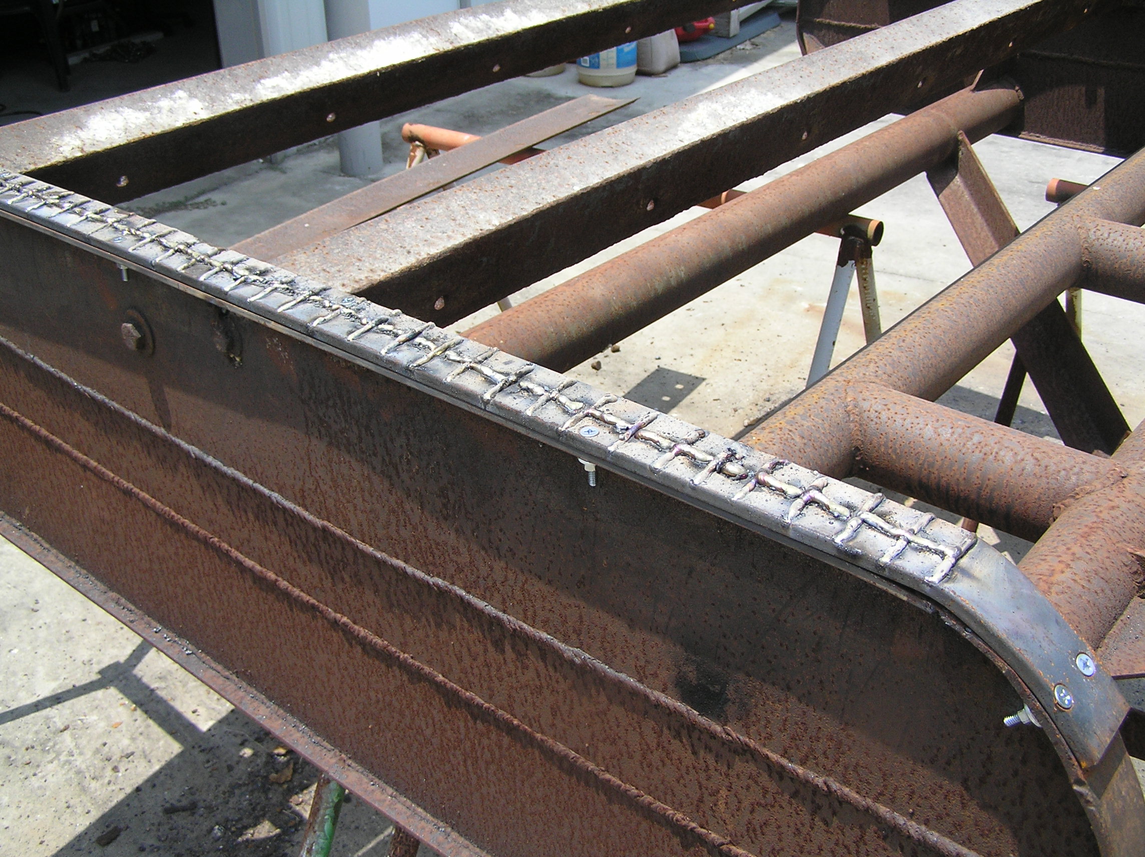

After reading Dave's post, it might make sense to just replace the 3/8" flatbar runners every few years. However, I did buy a 10 lb box of hard facing rods today, before I read today's comments:mad:. They cost about $10/lb:eek:. Since I already have them, I figure I can experiment. I read the articles and it seems that some type of waffle pattern is the way to go. I would normally think the way JJ does otherwise.

Id go with waffle pattern. THe "pockets" will trap more fines and act as a better cushion. The stringer style is better for larger aggregate that cant penetrate to the base metal.

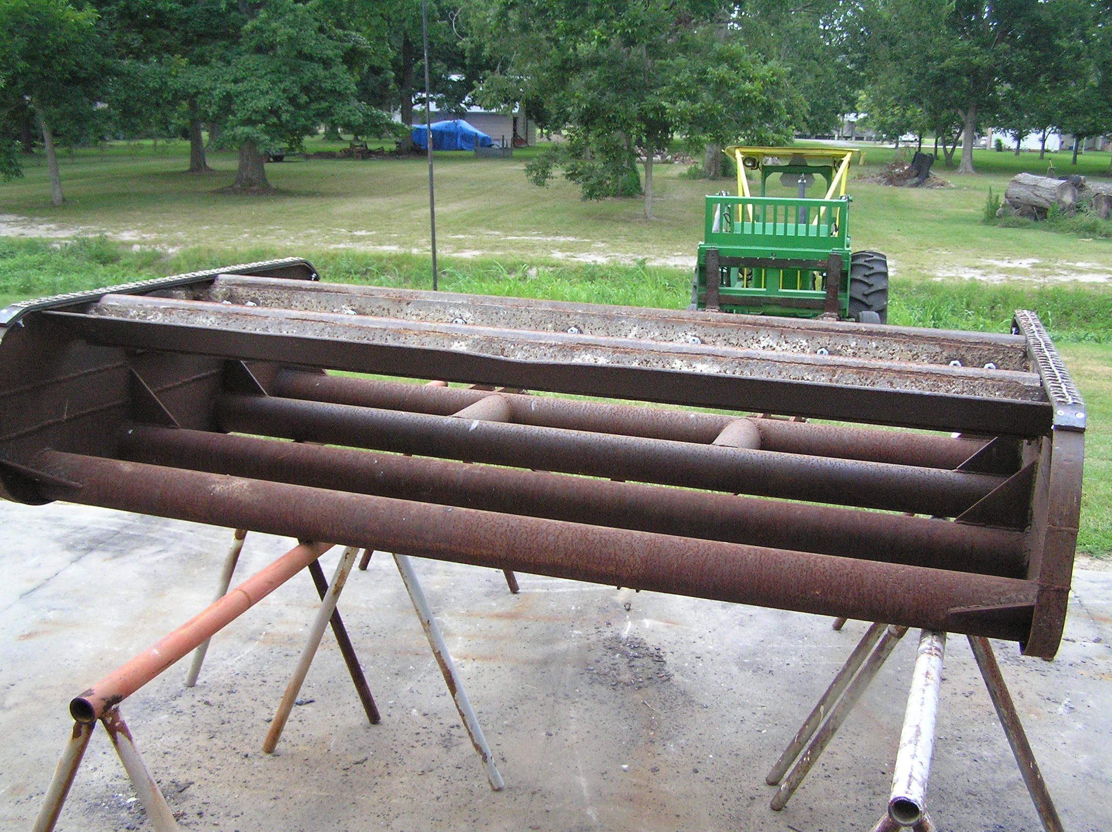

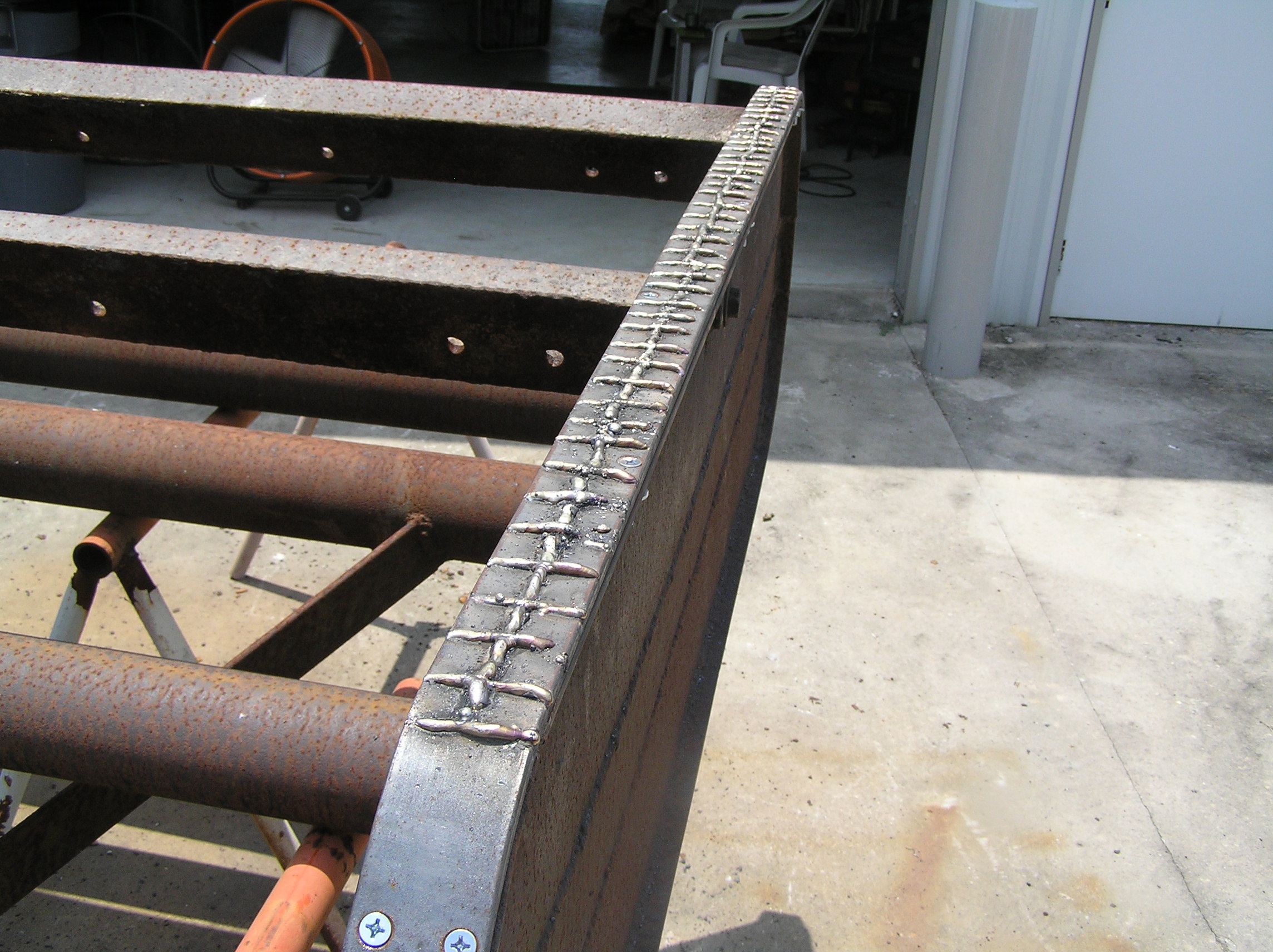

Well guys,
I finished the repairs to my bionic blade. Attached are some pictures after I put hard face beads on the skids.
The last photo shows the old blades installed. Had to flip them over due to extensive wear. I finished putting burnt oil on the lower portions of the box this morning.
Thanks for all the great ideas.
Mike
   / Anyone know how I can harden home made skids? #30
Looks good. Ill be interested in hearing how well your hard facing works out. Good Luck.
