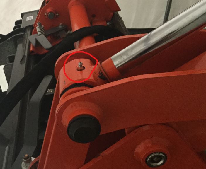

I broke a zerk fitting on the LA 1154 front end loader on my Kubota M7060HD12. Who knew there are a million different sizes of zerks? It looked exactly like a metric M8x1,mwhich will start in the hole but does not fit. Turns out it is a 5/16"-22 BSF fitting. You will not find those in any of the grab-bag zerk kits. I bought some from McMaster-Carr.

OK. That's an odd one. How did you figure out which thread it was?
   / Anyone know the thread size of Kubota grease fittings? #36
I bought a Lock and Lube thread tester after trying everything in my standard and metric grease fitting collection. Thanks for the great lists, rScotty. Not surprisingly, the M8x1 and the BSF 5/16"-22 are very similar in size.

Darn it! I was wrong, not a BSF 5/16"-22. It did not fit. My Kubota dealer managed to track it down for me. Turns out it is an M8x1.25 (the difference between the M8x1.25 and M8x1 is the pitch of the threads). The zerk I'm talking about is on my LA1154 front end loader. See the picture below.
