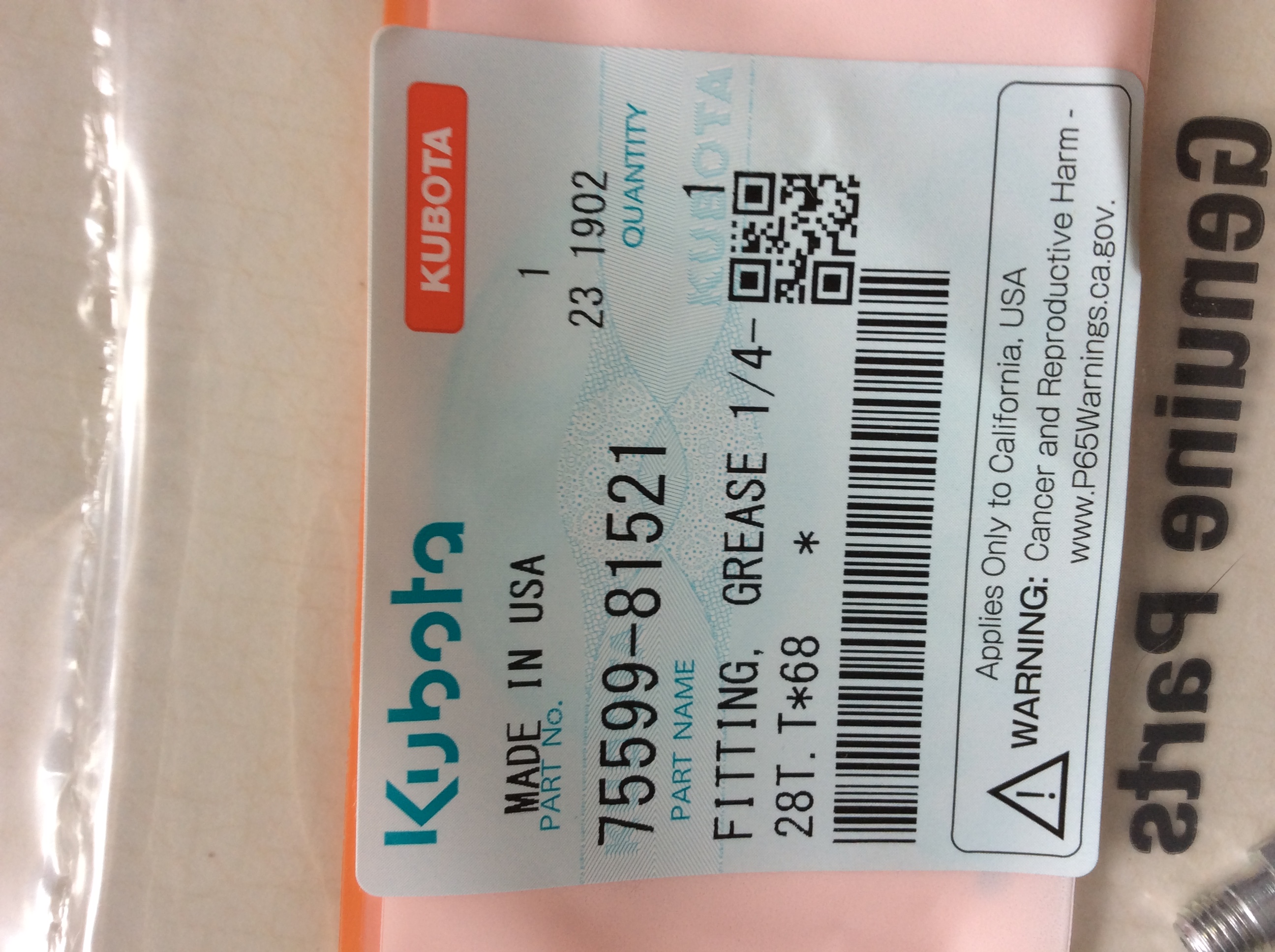

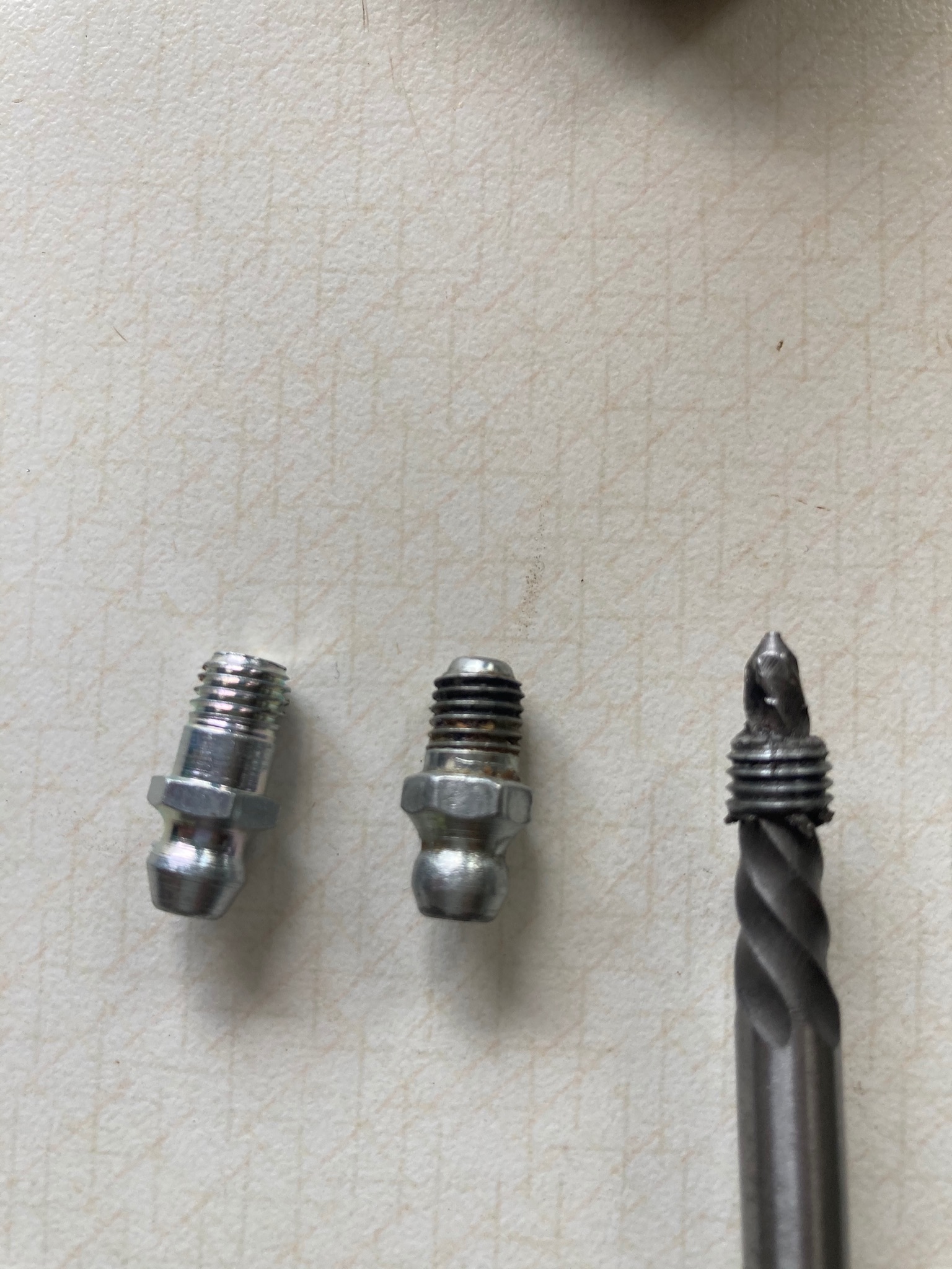

Ok, here we go
I have a MX5800 tractor with the LA1065 fel. 6 months old. Broke a zerks/grease fitting on the very front of the loader where it attaches to the bucket, 4 on each side. Careful, fittings on the arms different size. I知 sure it broke because it was the lowest and I probably didn稚 remove the grease gun just right. Next time the loader goes up! 10 mm socket on these fittings.
The photo shows the broken fitting on the ez out, a known oem factory fitting from the adjacent location that fit where the broken one came out and the new fitting from the Kubota dealer. I noticed they appear different, less threads, a little different look although it worked. Also 10mm.

All my fel fittings were loose except the one that broke, I mean finger loose! It figures, the one that broke was too tight. Neighbor and I fought it for 1 hour, almost got the torch out and had already decided to pull the pin if I had to. It was way way too tight, imho.
68 cents for a new one, I splurged and got 3!
