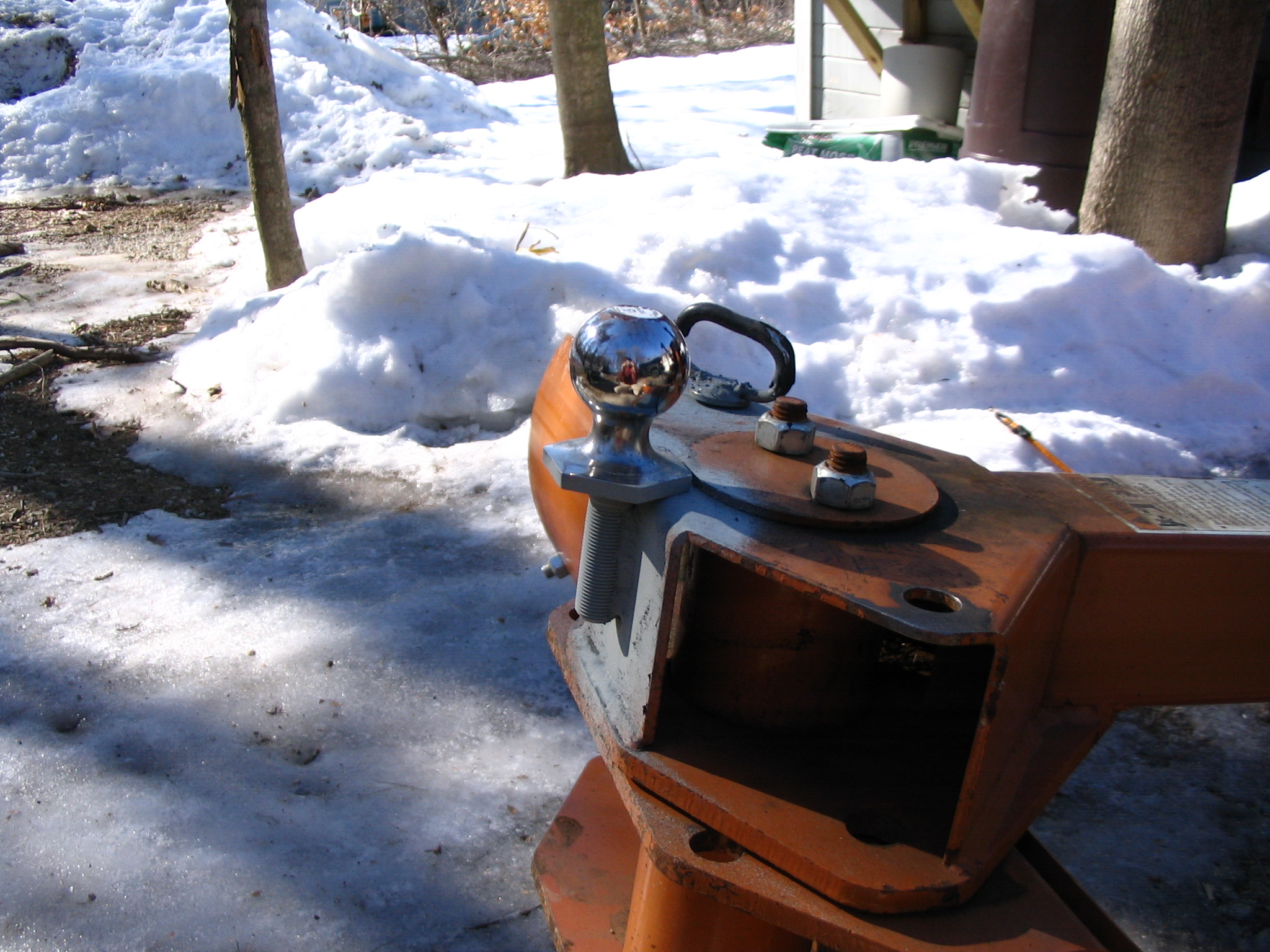

   / Anyone mounted a trailer hitch ball on FEL? #2
T dog,
There are a number of ways you can do this...
There are manufacturers who make bucket clamps that have 2" receivers for a ball set up like one you would use on your truck...
drill a hole in the bucket and drop a ball in....
A rear drawbar on the 3 pt hitch (with a stabilizer) for a 2" receiver,
or do like i did and weld a ball to my rear grader blade.
I find moving the trailer with the bucket, unwieldly, as the bucket clamps flex the bucket and tends to bounce alot... not to mention its hard to see the ball when trying to hook up.
Systems on the rear are easier, to back up and use the 3 point to move the trailer.
Some have even mounted balls on the edge of thier back hoe frame, near the stabilizers to move trailers...

   / Anyone mounted a trailer hitch ball on FEL? #5
I like the ball welded on the rear blade...quick/simple....wish that had popped into my head.
I just bought the parts to put on my bucket.
First option in just the receiver tube welded in place of where the hook is now. I have a straight ball to go in (no drop). Doing this, I would still have to add hooks or D rings for the lifting straps.
The other option (part) that I have, is to weld on the "bolt on receiver hitch" for a step bumper. What I would actually do is weld on a wider plate on the bucket and drill the appropriate holes in it and bolt the receiver down. Might give more options if I am able to remove it later. Also has the safety chain holes in place and gives me some options on adding hooks and/or D rings.
I may actually work on it this week:rolleyes: I'll try to get some pictures of the mock up- posted today.

   / Anyone mounted a trailer hitch ball on FEL? #8
I welded a receiver hitch to mine and made my own 3 pt unit for moving trailers around from front or back of tractor.
