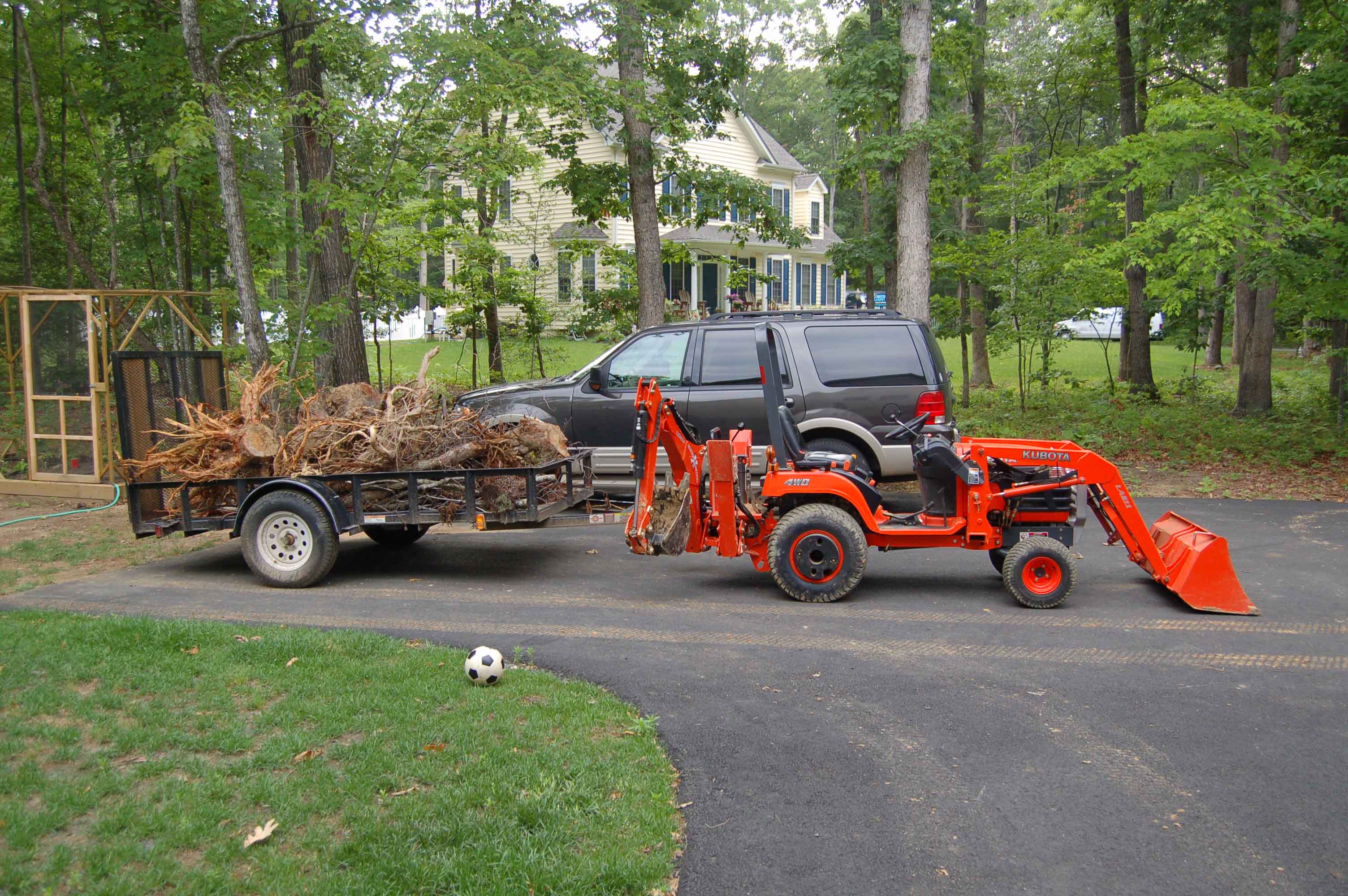

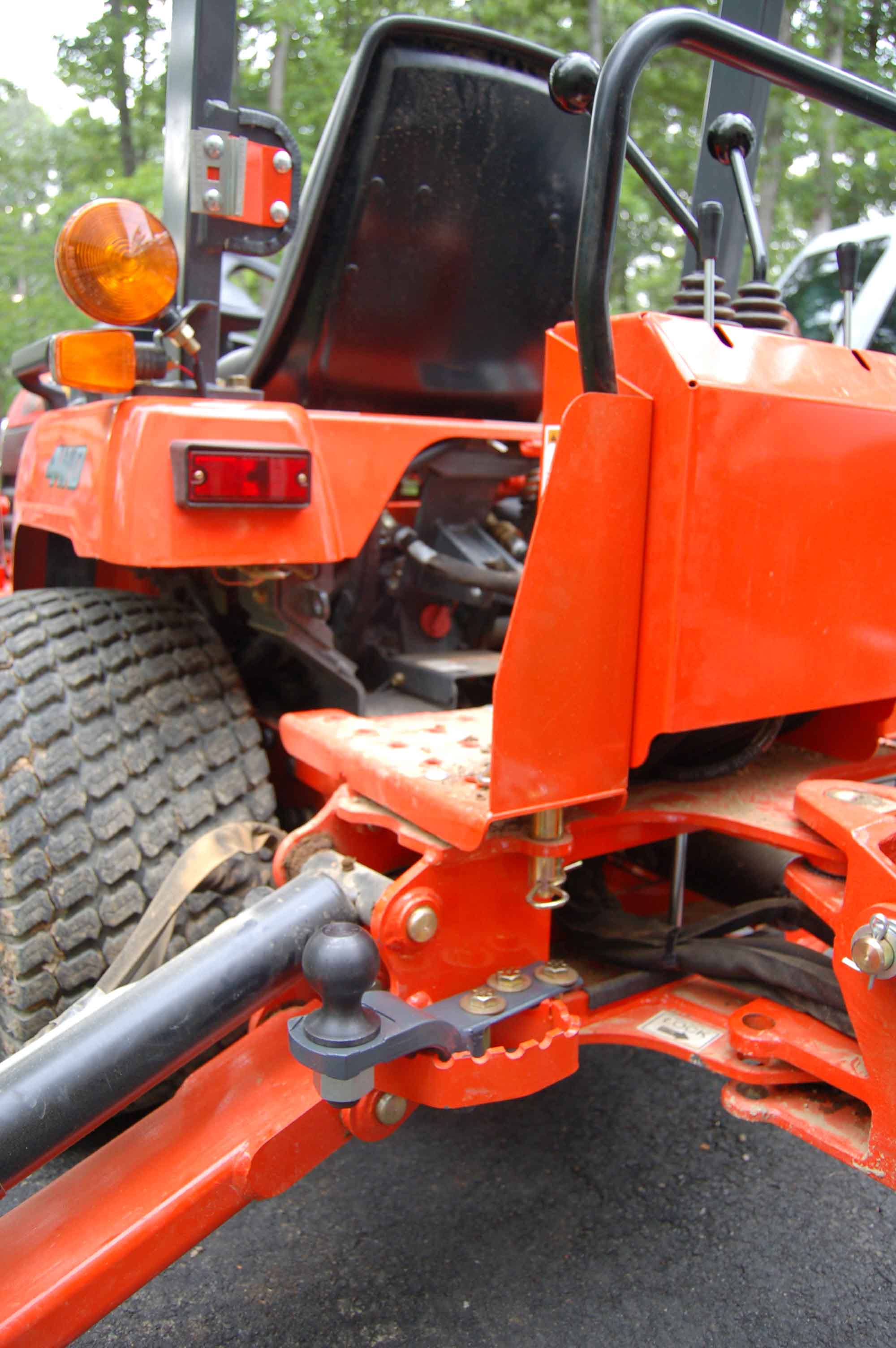

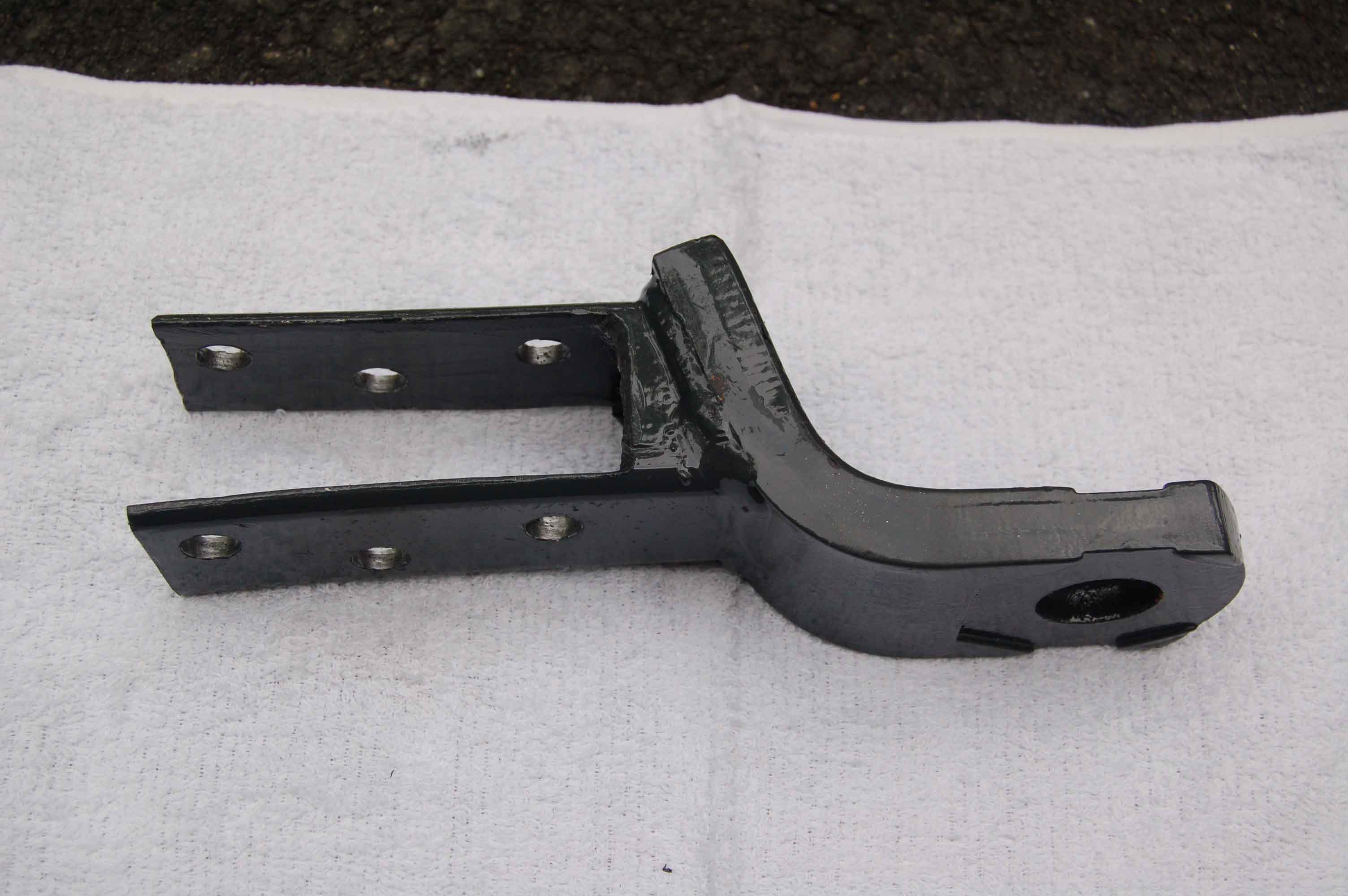

   / Anyone mounted a trailer hitch ball on FEL? #12
...because I usually wear my BH.
I forever take my BH on and off in the summer. Usually, though, if I need to move my trailer, I'm doing something that involves my BH. Murphy is a real wiener like that.

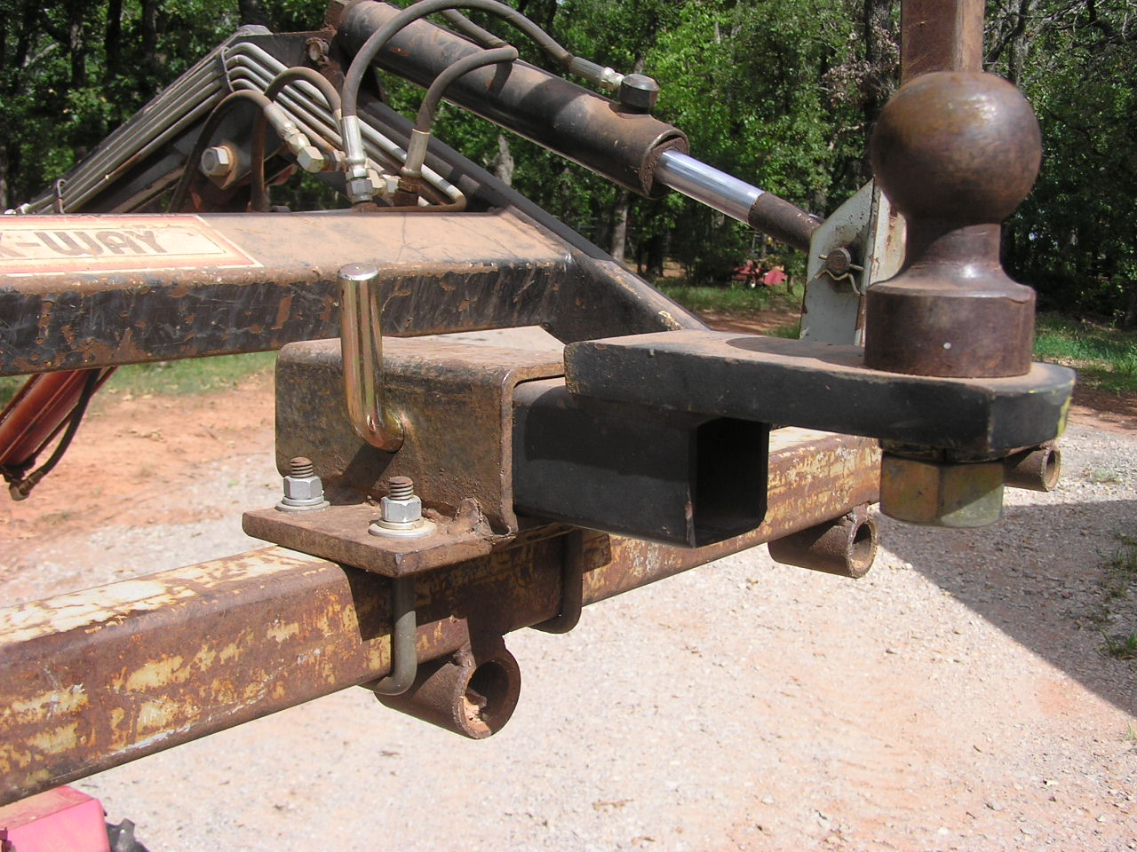

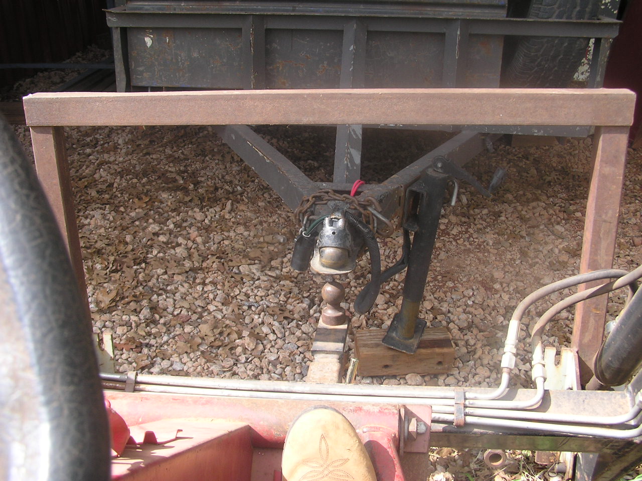

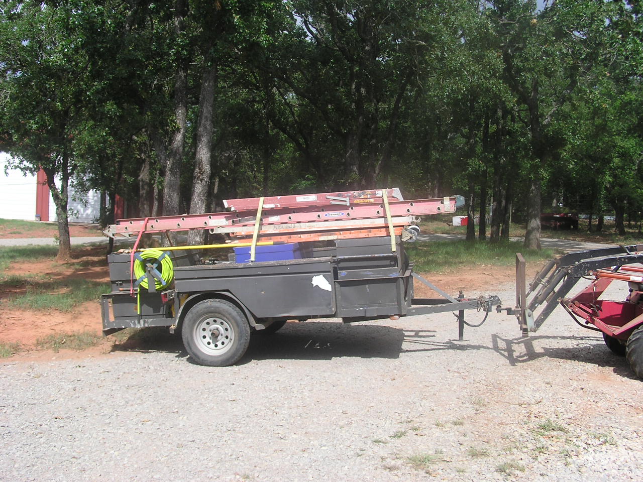

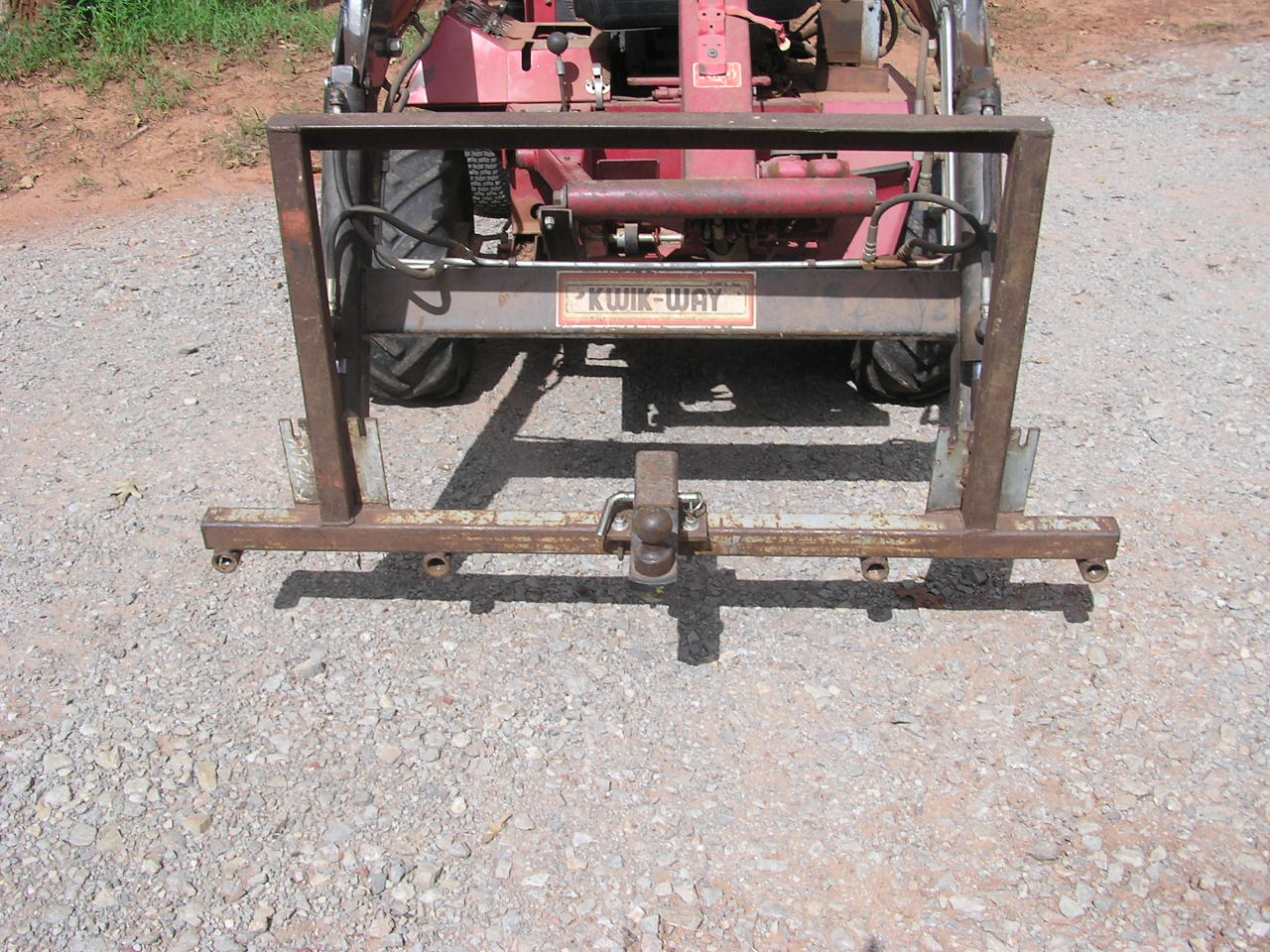

Anyhow, this is how I worked through the dilemma. I like my FEL the way it is and didn't want more holes sprouting out of it. Plus, I've moved a 10k trailer around when loaded with 3,000# of yard waste...you start reaching the limits of the FEL very quickly.
The arragement I have pictured has worked pretty well. Not a perfect solution, but there really isn't one to meet all needs. This allows me to work with the trailer and BH, which is what I wanted. When I get serious about towing my trailer (Halloween hay rides and the like), I take the safer approach of my dedicated Leinbach Line 3PH 2" reciever used in tandem with my weight distributing hitch. Of course, the BH comes off for that to be used.
The trailer pictured is my old single-axle 3,500# capacity trailer. I now run a 8'x20' 10k capacity dual-axle dovetail and pull it without any problem, even moderately loaded.
Hope this gives you another idea.

I just bought a 16' tamdem trailer to haul my BX-22. I want to move it around my place with the tractor - - anyone mounted a ball to your FEL?
I've attached a photo of the trailer. It's a Lone Wolf Trailer. No electric brakes, but I'm not planning on any major hauling.

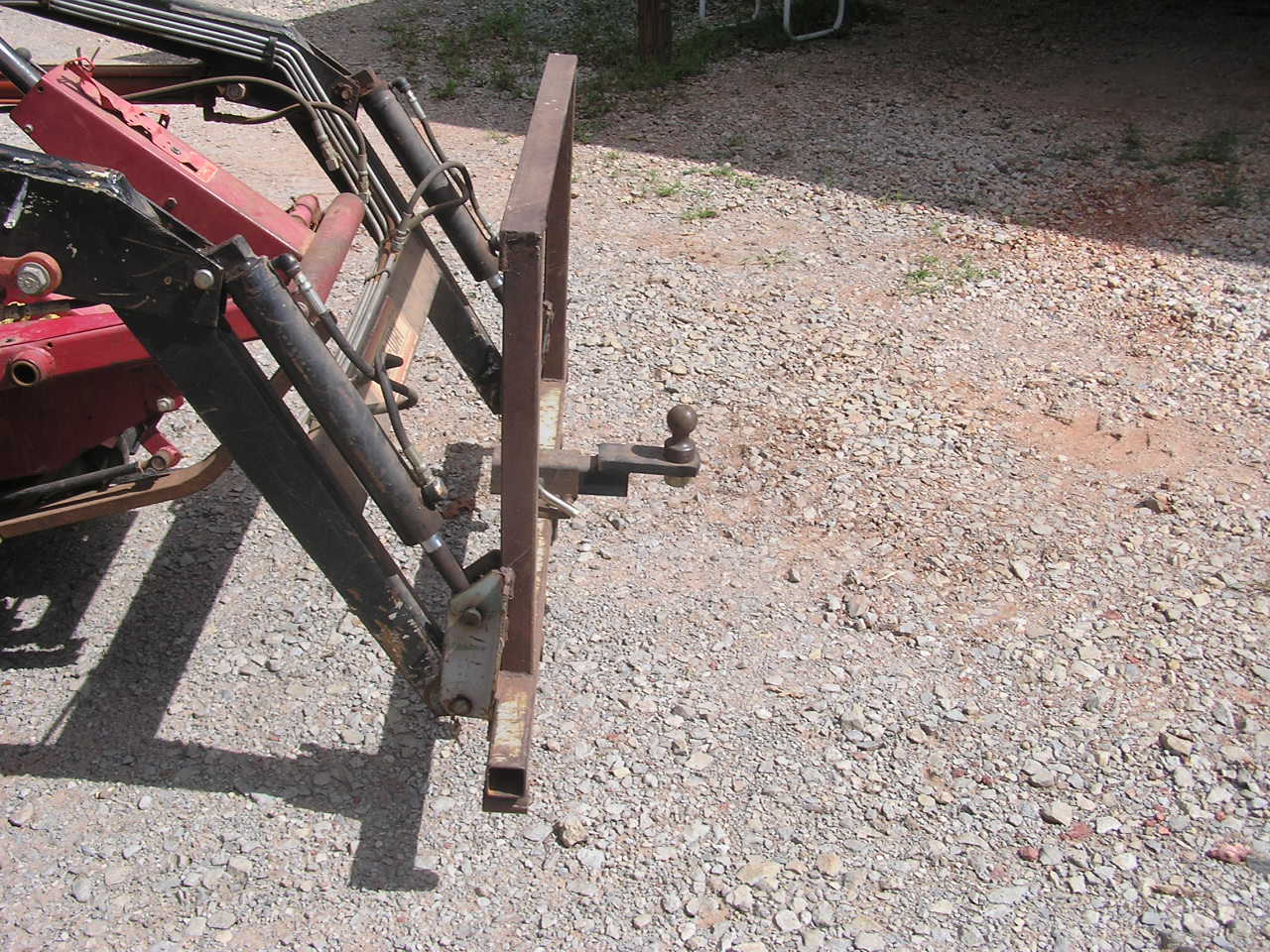

Nice looking trailer!
I bought a hitch for a bumper and mounted in on top of my bucket, and i can use a boom pole with it also.
I took a few pictures,
One of the pictures shows a extension hitch i made for my truck, when i haul a slide-in-camper and pull a boat.
I had in hooked up today and with the extension hitch i can hook up to a trailer real easy, and the trailer won't hit bucket.

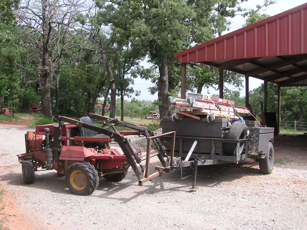

I bought a clamp on receiver a few years ago on ebay. Not too badly built for the cost of it.
Today I decided to work on my still very amateur welding skills and stabilize the sideways motion that happens to the receiver when cranking a trailer around a little hard or pushing through some resistance like snow.
I'm a beginning welder. Only on about 3rd time with new Craftsman 120 volt wire feed. Gotta learn somehow!
In the first pic you'll see that I drove an angle iron through the already triangle shaped opening and then welded it into place:
In the second pic, I welded a 4 inch "wing" to each side of the first angle iron. These push against the FEL blade and hopefully will remove any twisting.
