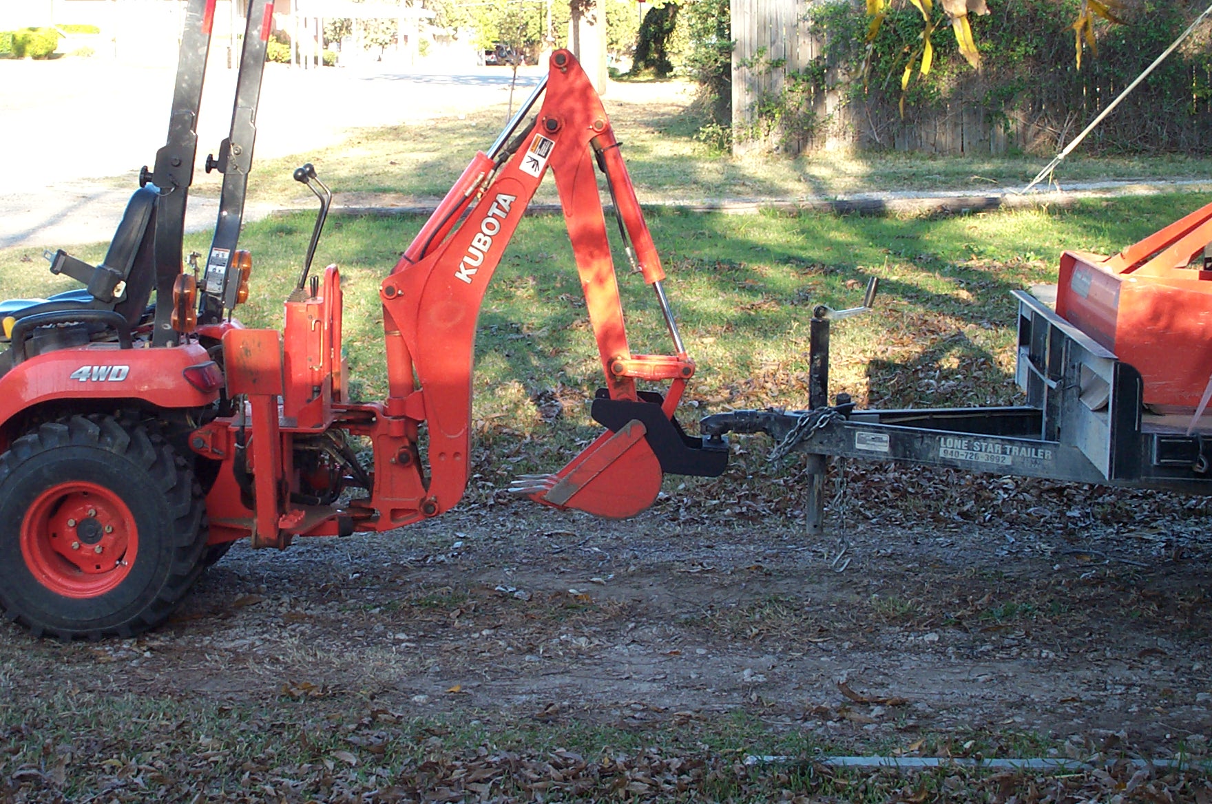

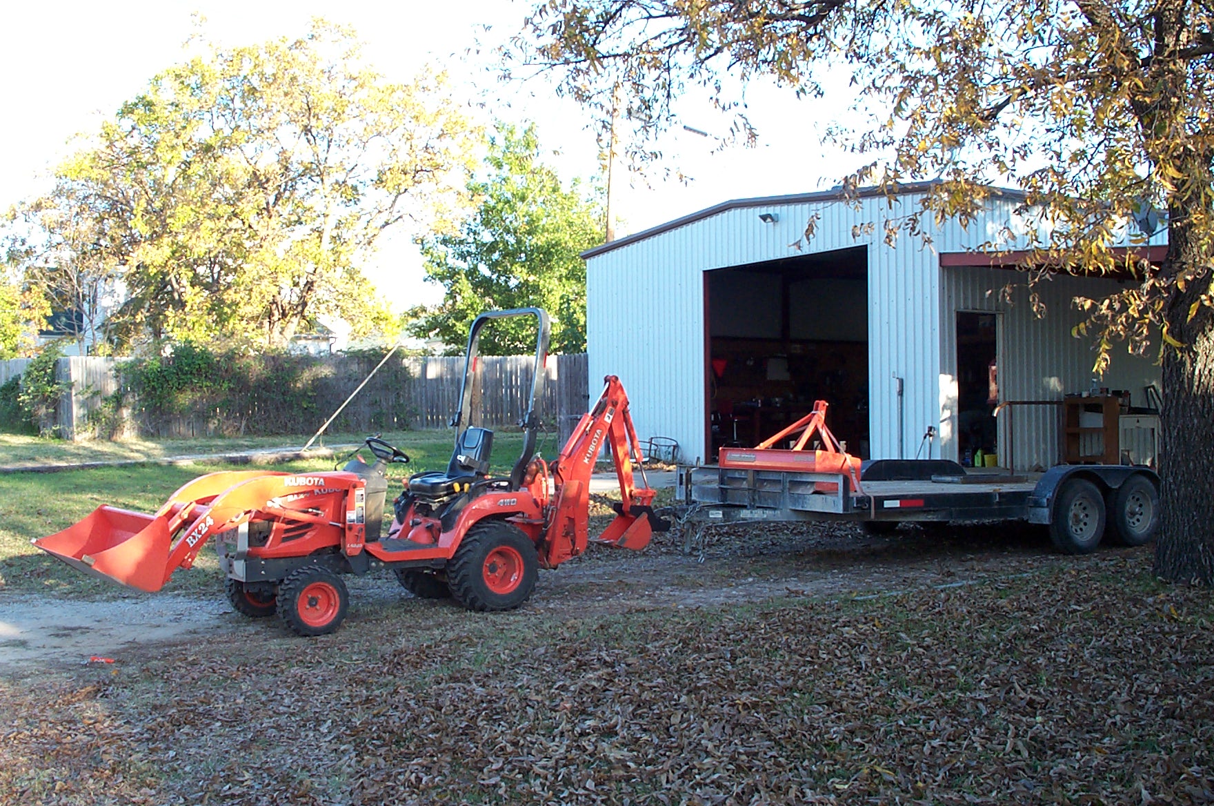

I made an attachment for my backhoe bucket, though I don't use it for towing my trailers, just to move them a short distance when they are in my way. I planned on adding a way to pin it in place, but it doesn't really need pinning for what I use it for. Just drop it onto the bucket, back up to the trailer and away I go. The trailer in the pic is an 18' car hauler and is almost to much tongue weight (with the box blade onboard), gotta be gentle or my front wheels will come off the ground.

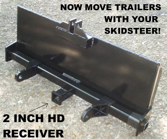

If you have a set of forks, put a ball on the end of the fork, or this
You can also use 3pt stuff on the front of your tractor, if you have the shidsteer setup
