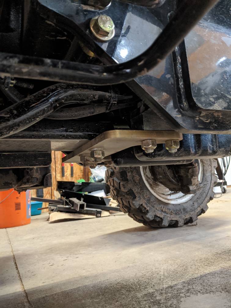

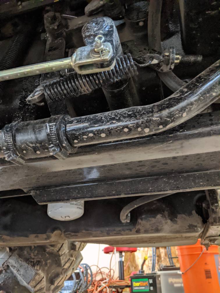

What is the difference in the subframe?
Here are a couple pictures. View attachment 654599 IMG_20200509_111645.jpgIMG_20200509_111636.jpg

The loader on the Boomers is not made by LS and it is a stronger unit than LS sells. They are made by Alo under contract and even though Alo makes aftermarket loaders (Quicke brand), they don't sell the curved-boom Boomer loaders as an aftermarket part. You would have to buy that specific loader from CNH if you wanted it on an LS XR. There are aftermarket loaders and also backhoes for these tractors, my family has a Boomer 50 (LS XR4047) with a Bush Hog brand subframe mount backhoe.
Body parts are also technically specific to CNH as their New Holland division sells the LS XR in a medium blue and a grille that looks like other New Holland products and their CaseIH division sells the LS XR in red and a grille that looks like other CaseIH products. Neither one is the same as an LS XR.
