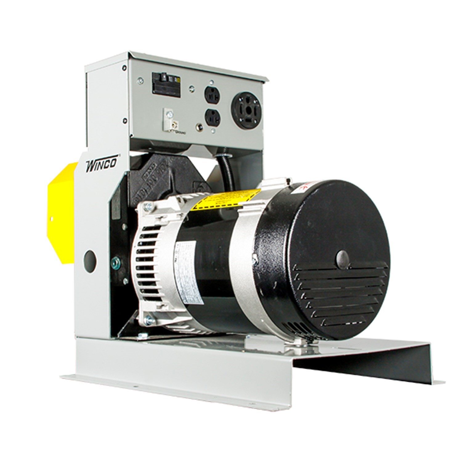

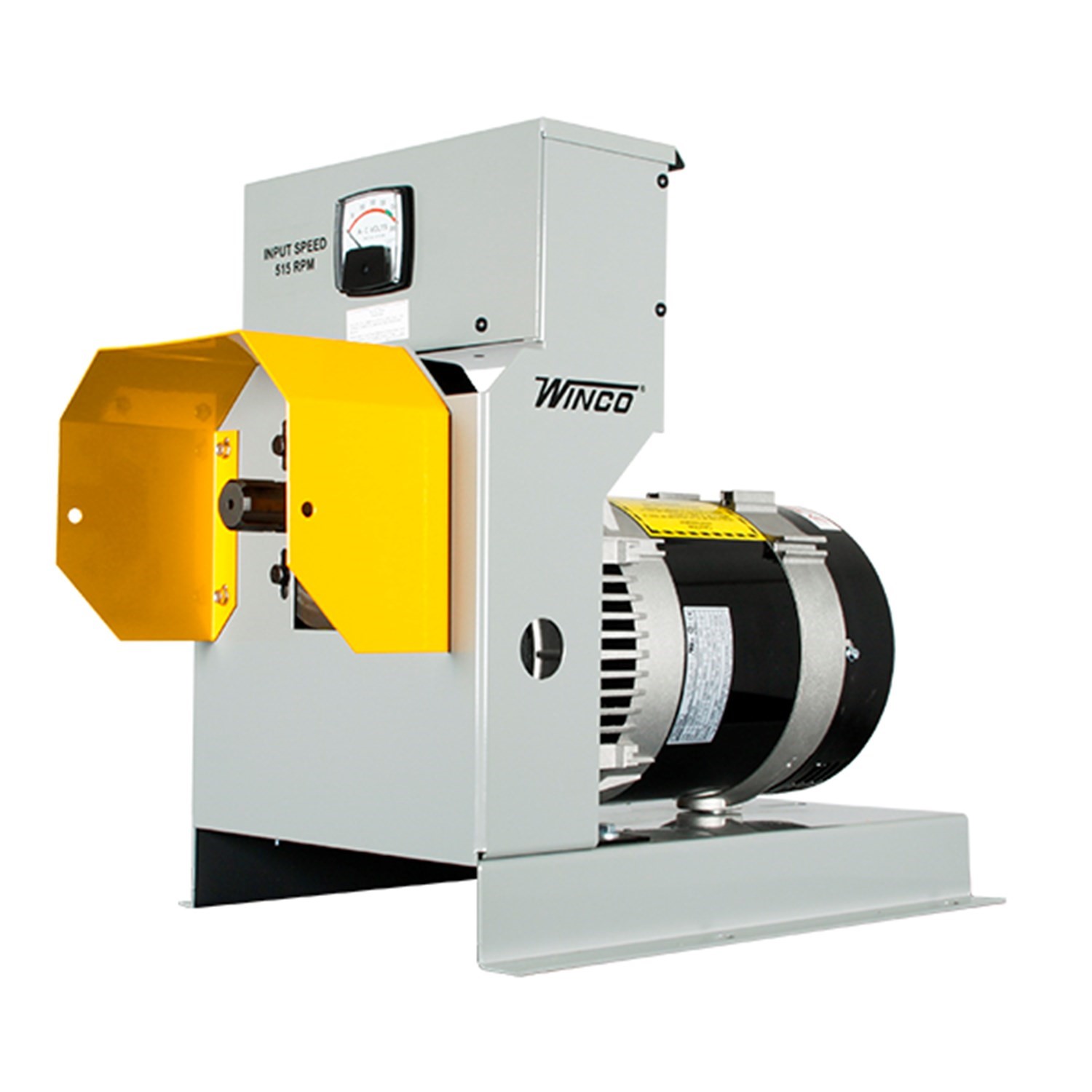

Thinking about getting a Winco 10 kw PTO generator for use during a power outage.
Wonder about continuous running on the G Series PTO rated at 25 horsepower.

X....I thought of the same thing and have been trying to find any info on it. The PTO seemed to run my rotary cutter fine but a generator needs a constant speed. I have yet to read anything on line so far to answer the question....will it work. I hope someone responds....

the generator will put out different frequencies as load is applied, because the tractor don't have an automatic speed control, other than that, it should work fine.. I'd suggest getting a 10KW generator combo instead. it'll keep 60 HZ under load..

You mean the pto speed isn't controlled when loaded, with the engine governor, like all other tractors?

I don't know, that is why I started this thread. Since you can't use the front aux hydraulics at the same time as the hydraulic PTO, I think they use the same pump and it handles the 7' brush hog on the front pretty well.

I'm betting you won't have any problems at all...
It's amazing to me, how many on this site don't know that their tractors have governors!
Some even argue that THEIR tractor can't run a pto gen set, because THEIR tractor doesn't have a governor...

It would be quite inefficient. Firetrucks often use a hydraulic driven Generator. (Often Onan) Don't get so worried about exact speed. Probably nothing in your house cares. Maybe UPSes won't accept something too far out of freq.
An alternative would be to run a three phase generator, make DC and run an inverter. That's how my Onan Quiet Diesel set does it. It would also allow you to run slower rpms depending on load.

The nice feature the 5610 has is the digital PTO rpm reading on the dash. As you use the PTO, you get a direct reading on the rpm it is running.

25 Hp = 18.65kW, so it should have more than enough power to turn generator at full load and hold rpms/freq.

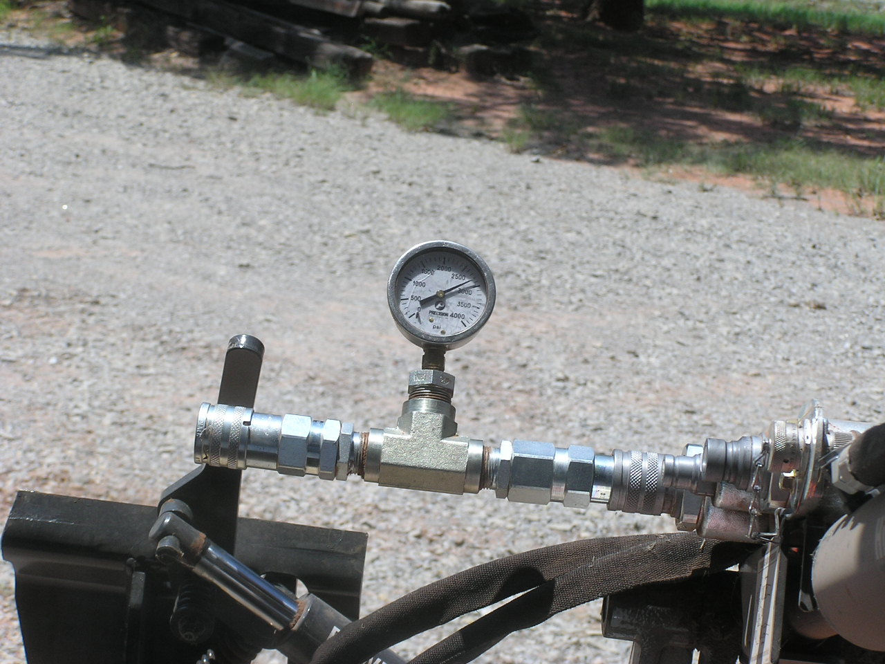

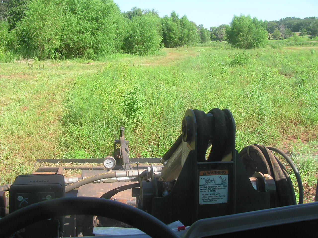

I can also monitor the pressure from the pump while mowing with the SSQA brush hog:
