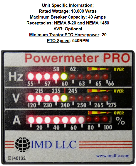

PTO variation when the electric load increases would cause the voltage and frequency to go lower. The Kill-O-Watt doesn't prevent or correct that.
My question is how much does the hydraulic PTO vary with a changing load? It might be less than a mechanical PTO on a tractor.
Most of the PTO generators have a built in monitor:
   / Anyone run a generator on the Toolcat 5610 hydraulic PTO? #15
Sure, the Kill-A-Watt doesn't correct it. It shows what the magnitude of change is. So, run the play with a suitable attachment and walk it down. My expert guess would be that a hydraulically operated drive shaft would have faster recovery than a fuel control system on an IC engine. This is for several reasons: Hydraulic closed loop feedback systems have short time constants with satisfactory damping factors. They are much less likely to oscillate, too. Secondly, these are fairly new machines where a design team probably has already considered, tested and evaluated the rpm control of the PTO using engineering standards and procedures. My only concern would be cooling capacity of the oil radiator(s) under continuous long term use. PTO generators can be expected to run for many hours at a time with the tractor stationary. This too could be checked by a simple measurement.
