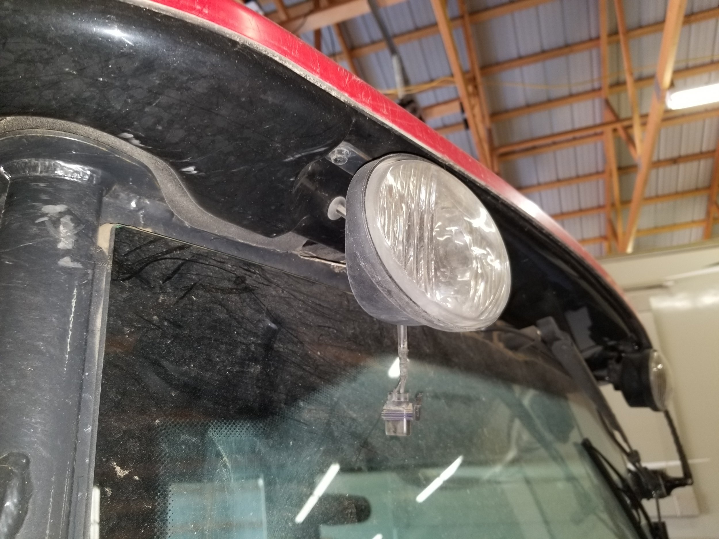

I'm still using the factory installed standard work lights that came on the cabbed Branson's for many years:
I had to replace the bulb in this one after hooking it on a tree limb a couple years ago. I got lucky in that it only managed to yank the bulb out of the housing. It broke the bulb, but the housing and the wiring connection were fine.

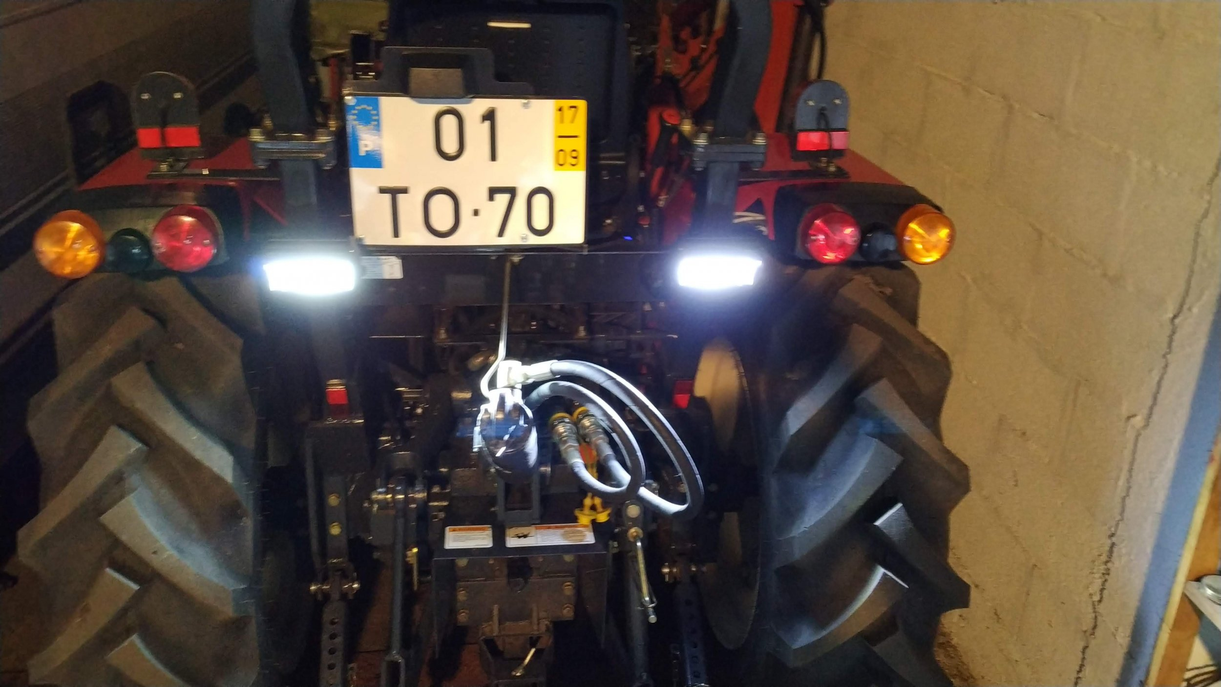

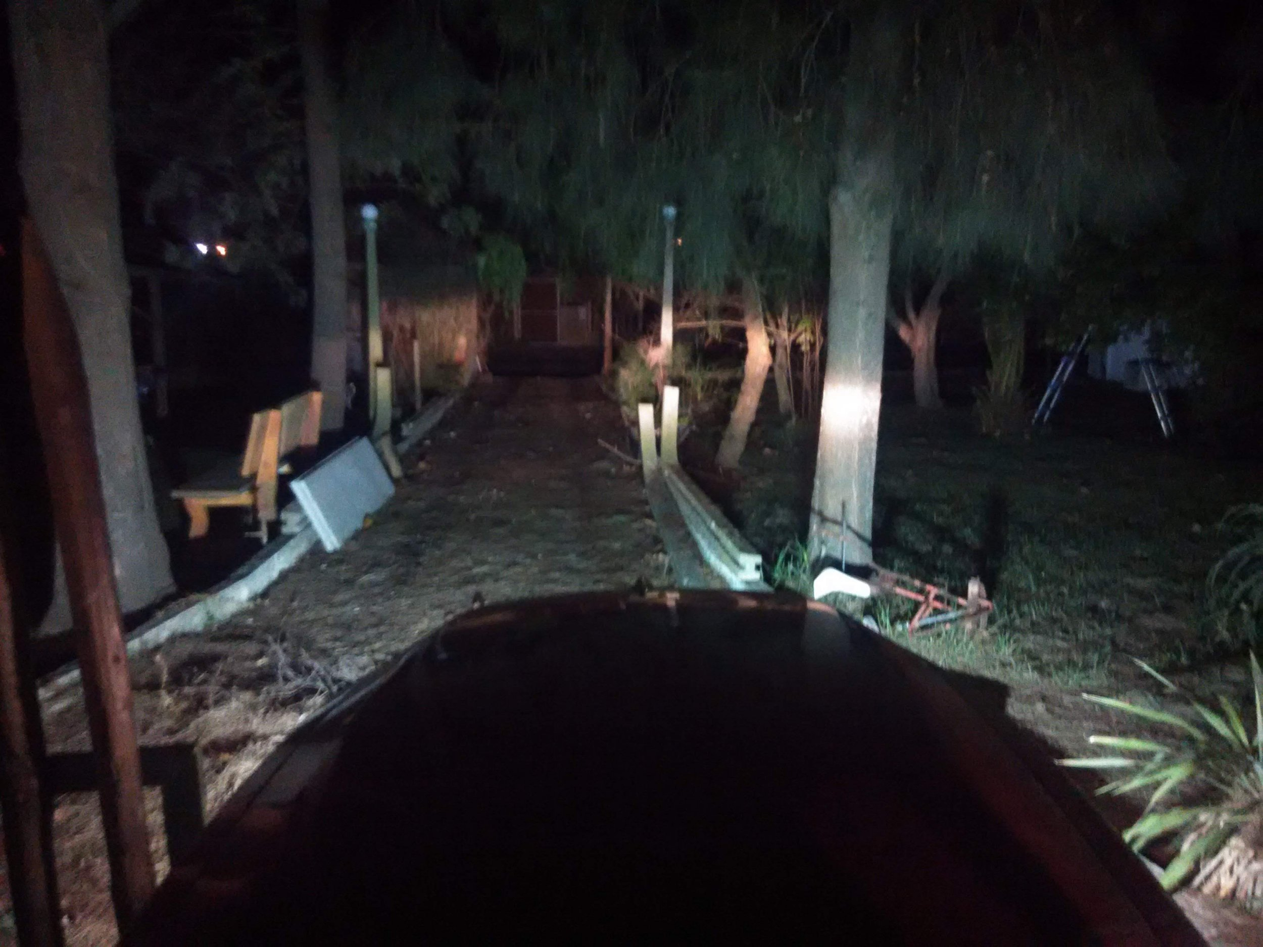

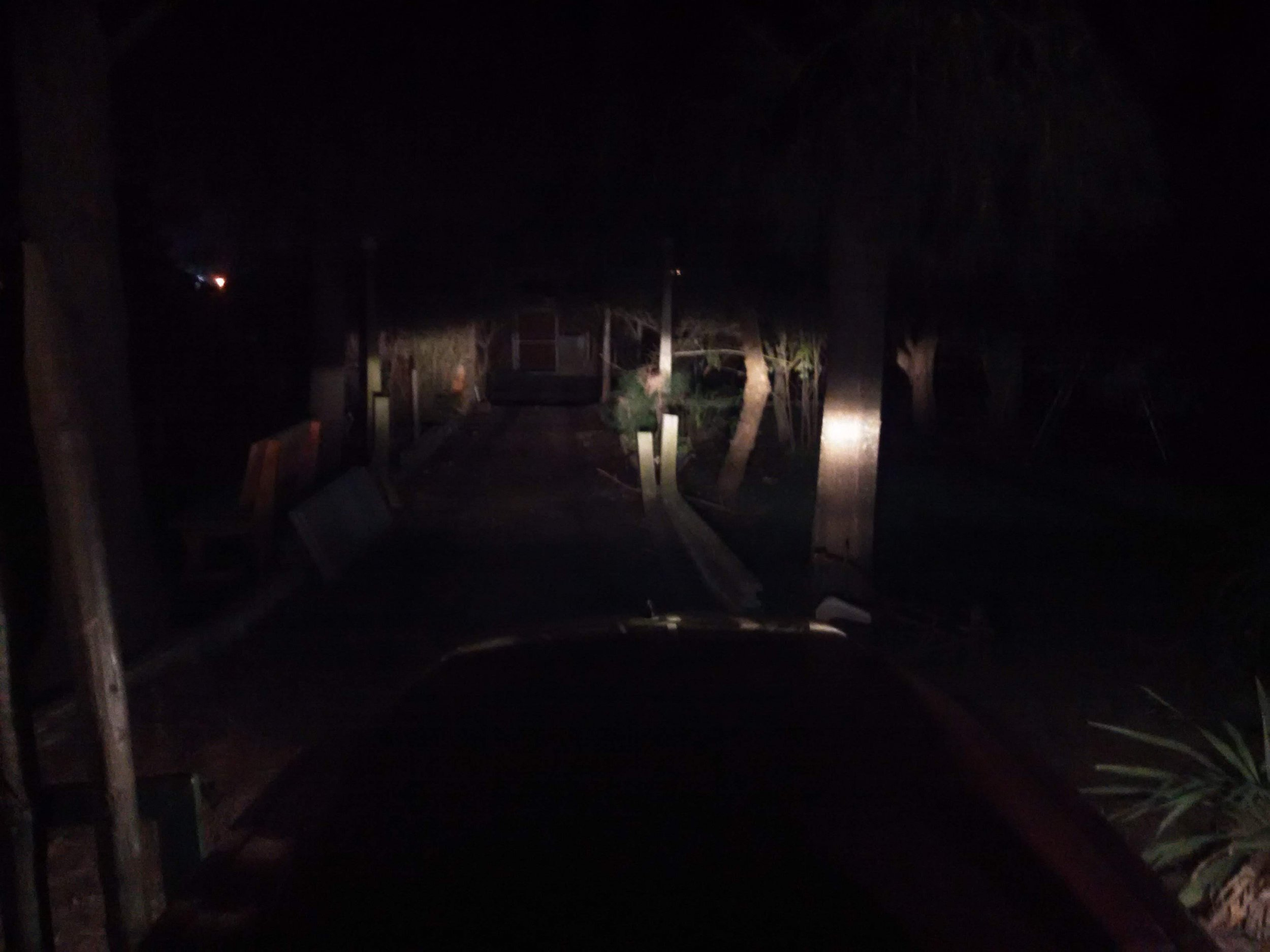

I found CREE leds that fit on same brackets as my original halogen. Also pics showing original lights vs led.
