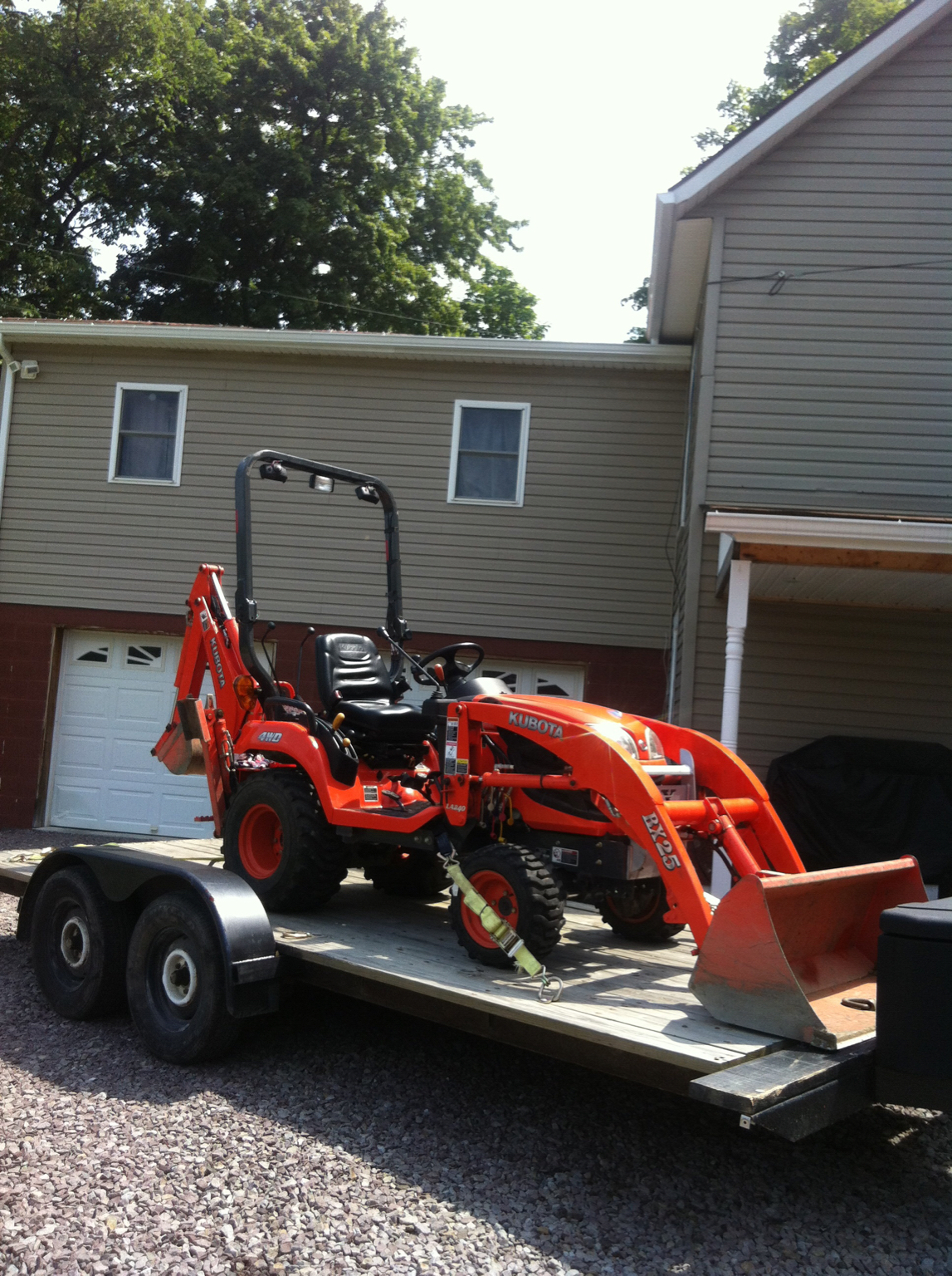

I traded my bx25 in on a BX23s. Overall I'm satisfied with it an all the options I got for it. Planning on adding the cab this summer also. IMG_1020.JPG

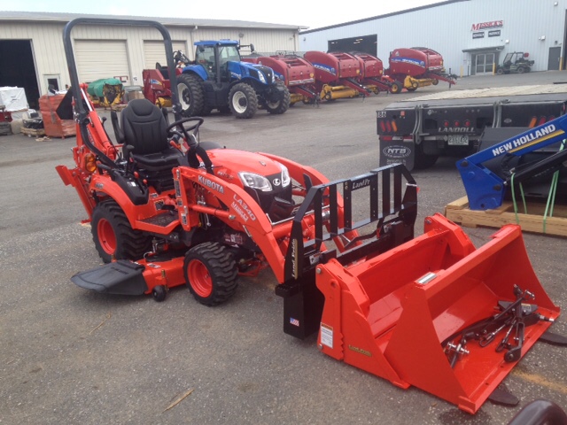

I liked how the loader lever was moved from on the loader of the to fender an the tilt steering. My wife doesn't understand but I had 474hrs on my bx25 an I hated the position of it. As soon as I saw the info on the BX23s on the forums an YouTube I had to have it. My local dealer that I bought my bx25 from only wanted to sell me a bx25D cause they had a bunch they wanted to get rid of to make room for the new ones an told me to wait till end of summer before any good rebates were available for the BX23s. So after I got pretty much the same runaround from another dealer I got mad an called Messicks told them what I wanted an 2 weeks later my new BX23s was ready for pickup with all the accessories that I wanted an they didn't try to sell me something I didn't want. IMG_1699.JPG
