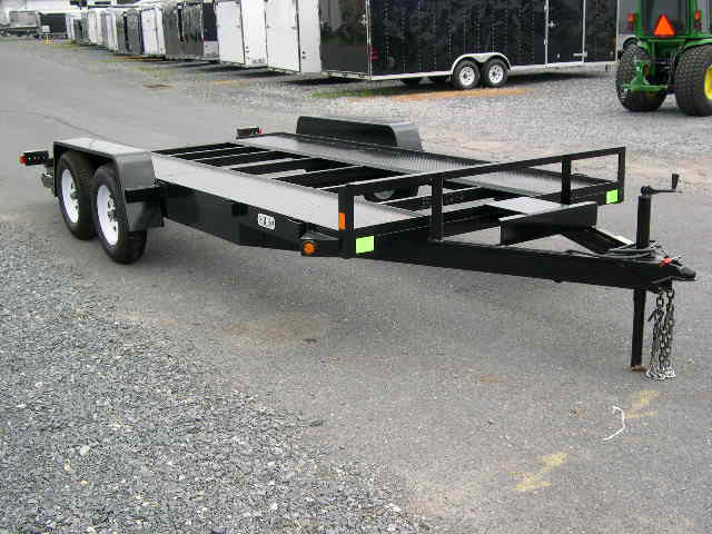

Anyone ever use an open deck car trailer for hauling a tractor? Like this:
This type of trailer is lighter than the wood deck utility trailer and would tow easier with my vehicle.

I hear you S219. Trust me, I don't want to end up in a ditch someplace or on the front page of the newspaper either. I'm actually thinking about trading in the SA35 on a larger Big Tex trailer (tandem) if I can keep the total GVW within the 5000 lb range. If I can't then I'll come up with a Plan B that will work safely.....maybe a Uhaul trailer pulled by a Uhaul truck.

I had deleted my post because I felt like a nag, and that's not my intention, but I think you understand anyway. Definitely take a look at a 7x16 tandem-axle landscaper with heavy-duty gates. That's what I use to tow my B2920 within the 5000#/500# capacity of my vehicle, and it works perfectly (including the FEL and various rear implements). It's also good for many other uses, and has great resale value if I ever decide to sell (I've had at least 4-5 landscapers and grounds crews come up and ask me to tell them if I ever sell).

I think that will make a pretty good load for a FJ. If you only do it a few times a year on take it easy you should be okay. It may not be a bad idea to install a trans temp gauge so you don't get it hot.
