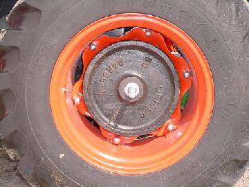

Hi...
Sharp eyes !
Valve stem guard was added by the Kubota dealer... a short length of iron pipe welded to the wheel...
Believe tire had to be removed from that part of rim before welding...
Think the valve stem guards on the front wheels are from factory... they have about 1/4 of the pipe cut out of the side... unlike the full-circle ones on the rears...
Hopefully they will prevent an accident like yours... whch can be pretty expensive if the tires are fluid loaded ! /forums/images/graemlins/shocked.gif

   / Anyone Use Bar Bells as Rear Wheel Weights???????? #33
Mike:
Olympic plates have 1-1/2" diameter holes (new style). Old style have 1" through holes. The nice thing about olympic plates is you can get them in 50 pound increments. Nice for larger tractors like my 5030.
