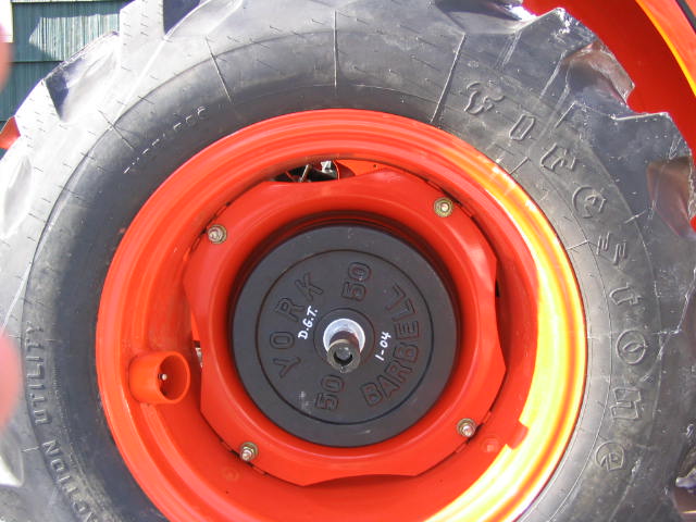

   / Anyone Use Bar Bells as Rear Wheel Weights???????? #25
EZ Weight hardware installed...
Easy enough job...
(3) 50 lb barbell plates on each wheel... room for 1 or 2 more on each wheel...
Photo 1 attached...
Dave...

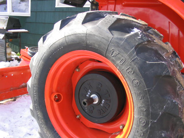

   / Anyone Use Bar Bells as Rear Wheel Weights???????? #26
Photo 2...
Dave...

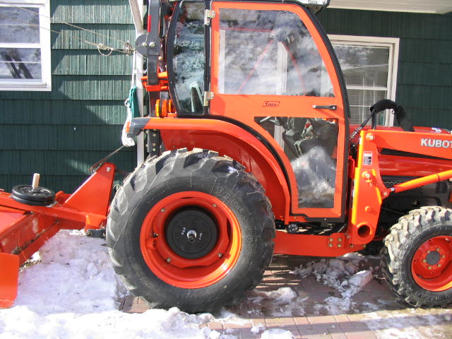

   / Anyone Use Bar Bells as Rear Wheel Weights???????? #27
Photo 3...
Dave...
   / Anyone Use Bar Bells as Rear Wheel Weights???????? #28
I'm trying to figure out your setup.... /forums/images/graemlins/confused.gif
Did you get 2" hole-diameter plate and have to make some sort of filler...?
And I can't figure out what the black pipe is at the end of the threaded part...
Mark

   / Anyone Use Bar Bells as Rear Wheel Weights???????? #30
Hi...
Standard barbell plates with 1+" diameter center hole fit over 1" diameter center rod...
Black " thing" on the end is black rubber pipe insulation fit over the 1" rod as a protection cushion...
Dave...
