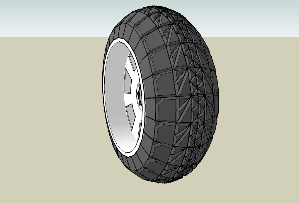

Hey guys, I don't post on here much, but saw this thread. SU is a fun program to work with. It is kinda like the casual Friday of modeling programs. I really recommend the tutorials people put up on youtube.
Here is one of my fav models I made.... even though there is no practical purpose for it. A design on a motorcycle tire. The wheel, I just drew something up as filler so it is clunky.

that's some great work! i'm still having trouble with round things
i can see doing a, say, 10 degree section of the tire and then copying it....but i'm having a hard time copying....i spend my time drawing the same thing over and over.....
i saw on one tutorial someone copying and duplicating things but i think that was in the expensive version...
i hate that they make it so out of range for the average person...i could easily give $50 for the real thing.........
