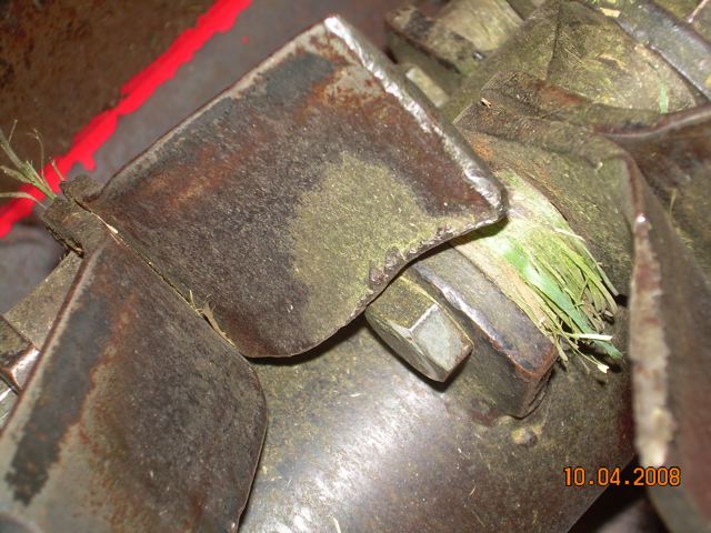

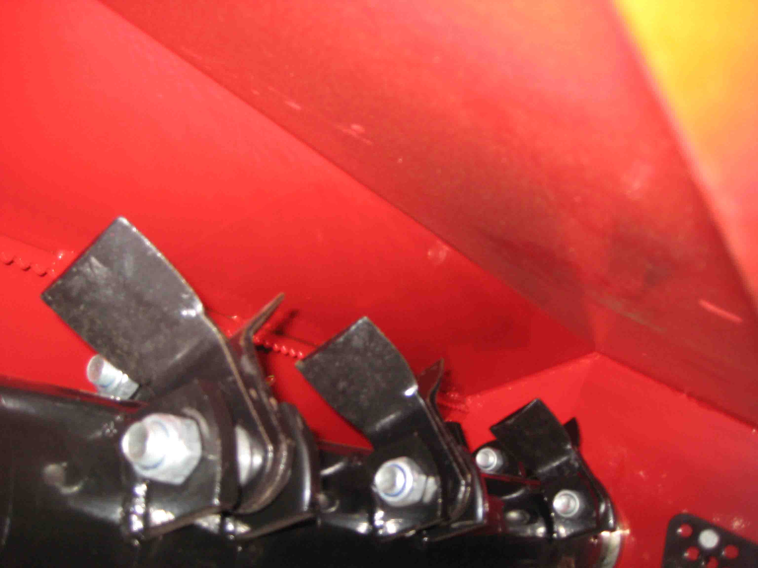

I've had mine for a year now, probably 60 or 70 hours on it. A few of the knives hit the bolt heads on neighboring knives, dinging up the knives. Also I have burned off a couple of belts mowing canary reed grass (probably my fault), the stuff is miserable to mow. Where it really shines is cutting brush, it just makes the stuff disappear :)

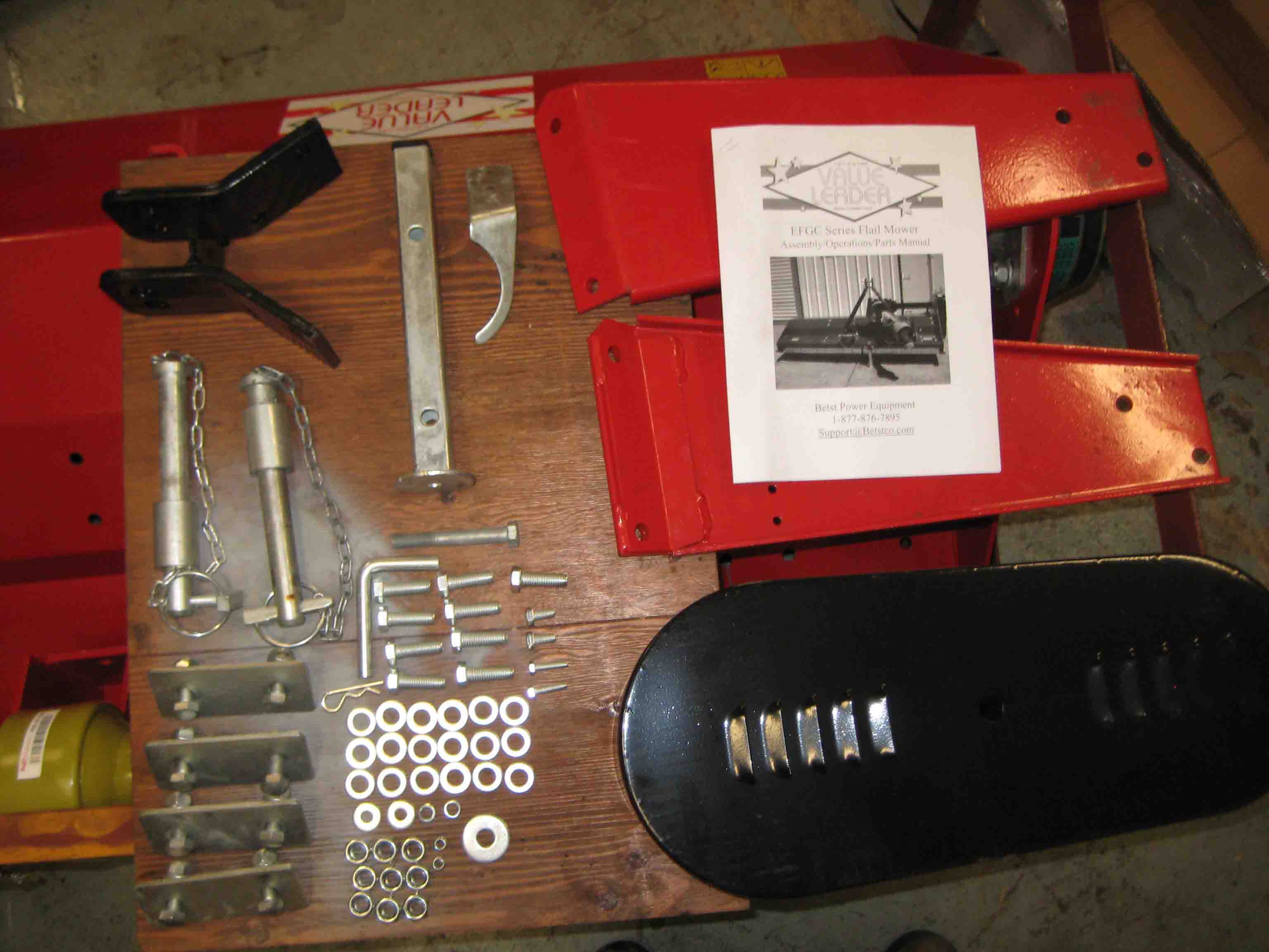

I picked up a used one of these flail mowers over the weekend. Would anyone know where I might be able to get a manual? Maybe I need to give keith a call.

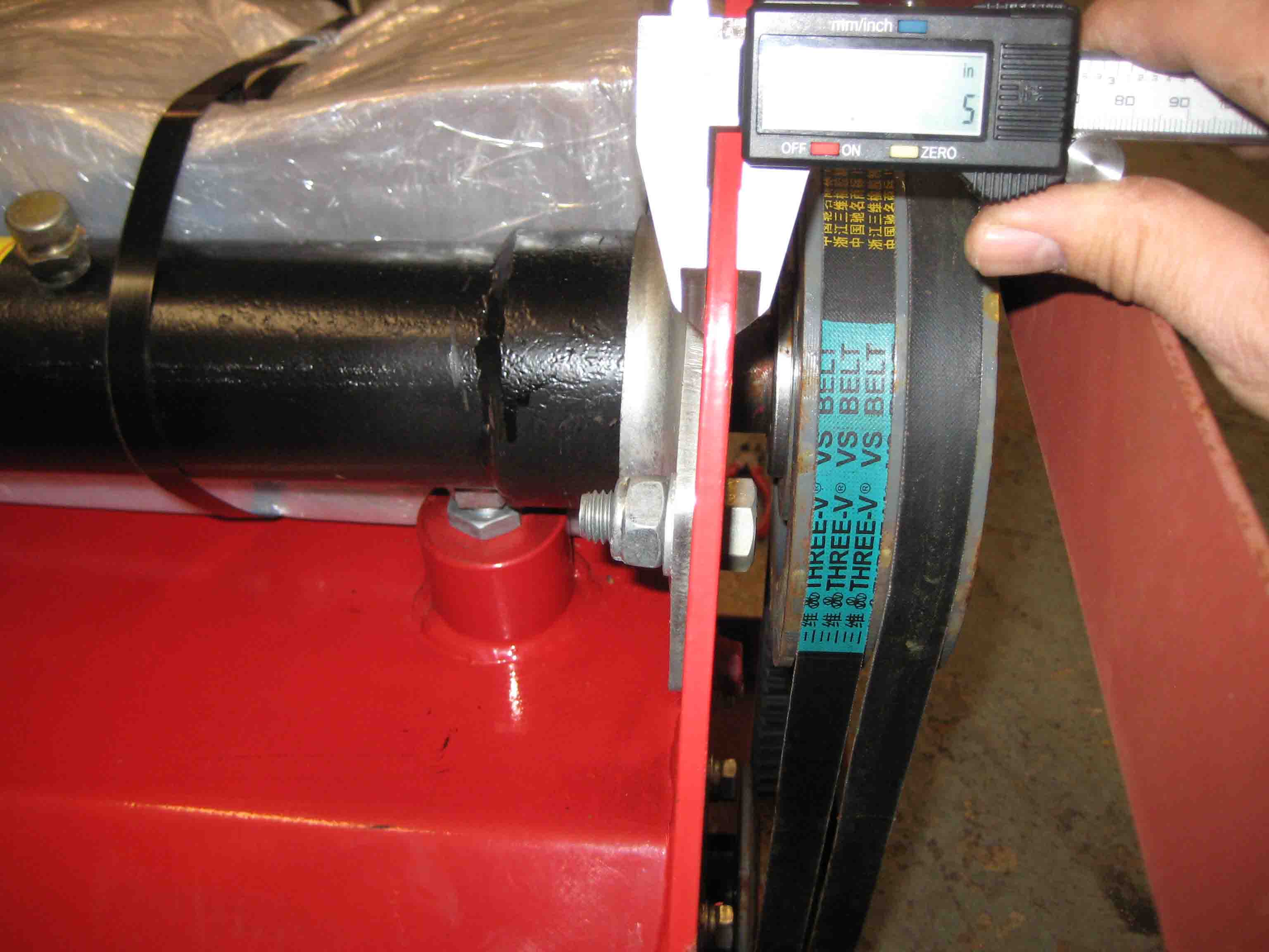

Also, is the one bolt on the belt cover the only thing holding the cover on? I would like to take a look at the belts and see what kind of shape they are in and also get the size so I can get some spares incase I break one.

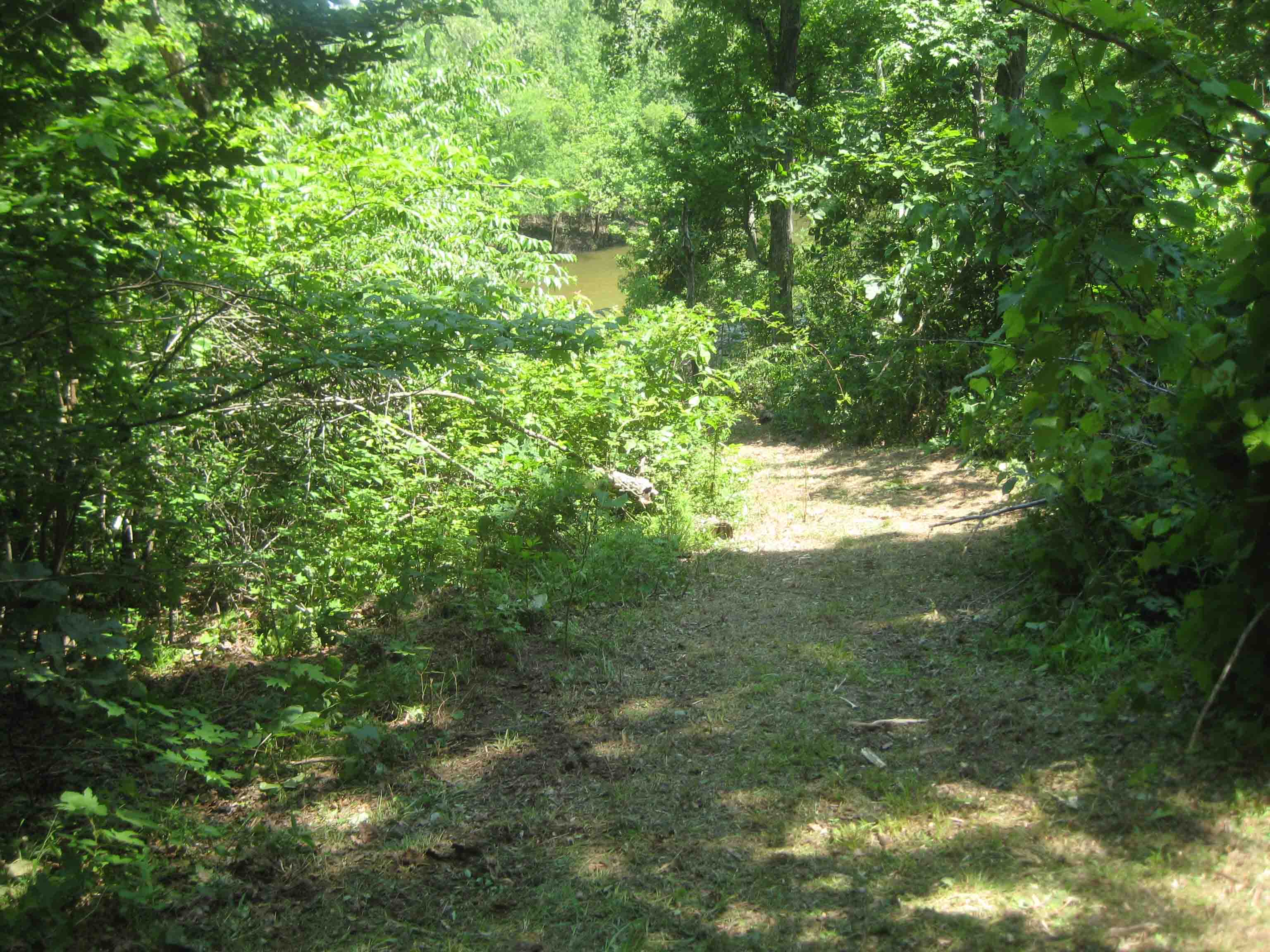

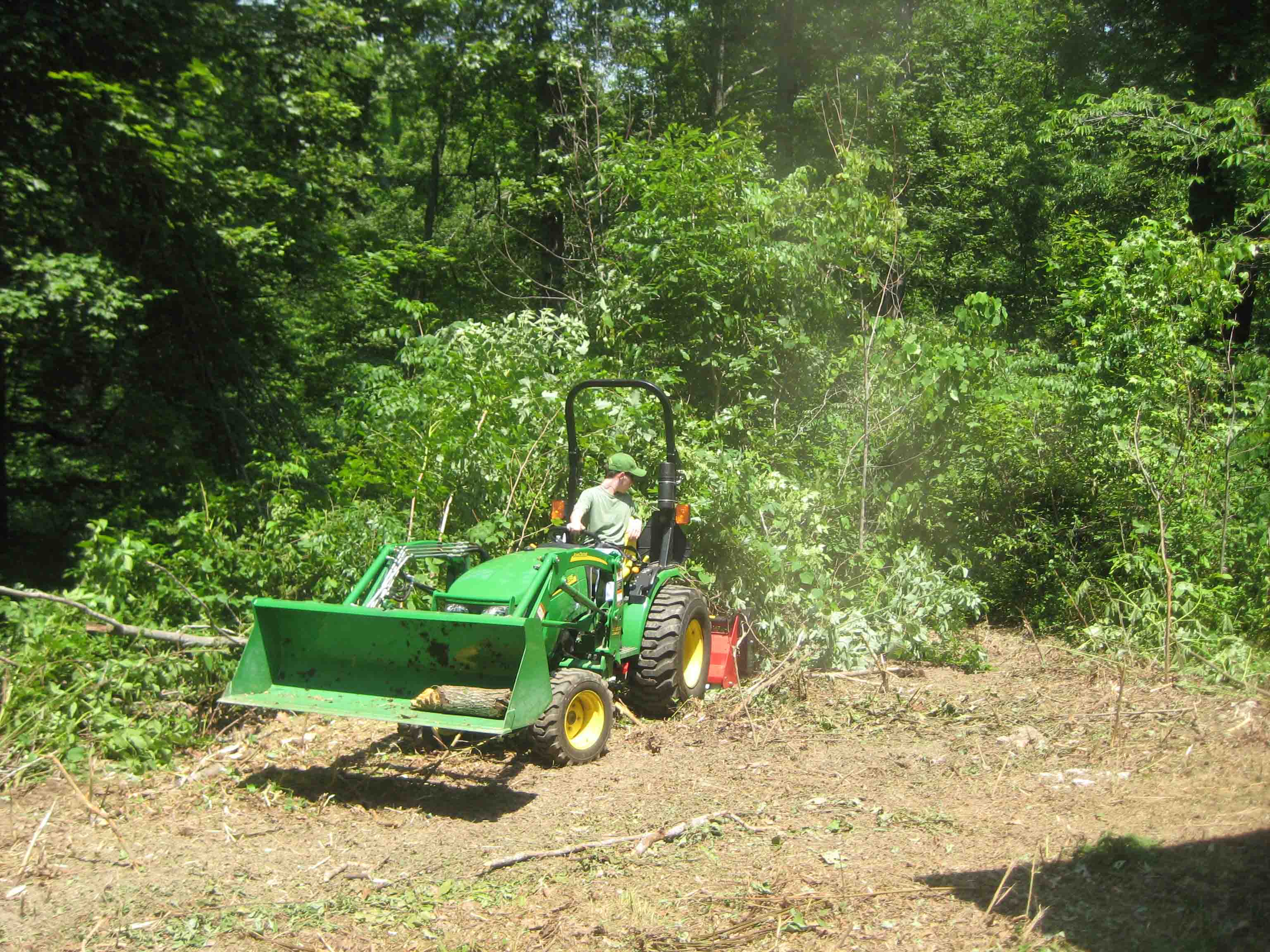

I recently purchased the heavy duty (EFGC) 4 ft version of this mower and had a chance to use it. I am very happy with the results. I've included picture (I hope) to show a bit of what this mower can do attached to my 2520. The pic where you see my son mowing shows the height of the weed (background) and the results ater the cut in the foreground.
This thing currently has grass blades and they seem to mulch things up pretty nicely. I still plan to get the hammer blades since we have plenty of small trees to run through. Well that's it for now. Thanks to all fr the great information that you provide. -kybound

I have used mine for several years now with no problems.. Just always make sure the belts are tight before a long day of mowing.. I keep extra belts in the in the shop after burning up a few
My blades are doing the same thing but only on two sets of bolts. but the blade is cutting the lock nut almost in two were yours only the blade is beeing worn.

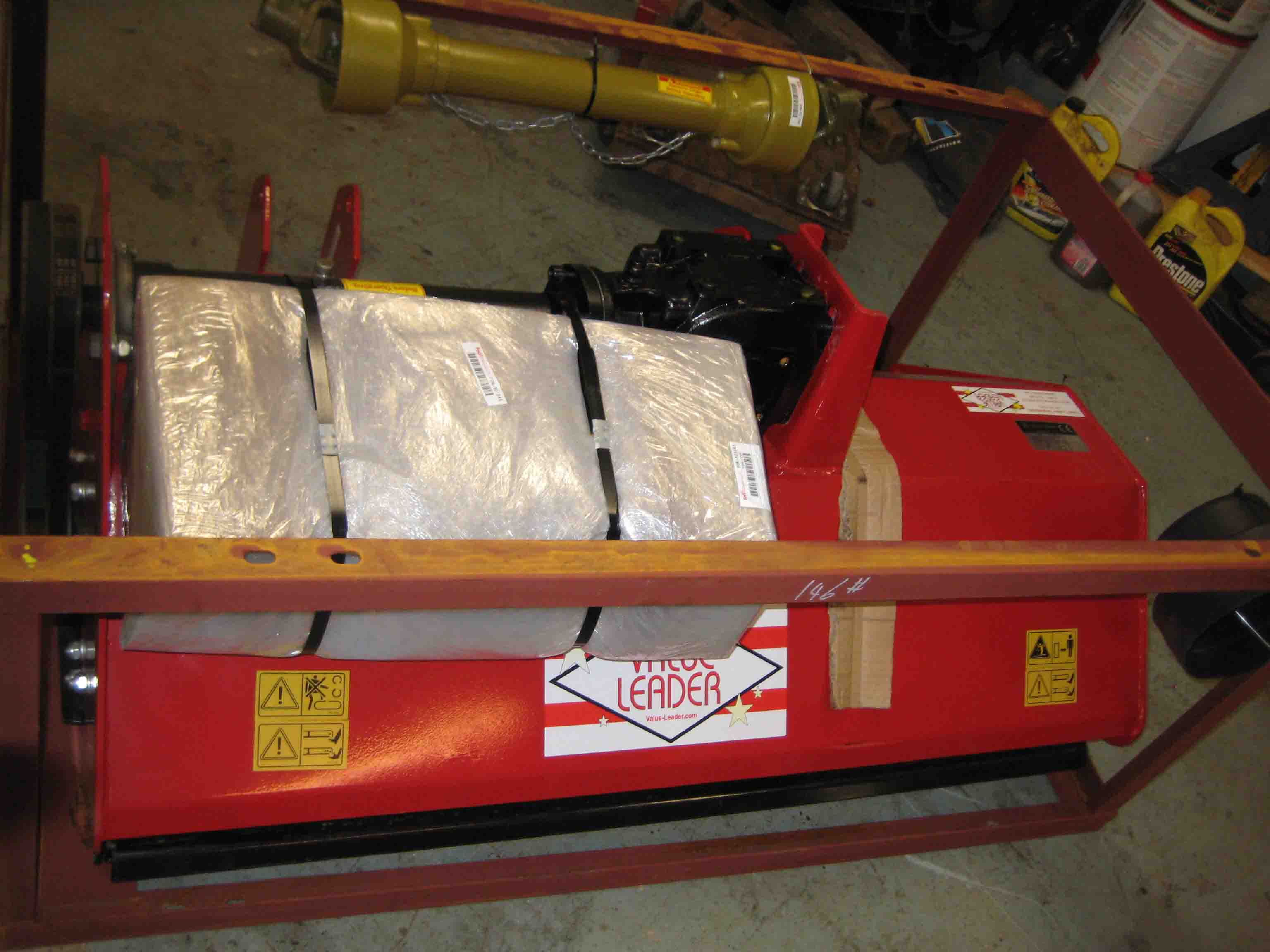

I recently bought a EFGC, 5' flail mower and use it on my B2920. I was a little concerned with the weight of the mower (730lbs) but the 2920 handles it without a problem. The mower seems well made. I live close enough to Betstco that I was able to pick it up myself. Keith had it all assembled, oil included.
So far I've used it to cut 6 acres of 4 to 6 foot tall brush and few large patches of black berries, it did a better job then my 4' brush hog. I did end up with several rooster tails on each pass though, I assume my speed had something to do with that. I plan on mowing the area a second time around the end of October.
