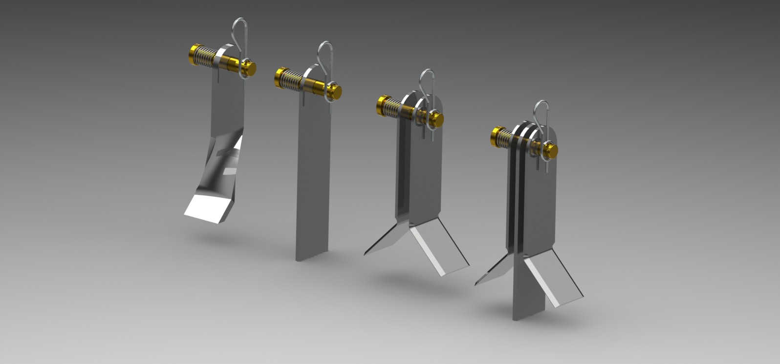

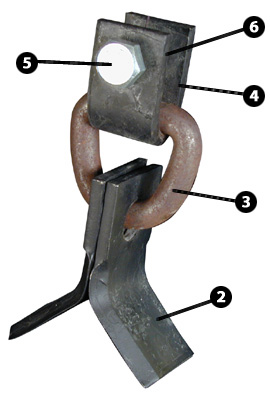

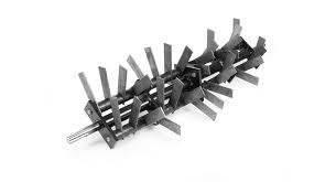

I have a 72 flail mower that I use on my 1445.
It can be rough cut or fine cut or slice the ground.
It all depends on the blade type installed.
When I purchased the used flail, it had straight blades for thatch removable.
This is where I purchased the fine cut blades and hangers.
Flail-Master - Mower Replacement Parts, Commercial Riding Mower Parts, Rotary Cutter Parts, Blade grinders, Trimmer Line, Mowing Accessories - Flail Master - Flailmaster -
You might even be able to install hammer blades for extream rough cut, depending on the width of the blades /hammers.
You can even switch rotors to handle large blades.
I believe mine used 88 sets of blades, two blades per hanger.

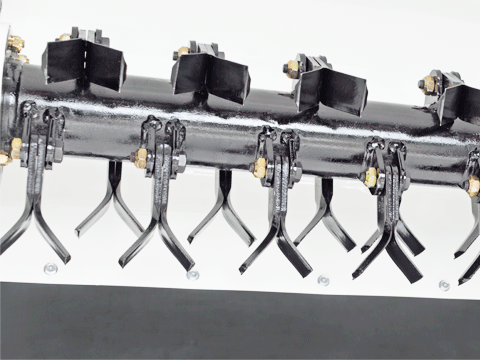

These are fine cut blades.
