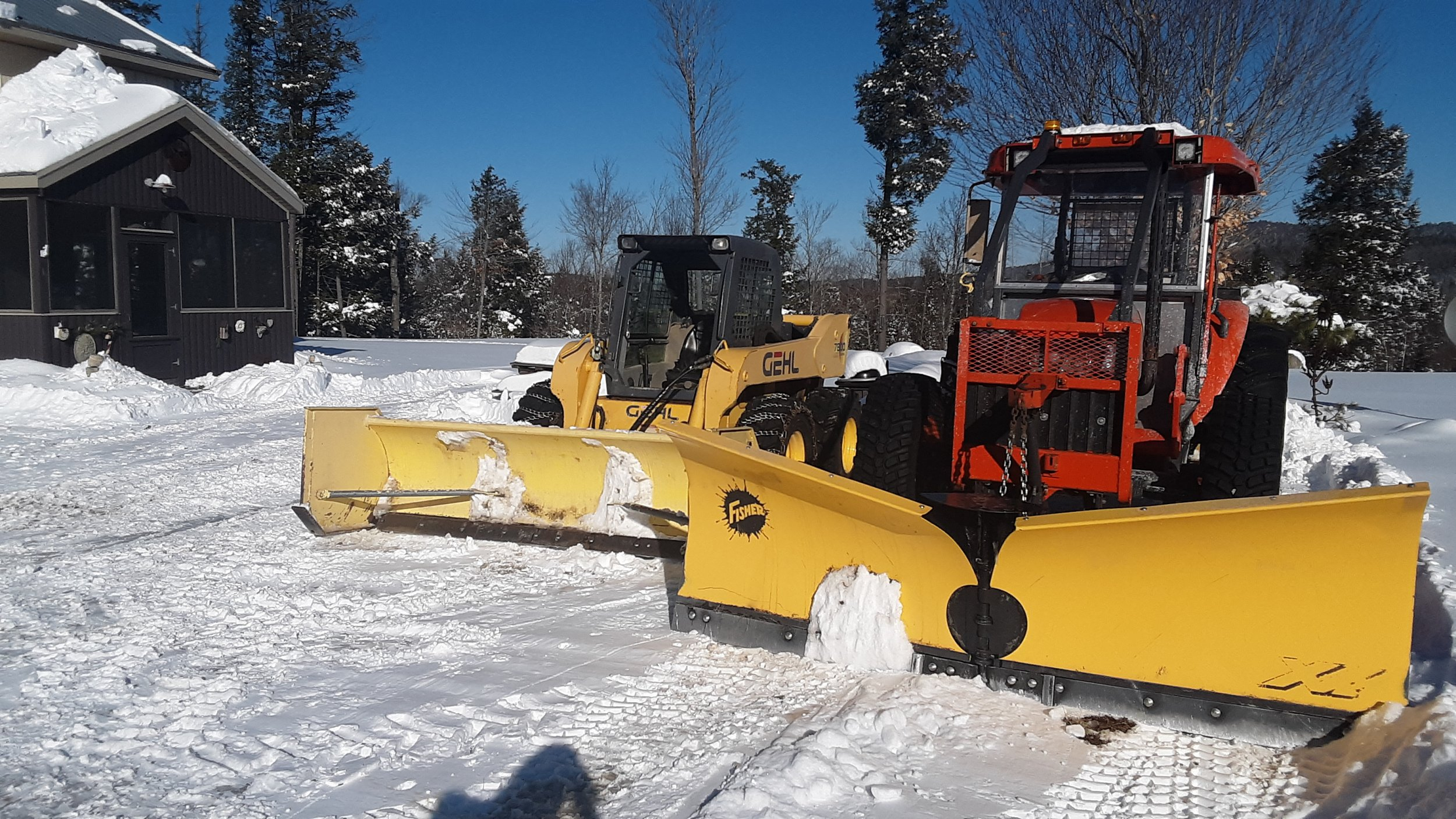

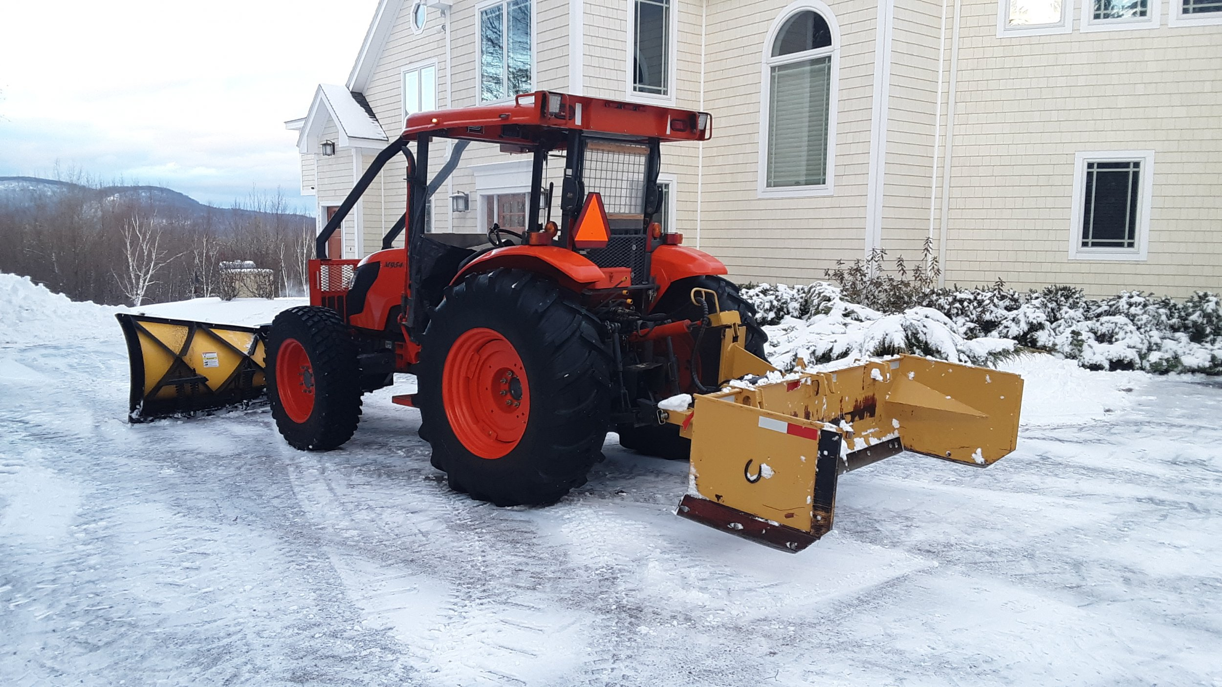

I have the same situation with snow off the roof. For me it always seems to compact itself beyond the nice fluffy pile that I had imagined.
I'll use my pusher making long parallel smaller cuts until it becomes very deep. (3-4')
I usually finish by back dragging (regular bucket) the remainder out to a point a where I can carry it off to it's final destination with the pusher that holds an incredible amount of snow.
So my suggestion is go with a pusher. I think in the long run it's just a much better overall snow mover.

I wouldn't go more than about 20" or so wider than the tractor for the heavy roof drop snow. I have a 8'6" but it's on a 5 ton SS with 110hp. My routine is first "shaving" off what I can, usually with my tractor that has a 9'6" Fisher V blade, then back drag/dig out the rest just far enough away from the building to be able to either use the V plow or the rear pusher (or both, no turning around the tractor)
to carry it off. Sometimes I don't feel like switching bucket/pusher on the SS.
