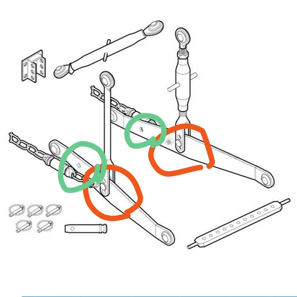

I may have to try that because what I just did does not work. I shortened the top link to make the blower level (inline with the tractor). The scraper blade is one inch off the floor and the feet don’t even touch the floor. In other words, the 3PH is positioned in its lowest dimension and the blower is still in the air. I even checked the drive line (disconnected it from the blower) and removed pins from the check chains. It will not touch the floor.
Do you have multiple places on the lower arms to connect your lift links to? Our Kubotas have that and in your case, I would move them to a lower hole in the lift link (red circle in the image below), or a hole in the lower link that is closer to the rear axle (green circle in the image below).

Aaron, The lower arms are attached at the orange circles, and I do have the holes indicated by green circles. So, I see where that would solve the problem. Thanks.
