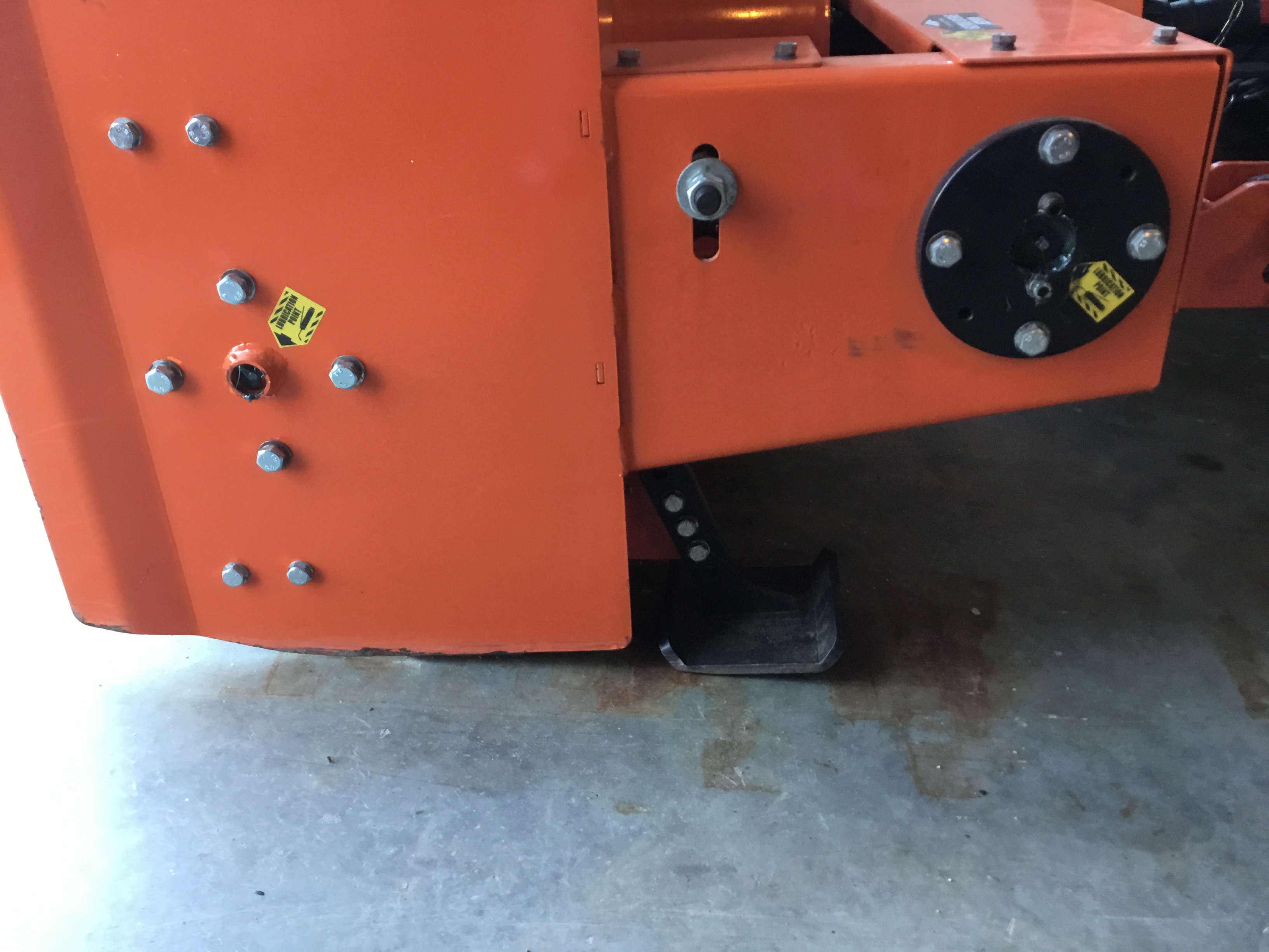

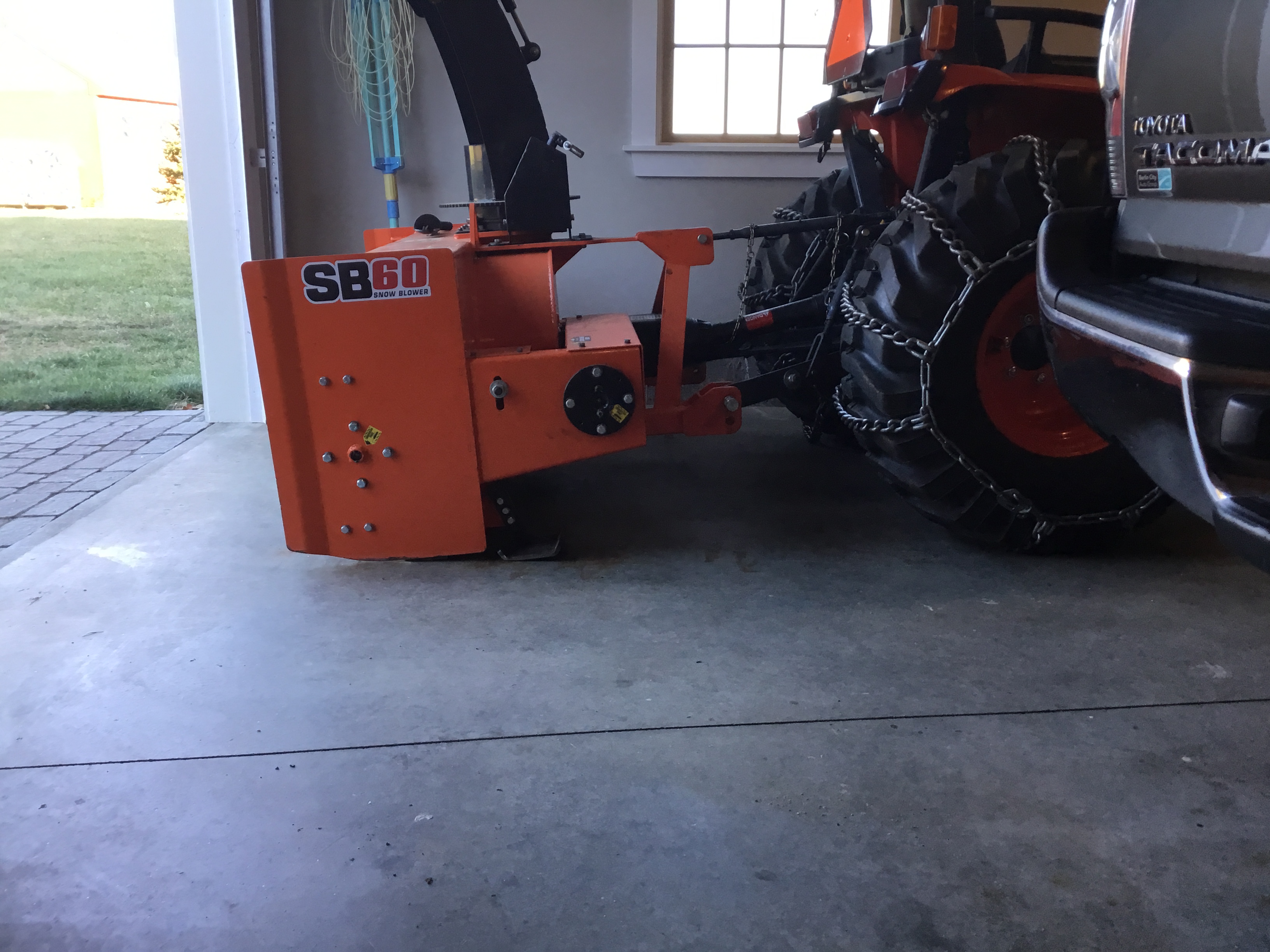

I have an SB60 driven by Kubota B2650. I have fooled with the top link pitch as well as adjusting the skid plates but still can’t seem to get the blower level. The blower should be level, right? Seems to tilt downward (front is higher than the cutting edge side). It works fine but it just bugs me.
/ anyone using a WoodMaxx blower?? #195
Is there more than one attachment point available on the tractor side of your 3 point arms? Can you post a picture of the lower arms where they're pinned to the bottom points on your blower? I seem to recall another poster with same issues, and he was in the wrong pin holes on the blower side.

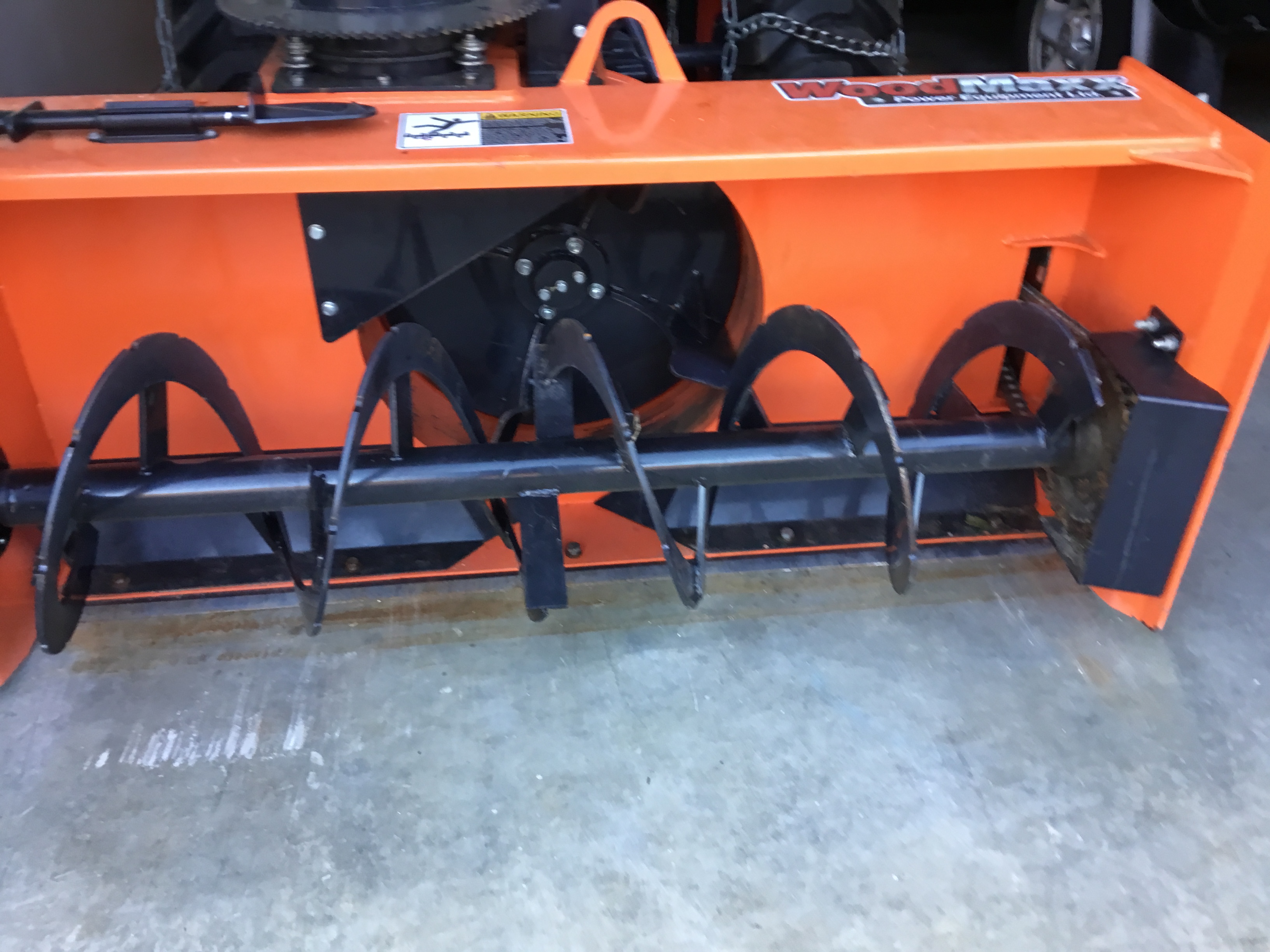

ED0D2C20-1BD7-4475-821A-0502A621CF98.jpeg0A0958A9-7BDD-4F77-AFC3-A489F9C477D3.jpeg0A0958A9-7BDD-4F77-AFC3-A489F9C477D3.jpeg5CD9BE28-53DB-4447-AF77-9EB59AD2D6AB.jpeg
Slim, here are a couple pics. The scrape blade is contacting the level concrete floor. The skid plates are too low and I will raise them. The side arms are in the upper position of the blower.

On the blower side, not sure if the top pin hole on the lower link pins is where you want to be. I'm thinking at least lower your lower link arms as far as they can go, and maybe go to the bottom hole where you pin to the blower, and try that.
/ anyone using a WoodMaxx blower?? #200
I may have to try that because what I just did does not work. I shortened the top link to make the blower level (inline with the tractor). The scraper blade is one inch off the floor and the feet don’t even touch the floor. In other words, the 3PH is positioned in its lowest dimension and the blower is still in the air. I even checked the drive line (disconnected it from the blower) and removed pins from the check chains. It will not touch the floor.
