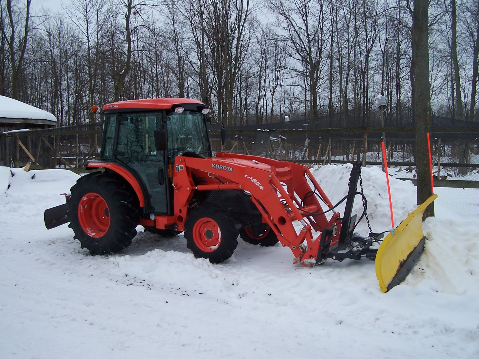

Only way to go IMHO.Here is mine,an 8ft.Curtis truck plow.Use the chain and not a fixed mount.

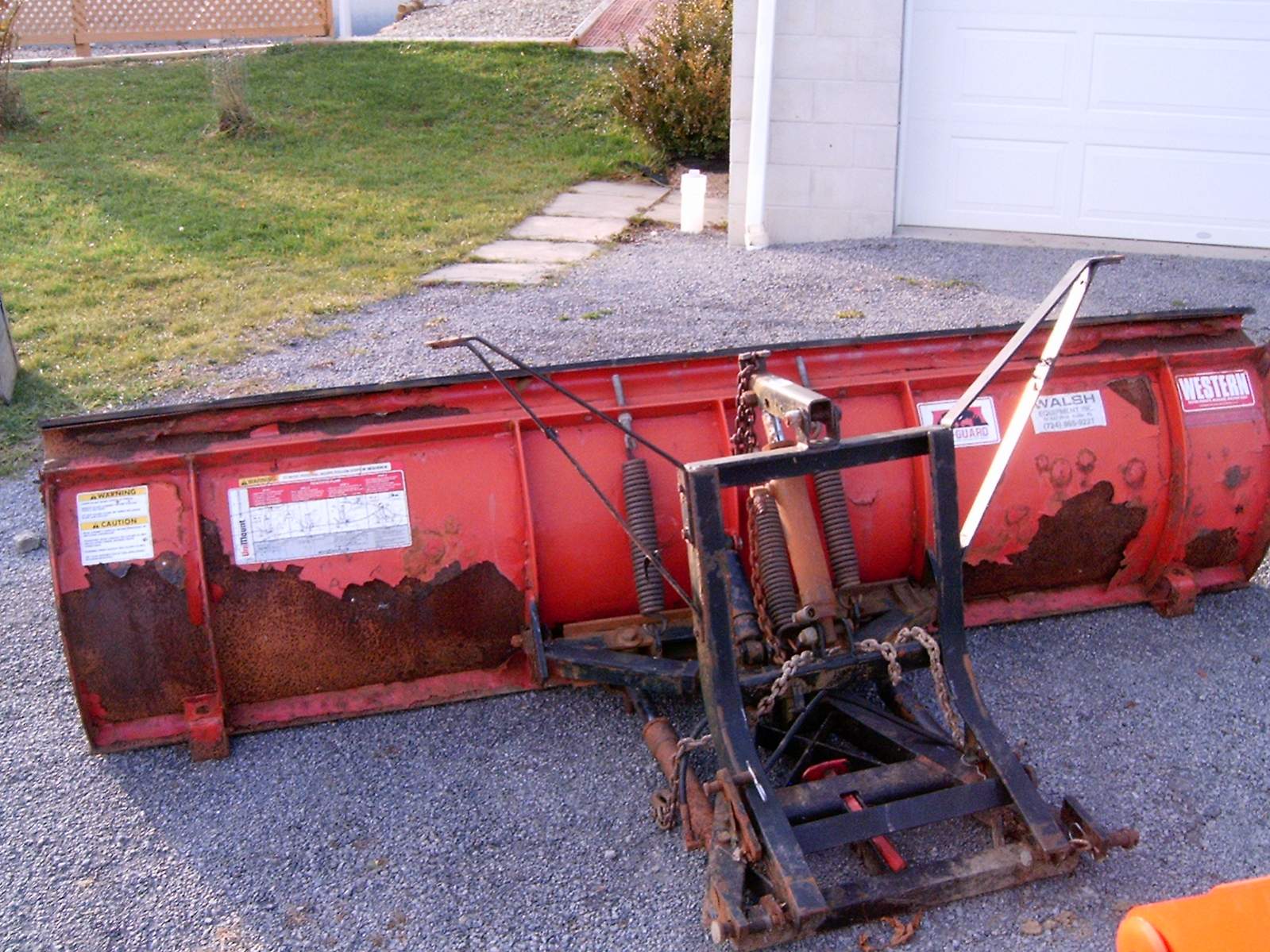

First photo is what I started with. 9' Western truck plow. ($150)
5/16" QA plate was around $130.

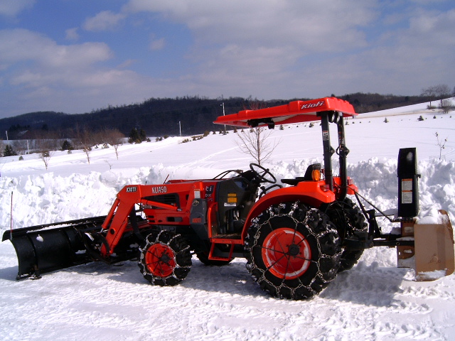

2nd is on the plow and snow blower on the tractor.
Been using this for setup for years now. Works good.
