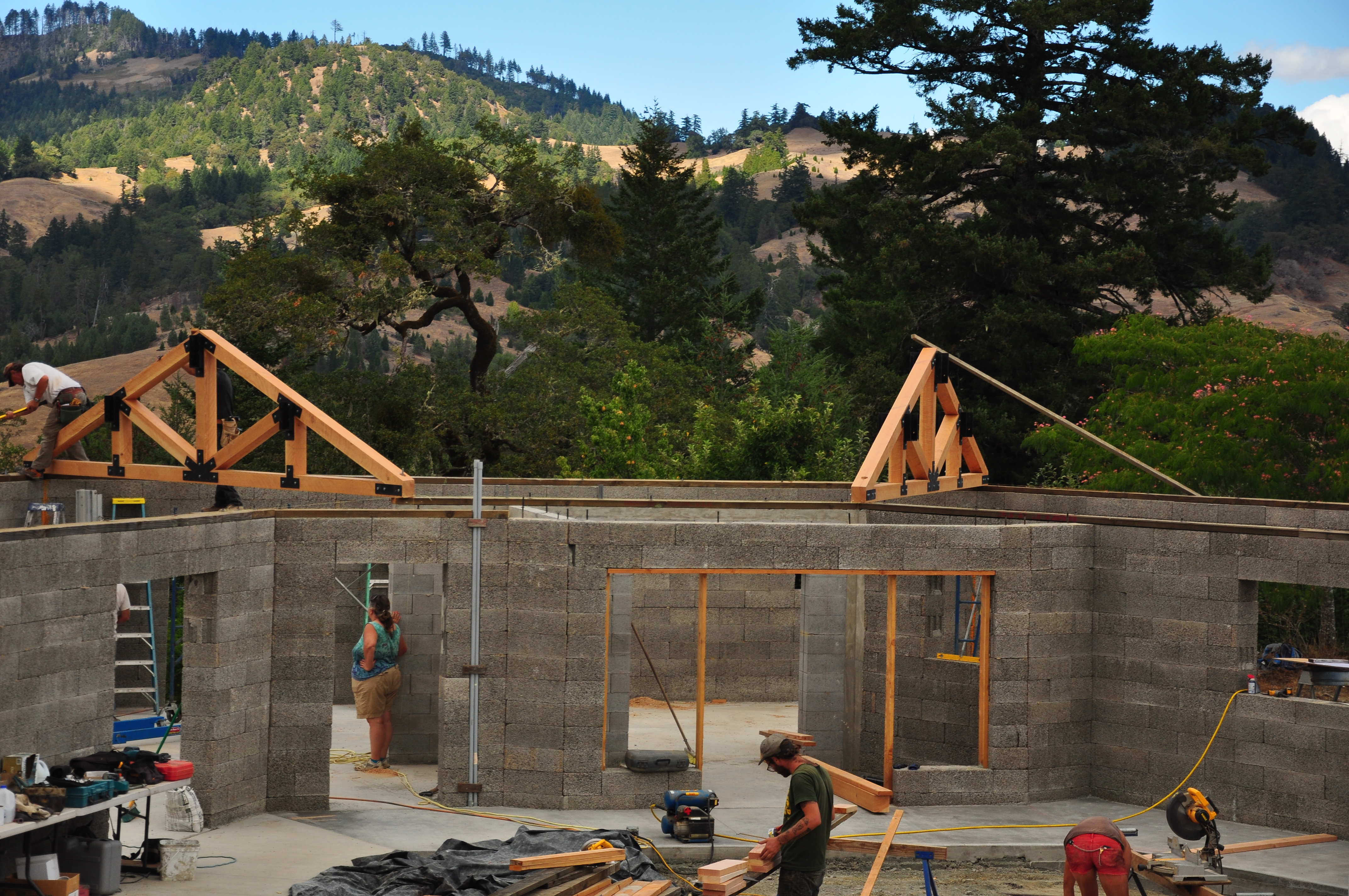

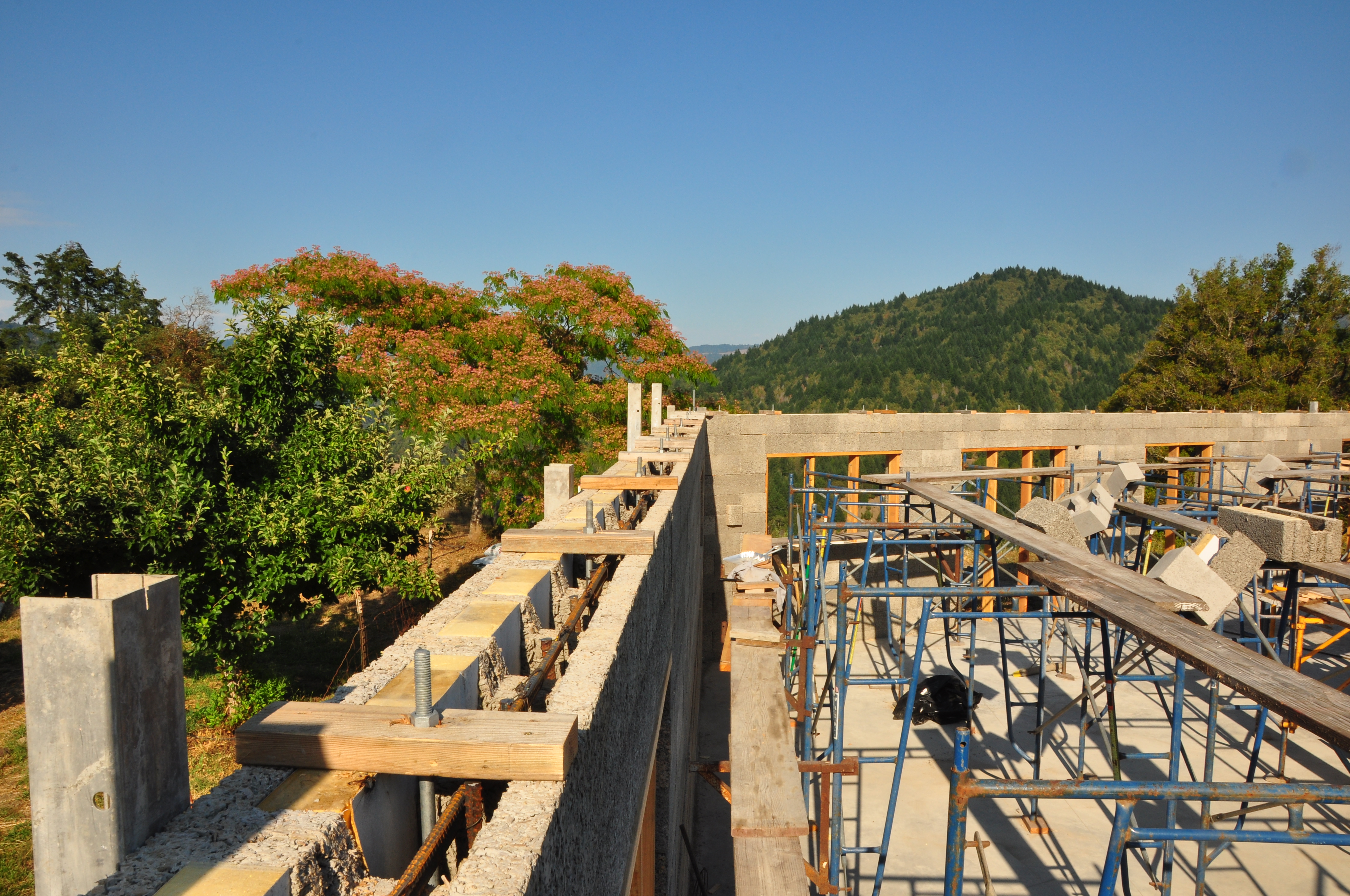

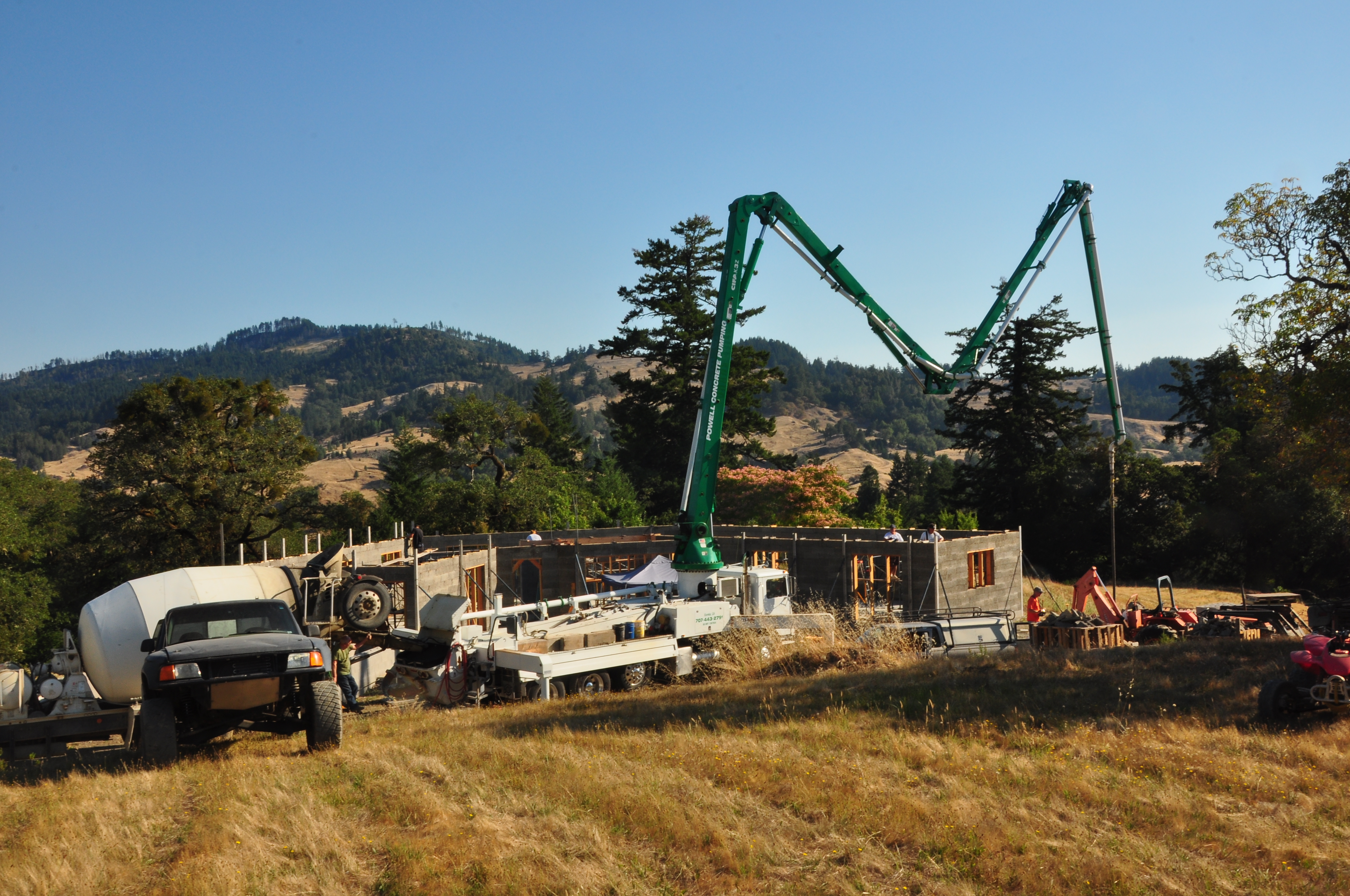

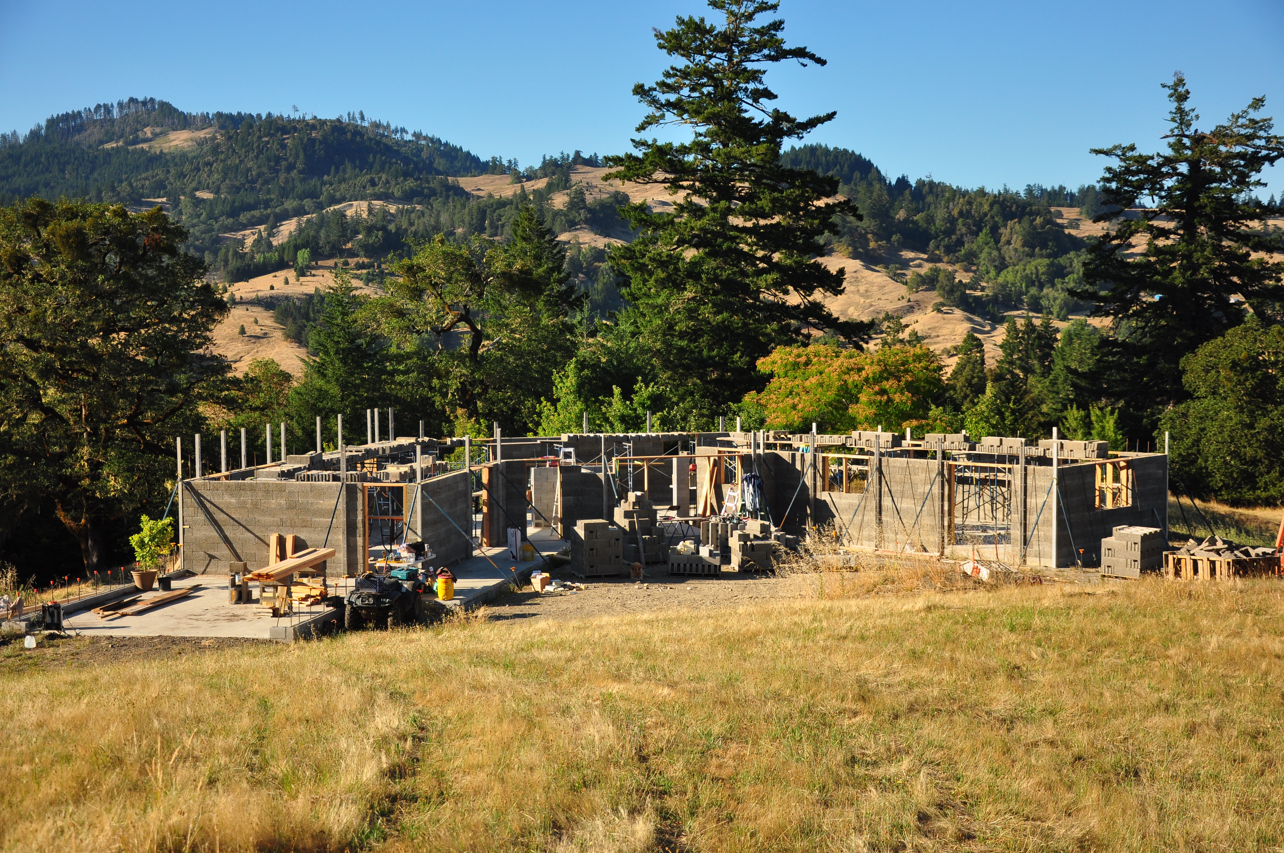

First photo shows walls stacked and braced with bucks in all the window and door openings. We stacked all this ourselves without much experience in block work. Also since these blocks are set up for square installations, we had to do a lot of custom cutting to get the 120deg angle cuts. We burned up one electric chainsaw! But it was really pretty easy and if you could've seen the block stacking job...well, oh boy, we weren't professional block layers, that's for sure. There were gaps and shims and bulges. Oh, and we used liquid nails in plenty of places to hold stuff together. Then came the big day, got the 80' boom pumper in there and put 26yds in the walls.

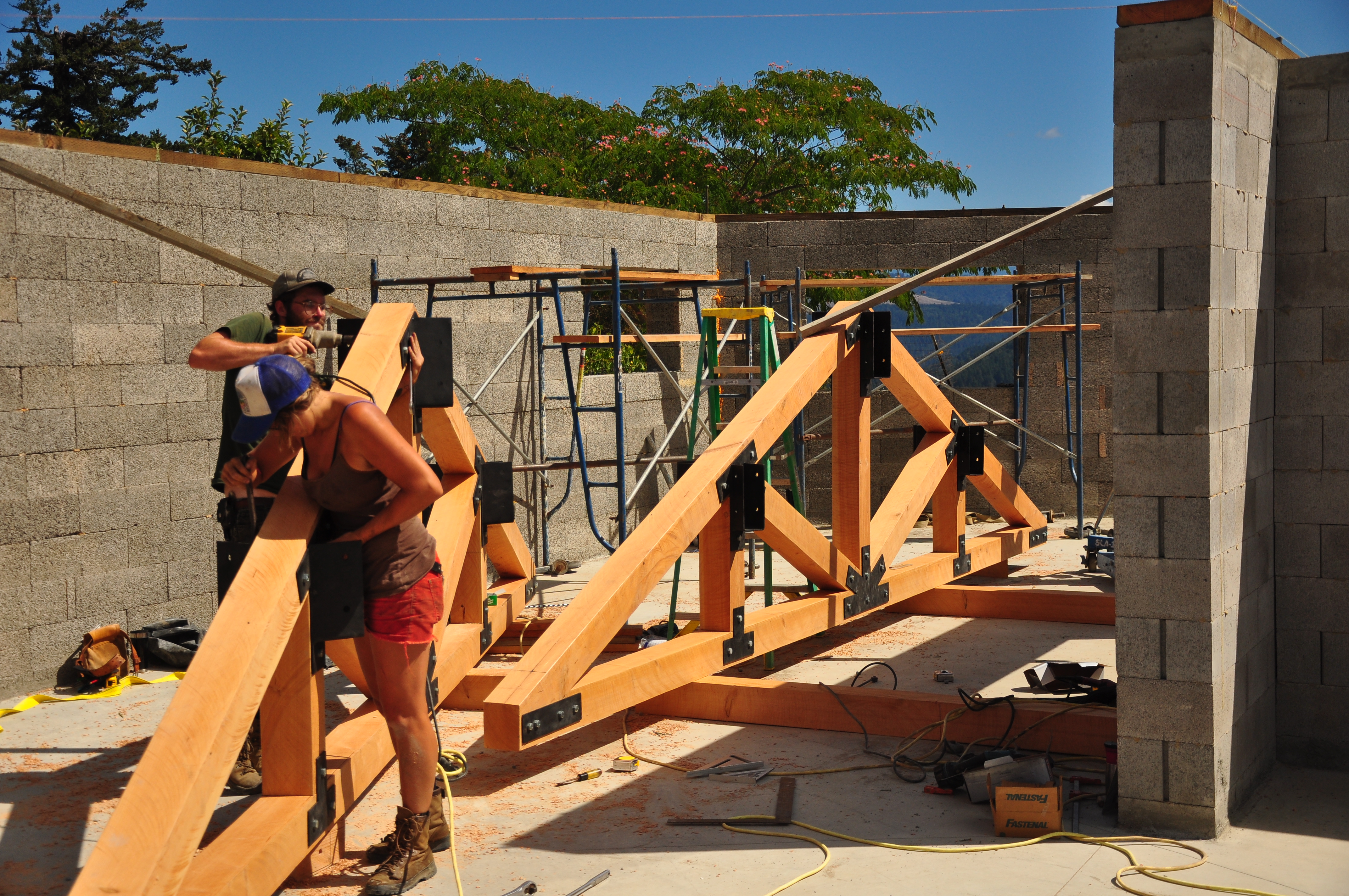

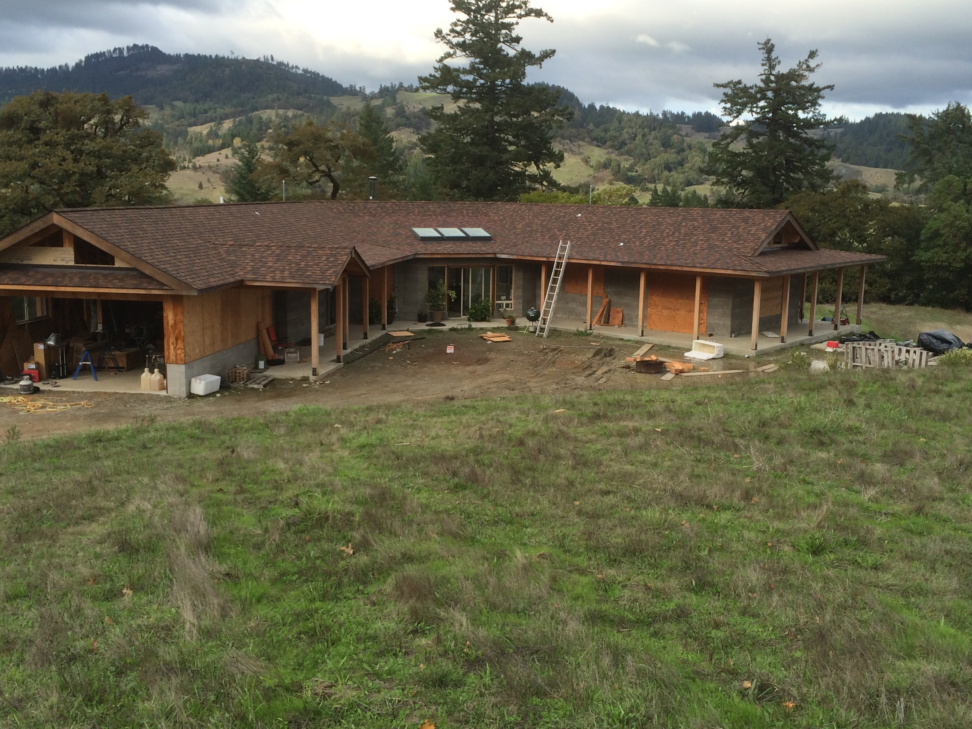

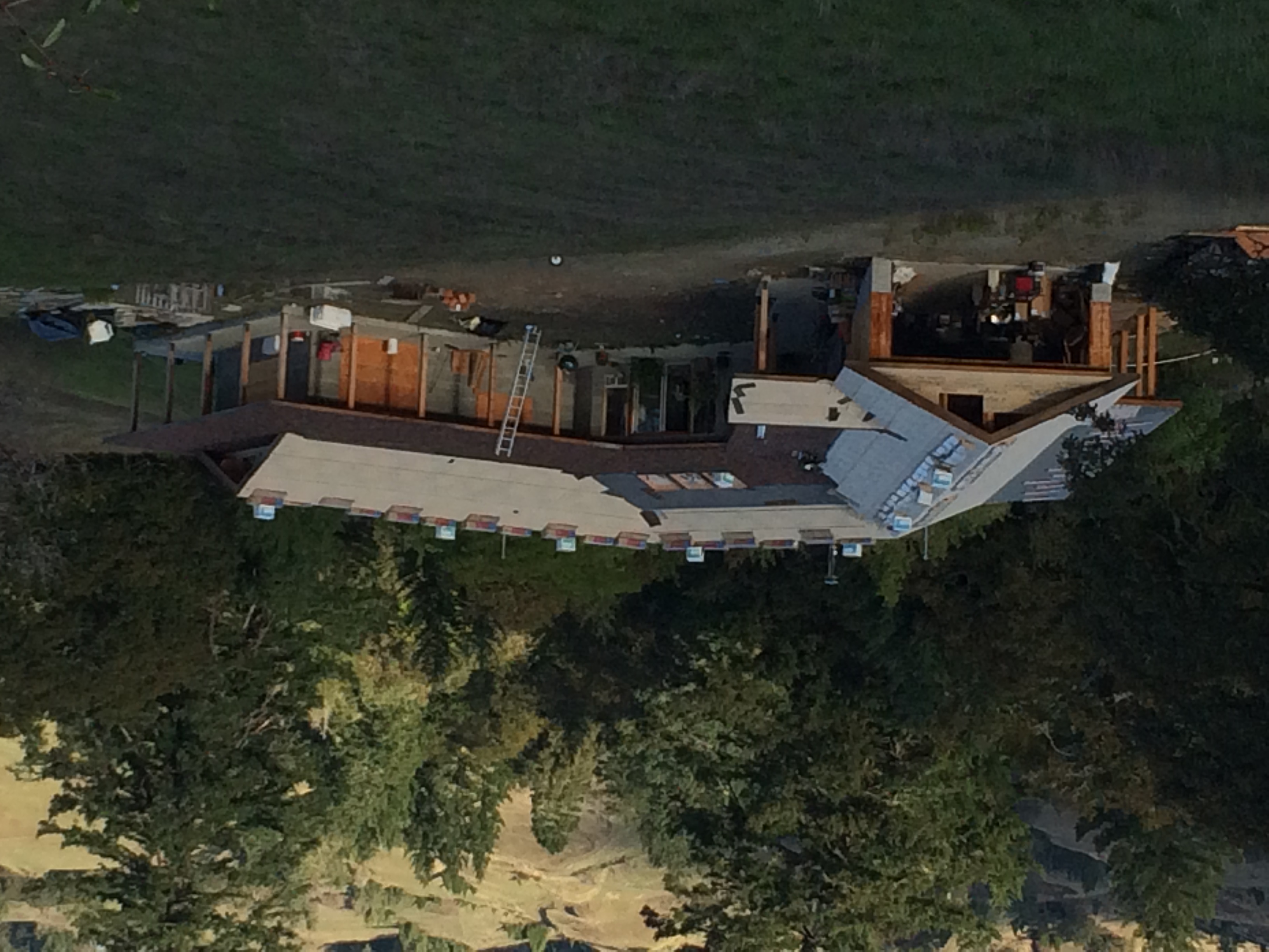

Not sure what's going on with this post but photos show trusses we built and put up with easy lift we rented...great tool! Then roof on, ready for stucco.

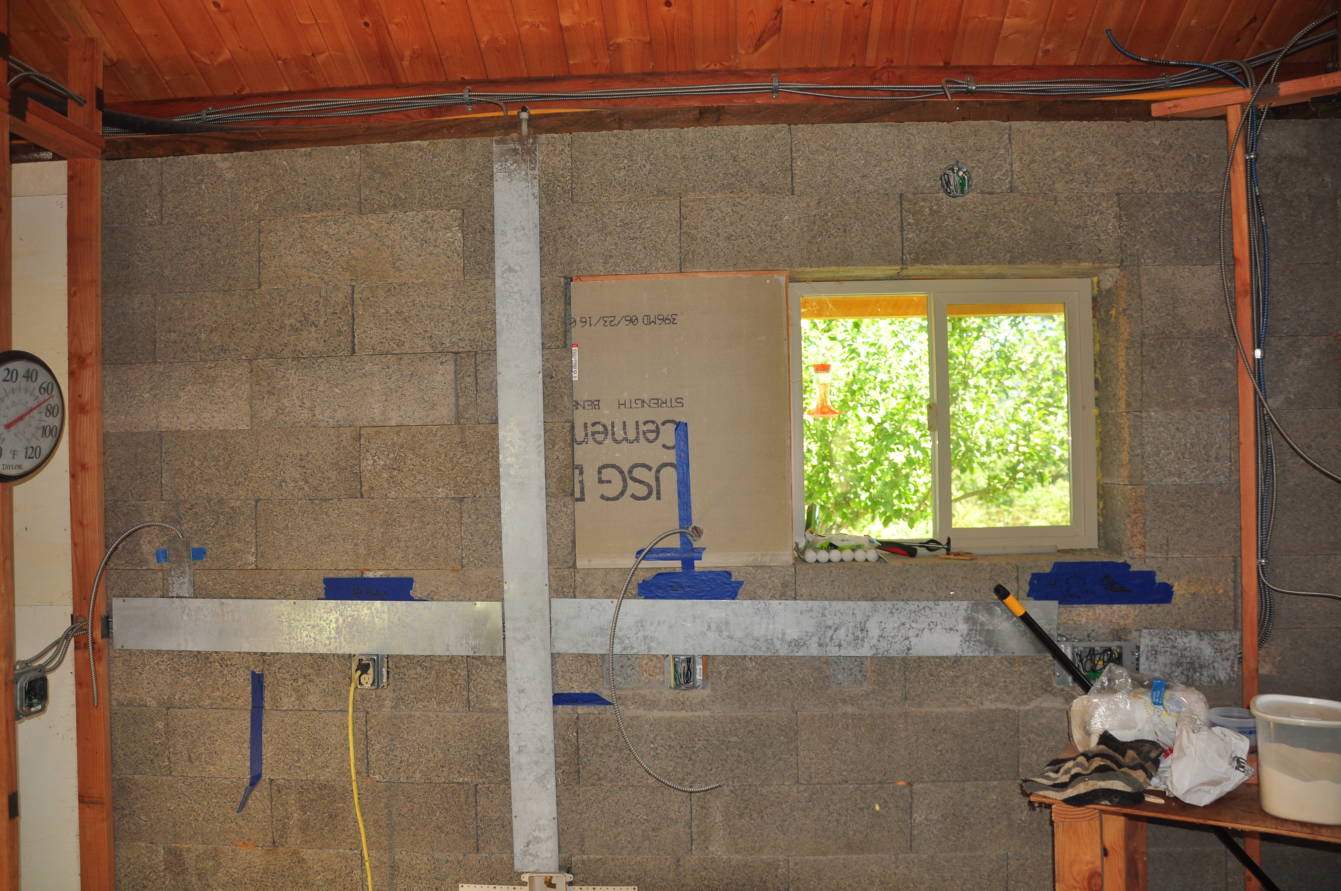

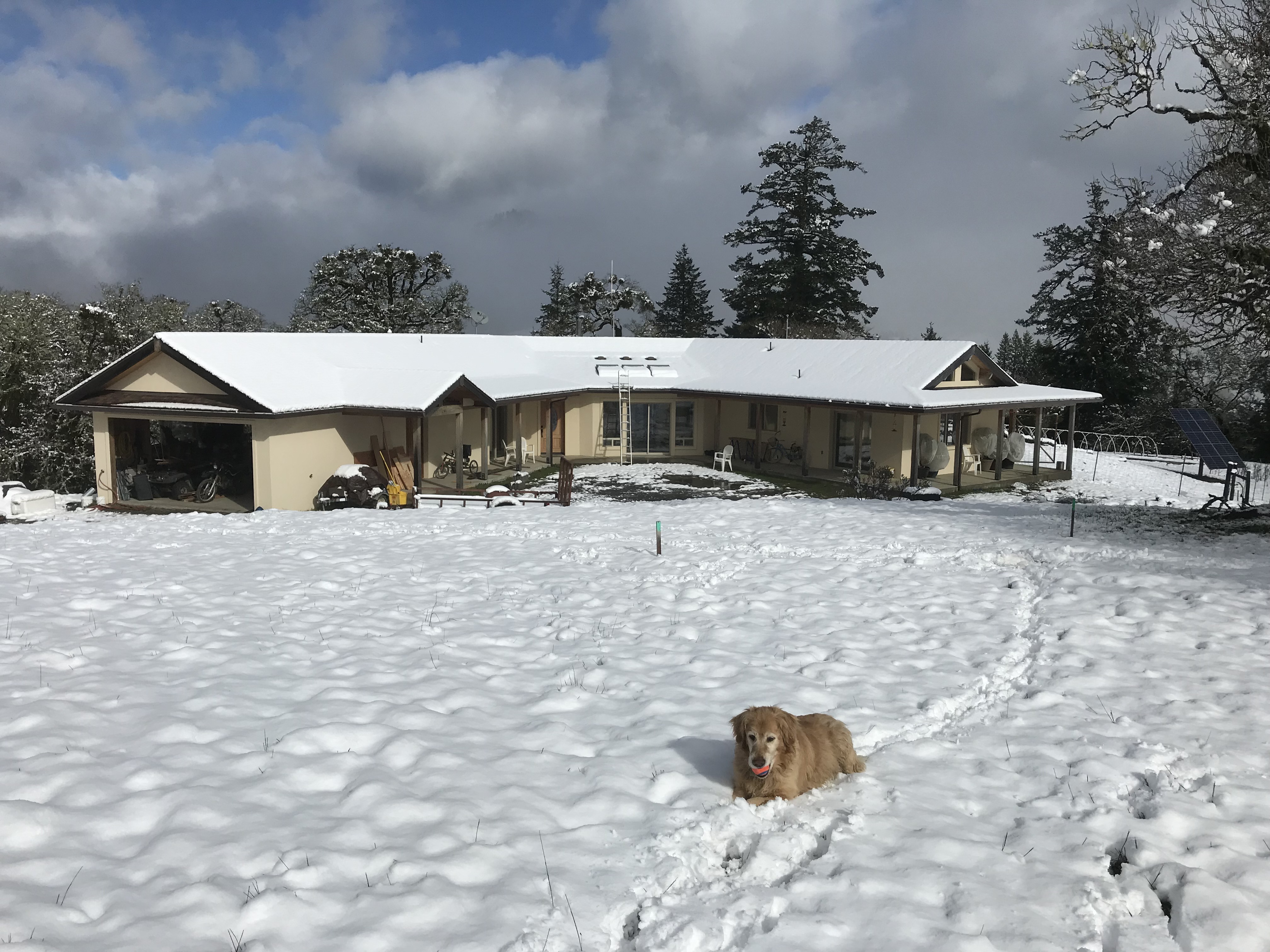

This is most recent outside photo showing stucco on, closed in, moved in but still working on doors and trim. Taken in February after the only snow we got all winter...It was gone by that evening. Got the 2m antenna up...I put 1 1/2" pipes up through the roof into a couple interior stud walls so I could put up tv dish, ham antenna, etc. and have cables running through weatherhead into walls. Also photo of interior before sheetrock showing nail protection plates in place. Even with that, cabinet installer still put a screw right through the center of MC cable!
OK, that's how it went over the last 7yrs. I had originally planned on using Polysteel 'cause a buddy of mine was a dealer and even got a bunch of it but ended up selling it after hearing about different problems installing it like cutting it with poly then hitting the steel in it. Also just wasn't thrilled about polystyrene even though once it's built you wouldn't see it but you would still have a million little balls of poly around. The Faswall is just wood chips from pallets (which sometimes are hardwood) with the rigid insulation block built in. The Faswall is all covered up now too but I did leave one spot open in a closet for a 'truth window'. It's pretty easy to work with and I would definitely do it again.

DirtRanger: Nice place, looks like you have a beautiful view looking over some terrific scenery. And nice to see someone else who drank the Faswall kool-aid. :laughing:
Like you said in your comments, the blocks lend themselves well to the DIYer and there's definitely more than one way to skin a cat when working with the blocks. The key is taking your time, planning ahead, AND leaving yourself some 'wiggle room' for unforeseen requirements. Running a few extra pieces of conduit; widening an interior wall from 2x4 to 2x6 (or 2x8) to accommodate plumbing vent lines, additional electric, etc.; or setting some extra utility boxes here and there can save a lot of headaches down the road. It's a lot easier to put a blank on a box then it is to cut in another box after the pour.
Again, thank you for posting your construction pictures and giving us a peek at your construction process.

montanadave, you're right about planning ahead...we didn't do that in some cases and wish we would've put some tubes in the concrete and through the walls. For instance, we didn't really plan for the power conduit in to the house (duh!!) so we had to bore through the Faswall (concrete and steel). That's what ya get when you're the barefoot architect!!
