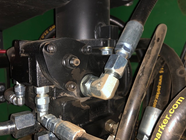

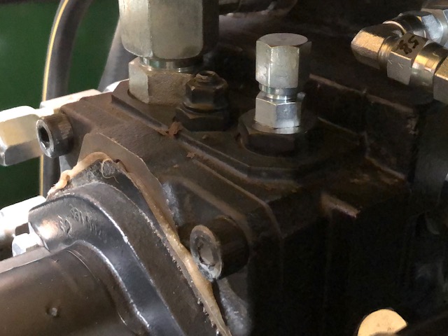

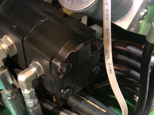

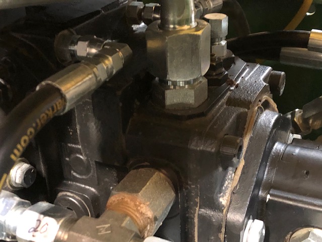

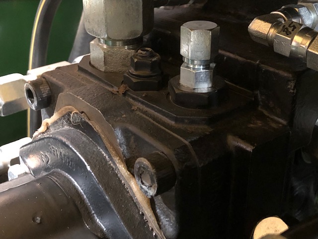

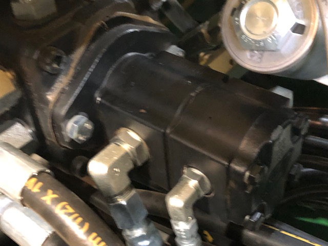

Incline...any chance you can take a few pictures of your hydraulic pumps? I'd really like to know if PT is still using the Bondioli and Pavesi pump with the Kohler engine. Thank you.
   / Anyone with the new 425... #30
Here you go - It appears they are B&P pumps based on the stamped logo. A couple of stamped numbers as well if it helps:
128051900
P162X19 followed by 2600
P139X1
These pumps look nothing like the ones depicted in my owners manual but here they are.
