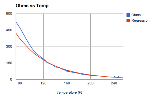

After some foibles about not ordering hoses and some of the gaskets, I have it back together and it runs very well. Rebuilt head, rebuilt injectors, valve job, valve clearance adjusted, new hoses, gaskets and belts. New Rotella T 15w40 (?) and new ~ 50/50 Rotella ELC/distilled water (might be closer to 60/40, have to look at that -- coolant capacity is only 2.2 quarts!). Can't tell much difference in the way it runs than before though. It always started and ran fine. Might start a little faster. Not hard to start at all. Just overheated. Before I rebuilt it, it would overheat in 10-15 minutes. Seemed like it was using water. We would always be putting distilled water in it (stealing it from under my wife's ironing board).
BUT ...
It still overheats! :banghead:
But only if you put some load on it. Just sitting there running full throttle, the temp gauge will only go to the middle white line. If you mow with it, it will creep up close to the highest white line (just before the red area). This is about where we would normally shut it down and let it cool off. We would let it get close to or almost touch the top white line.
SO ...
This is where it gets interesting, or maybe laughable for those of you who know what you're doing. :rolleyes:
So I started wondering... Exactly how hot is it actually getting? Time to pull out some nerd power. So I did what I probably should have done in the first place -- pull off the temp sensor and check it out (screws into a water passage on the head on the opposite side of the head from the water pump). So it's just a resistor thermocouple type thing, so we got a pot of water on the stove, and a digital cooking thermometer (again stolen from the wife), and hooked the sensor up to an ohm meter. Put the thermometer and sensor the pot and turn on the heat. We took readings of temp and resistance and made a table of the findings. But we could only get to about 210 F, so we plugged in into a spreadsheet and did an exponential regression function (just finds a function that approximates your data set). This allowed us to carry the values out further and it was pretty close.
On to the mower. I wanted to know how hot it was actually getting and also what temp the sensor thought it was. We had a point and shoot infrared thermometer and also a thermocouple that comes with a nice Fluke multimeter (s'posed to be pretty accurate). So we got all set up and stuck the Fluke probe in the radiator right where the upper radiator hose will flow right onto it. We also took measurements with the infrared on the surface of the radiator right next to the upper radiator hose. We used the infrared to measure the temp of the surface of the head next to the temp sensor and also the surface of the block below the head.
Turns out that the measuring radiator surface with infrared gave very close to the same reading as the Fluke probe in the coolant flowing from the upper radiator hose (within about 2 deg or so). So we dropped the Fluke and put the radiator cap back on. The block temp by the temp sensor was also within a few degrees of the radiator by the upper hose. The temp sensor was consistently indicating a higher temp than we measured with the Fluke or the infrared. Seemed like the hotter it got, the more difference there was between the two. We did notice when the thermostat opened.
We could only get it to about the middle (straight up) white line while sitting there, so I started mowing with it -- pretty tall kinda wet grass with kinda dull blades. The temp gauge started creeping higher. I wanted to know the temp when it touched the top white line. But it never got there. It stopped going up when it was just a little bit before the upper white line -- a little over 3/4 of the way from the middle line to the top line -- bout an 1/8" from the top line. Hmmm. So we checked the temp. The radiator but the upper hose measured 209 F and the head by the temp sensor measured 206 F -- but it cools down kinda fast, so hard to know. The block was 211 F. The temp sensor resistance showed that it thought it was about 214 F. I read that many engines (and have experience with one) have a thermo switch to shut them down at 230 F.
So whaddaya think?!
  • Is my temperature measuring good enough?
  • Are the temps in the normal range?
  • Is my temp sensor bad?
  • Or is it the gauge?
  • Or some of both?
I still need to do more mow testing to see if it will eventually go up higher, but it was starting to rain and I need to sharpen the blades. Maybe tomorrow.

Well, did some mowing yesterday. Didn't go well. Didn't seem to have an overheating problem though -- IF we go by the temperatures (as measured from an infrared thermometer pointed at radiator by the upper radiator hose, which has been shown to be within a couple of degrees from actual coolant temp as measured with a thermocouple on a Fluke meter). The temp did get to about 216, but if we didn't cut grass as fast (i.e., let load), they would stay in the 195-208 range. I have not been able to get a good feel for what acceptable temp ranges are, but from the fuzzy indication I have got from reading, this seems OK. Seems like they should definitely be > 180 (the thermostat opening temp) and >220 is getting kinda hot. 230 means something went wrong and you need to let it cool off and shut it down. (Can someone tell me if these temp ranges are OK?) I looked at the coolant level this morning ant it was normal. So, no boiling over. Prior to head gasket fix, the coolant level would have been quite low and I would have to add some. So, I think the temp gauge/sensor is just reading kind of higher than it should be.
BUT...
It started doing something different. It would act like it was running out of fuel or something. But it wasn't. It started running very rough, like it was only running on 1 cylinder or something, and then it would stall out and stop. Thought it might just be some air still in fuel system, but I don't think so. Started doing this often. Got some video of it, but don't have it handy at the moment. This morning, cold, it started right up and ran normally for maybe 60 sec, then it did the same thing. Started again and it didn't stall out, but would periodically run rough and then recover. But it was acting intermittently. Does not seem to smoke when it does this. Injectors have been rebuilt by diesel shop with good reputation. Didn't drop them or anything. I have not messed with the injector pump at all. I did remove the hard lines when doing the head. I did remove and clean the fuel filter -- didn't seem dirty enough to replace (cleaned in kerosene and blew off with air). I did bleed the fuel system afterward (fuel bowl, line to pump, caps on injectors).
Any ideas?
It sort of seems to me that the cooling system is right on the edge of being insufficient. This Kubota engine is a 14 HP engine with a 2.2 QUART coolant capacity. The Yanmar is a 19 HP engine with a 1.1 GAL coolant capacity (about twice as much coolant). Yanmar radiator seems quite a bit bigger too, but haven't measured.
I would like to do the pressure test that Eric talked about. Don't have a pressure tester though. Maybe Advance Auto has one I can rent. I did notice that coolant flows EASILY out the temp sensor hole in the head. Found this out by accident by trying to add coolant with temp sensor out. And the temp sensor is on opposite side of head from the water pump.

With all the overheating, loss of coolant, etc. before tearing into the engine and the current readings you're getting, and considering you replaced radiator cap and T-stat, I'd say it's time to try another head temp sensor.
Some good things so far is it seems to not be boiling over, using coolant, etc, so all that is definite progress. Temp sensors don't last forever especially if exposed to the high end of their range like yours has been over a long period of time. Changing it will also give feedback on if the new one reads differently on your gauge.
