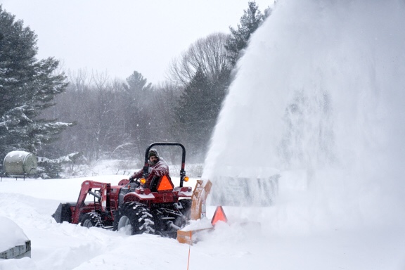

Laderbuilt,
How do you like the rear snow blower? What size/model do you have. This is one of the items I someday plan to add to this tractor. Just a little weird having a rear mount. I frequently use my walk behind snow blower to clear a path in my yard for firewood transport. Have you ever used this on grass? Want to remove the snow, not the grass.
Thanks!

I like the rear mounted blower a lot
I have a Woods sb64?? I think is the model number.
In all honesty a front mounted snow thrower is ideal from an operation point of view.
Now with that out of the way I'd never own a front mount! First is cost. They cost substantially more money. Second cost. They cost you time in setting it up and taking it off it is way more time involved then the rear mount. Third cost is work. By having the rear mount I get to keep the loader attached. So I can back drag the snow away from the buildings or obstacles turn around and blow it away! Or dig up a pile of snow that the town pushes on to a corner of my property/driveway and blocks my view of the road. I swear they started doing it just because they've seen my setup. Plus if your stuck you again still have the loader to help get you out.
I have an outdoor wood boiler and I clear a LARGE! Portion of my yard with the snow blower. All I do is raise the skids on the blower to give me approx 3/8-1/2" of a clearance from the cutting edge to the ground takes about 5 min "in actuality I've left it that way all the time" and away I go. I do gouge the lawn in some spots with the skids not the main cutting edge but only when doing hard turns. Come spring they disappear. I've never "eaten" my lawn and blown it away. So no worries there. I'll attach a pic if possible.
