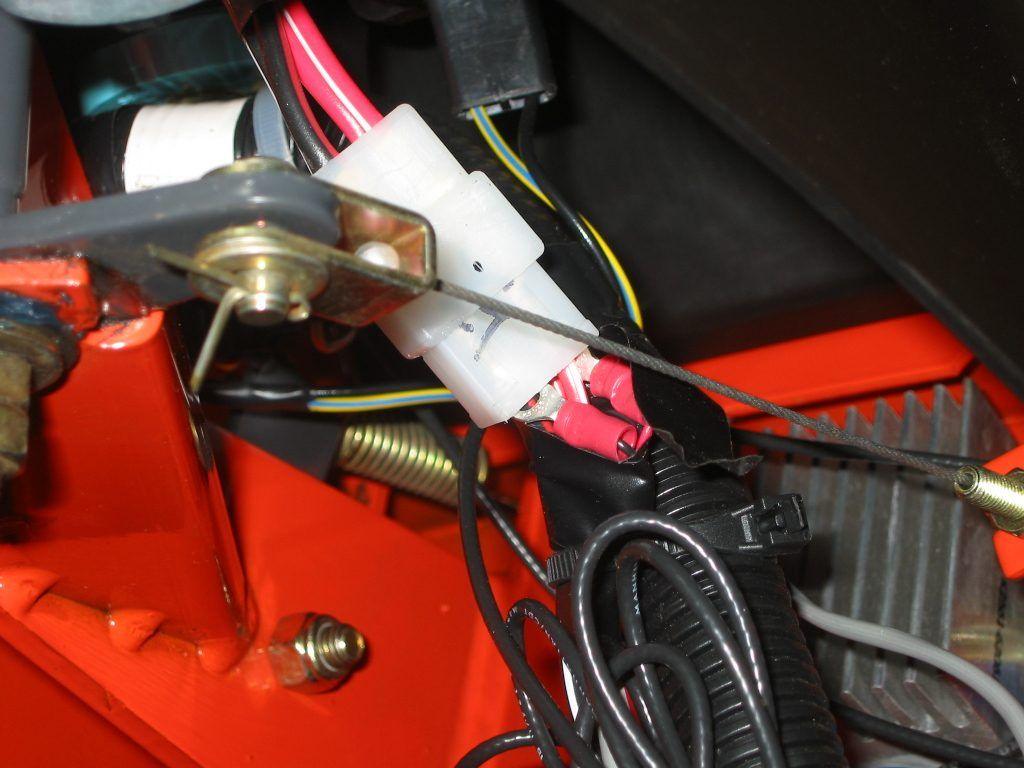

This shows the two red connectors by the piece of electrical tape. Those connectors are attached to the tiny tach power and ground wires. I then pushed these connectors into the plug coming from the key assembly. The power went into the red wire with a white stripe and the ground went into the solid black wire.

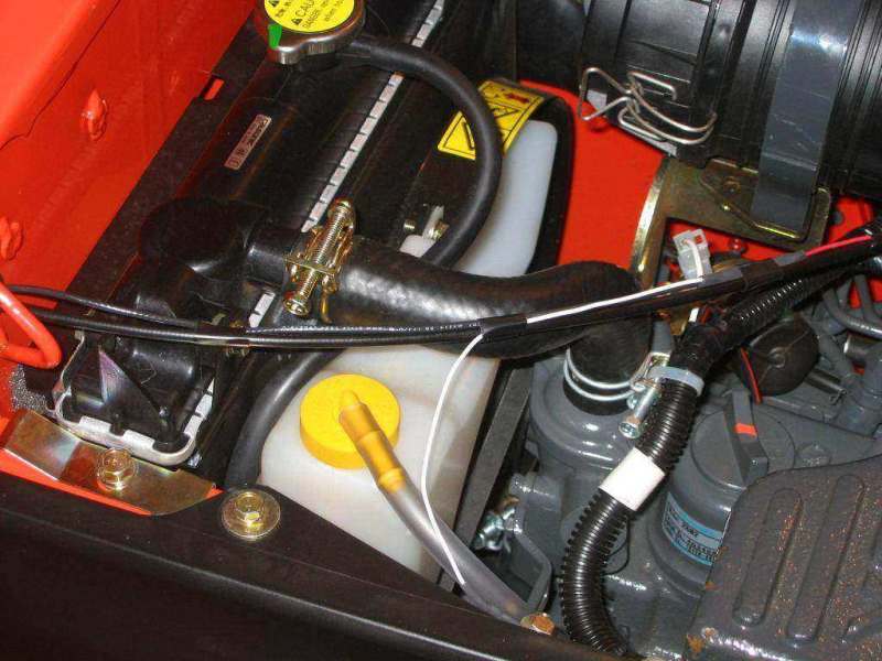

   / Apollo, Where Did You Get the Mini Tach?? #13
I ran it along the throttle wire and electrical taped it on. The white wire on the bottom is a ground i connected to a bolt on the side. The red transducer wire ran acrossed the motor to the fuel line.
   / Apollo, Where Did You Get the Mini Tach?? #14
And last but not least the 6mm transducer attached to the front cylinder fuel line.
The paint didnt match exactly for the grey but hey!!! Its a tractor !!!!!!!!!!!!
Hope this helped, any other questions or photos just let me know.
