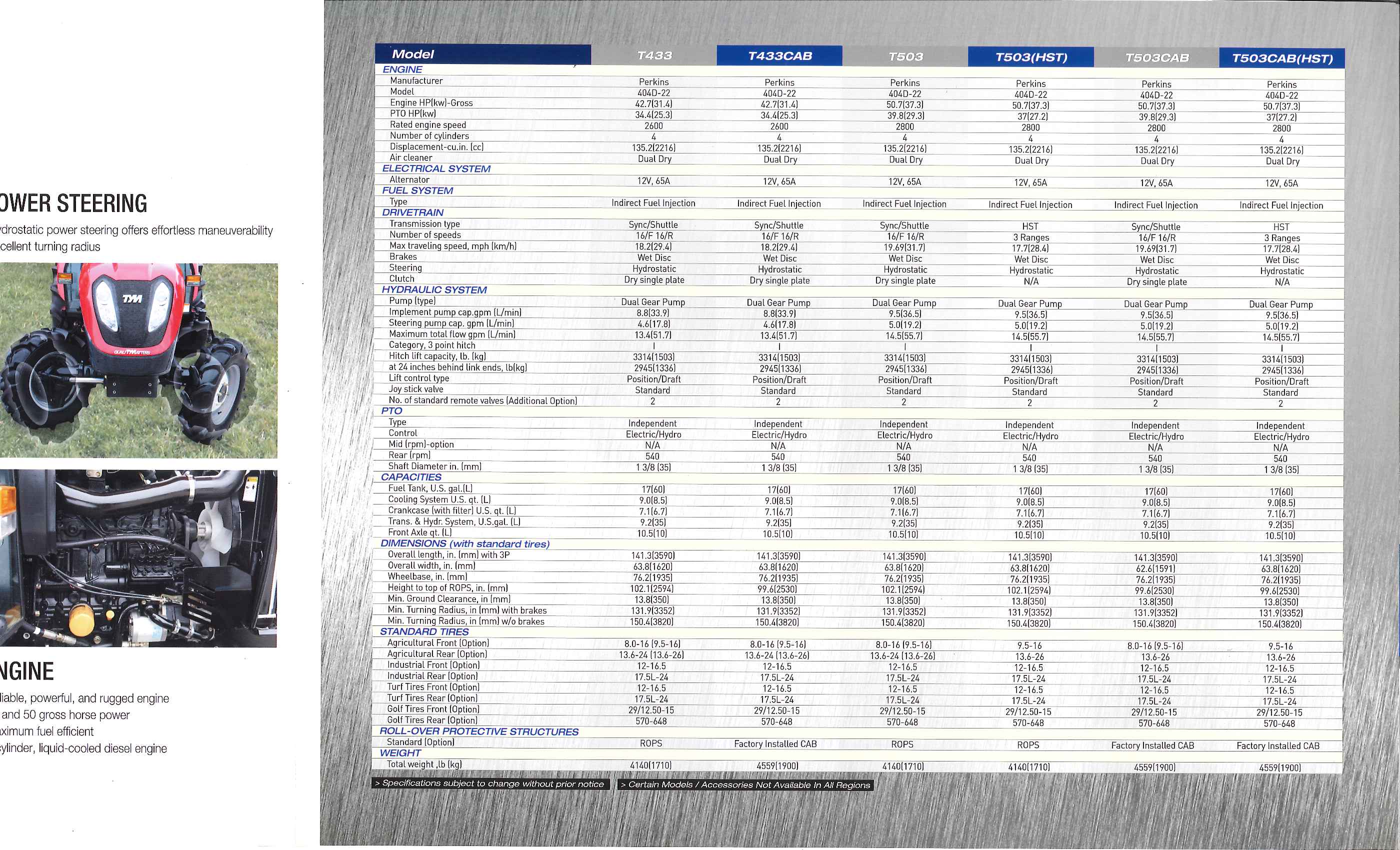

As a reference, these are the official specifications for our 40-50 horsepower models.
You might need to zoom in. :)

<img src="http://www.tractorbynet.com/forums/attachment.php?attachmentid=361919"/>
As a reference, THESE are the official specifications for our 40-50 horsepower models.
Yes, the HP numbers I posted were for HST models only ... that is where the driveline loss shows in the PTO HP numbers.

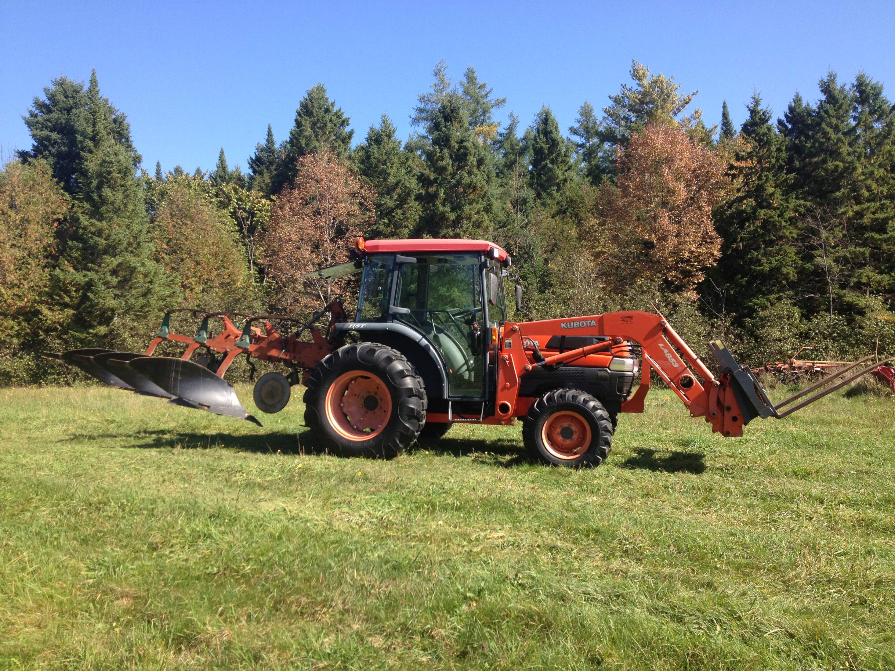

I will tell you the lift numbers on the 3 point don't really matter that much. Even with a loader on you won't be able to use that hitch capacity unless you get a big bucket of dirt first. My snowblower is a big side chute model Normand that sticks way back, with blower raised the tires barely touch the ground, can't steer on snow unless you fill the bucket. Everything else big I have for the 3 point is barely usable on the small tractor.
As an example my KV AB85 spring reset plow below. Hitches up fine, tractor lifts it without sweat. Front tires barely touching ground, no where near enough tractor to use the plow.
Below the blower. I use the blower about 80-100 hours per winter and it runs well, just heavy.
