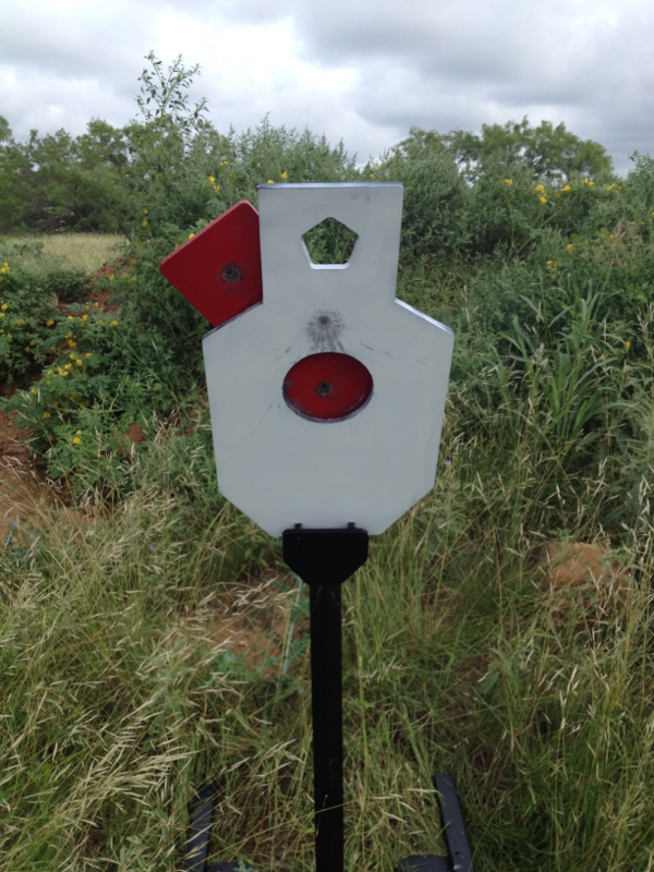

I have built a lot of different targets, along the lines of what your looking for I built this one using 3/8" ar 500 and have shot it with rounds up to 300wm.
At rest the red plate is covered from the shooters view by the black one, when hit it rocks back and the red plate pops up, so you can see the hit even if you can't hear it.
The wet are 1/2" EMT and the cross bar is 3/4" bar stock. So it is portable and doesn't need to be set into the ground.
If your not going to be shooting level with the target you would need a way to adjust the "flasher" part to suit the terrain.
