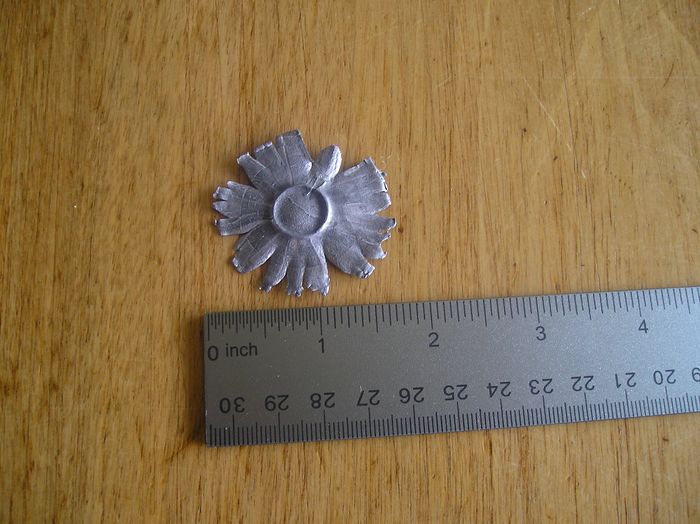

Here is some "splatter" from a .45 colt.

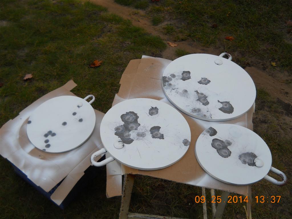

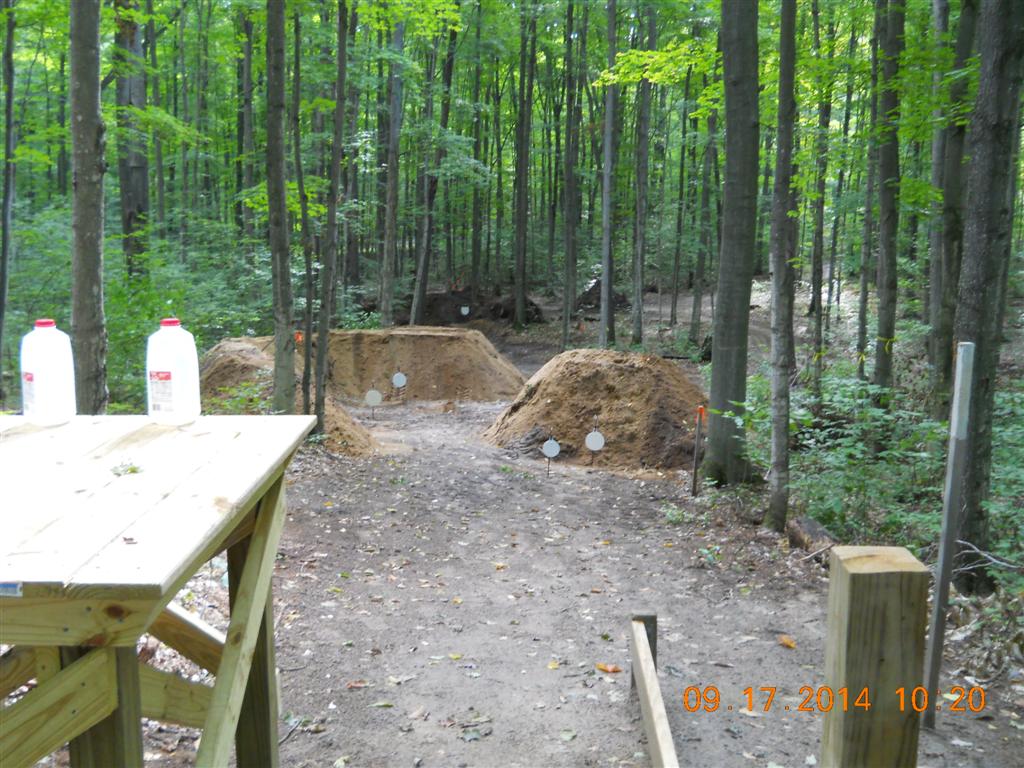

With steel, you don't just have to worry about 'too fast' which may damage the AR500. Too slow, and the bullet will not fully disintegrate... and worse case, bounce directly back at you. That's why it is best to mount it with the top leaning towards you a little... and free to swing upon impact. :) [ 8" to 12" AR500 3/8" set up from 10 to 25yds with a 9mm, my 50yd. target is permanently chain mounted and I paint in place ]
Those targets are not safe to shoot from 10 yards with that bolt in the center. I also shoot steel as close as 10 yards, but the face needs to be completely flat. I have shot steel with 38 special rounds as slow as 800 FPS, and have never experienced any bouncing back.
