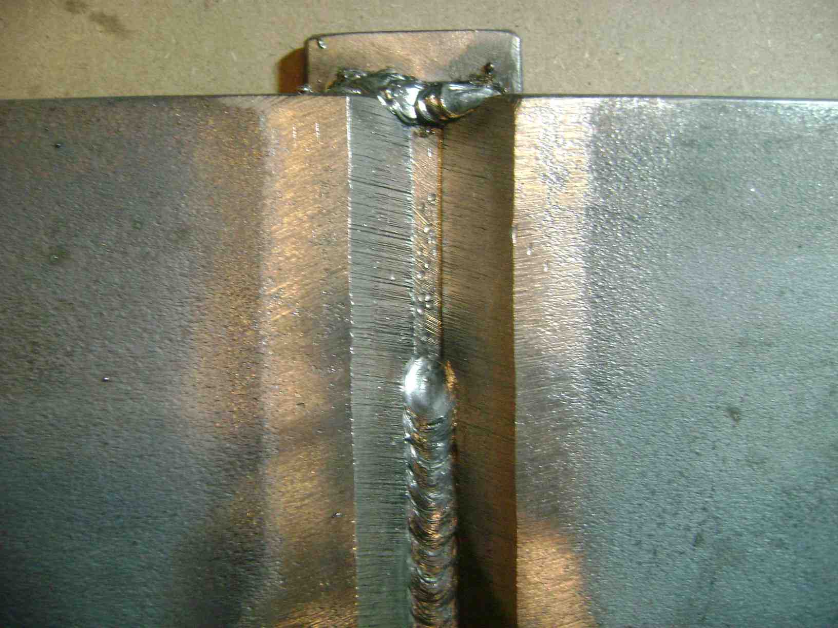

Actually 1/4" gap is easier. Generally the plates are gaped the same distance as the rod diameter, which gives you very little room to move.

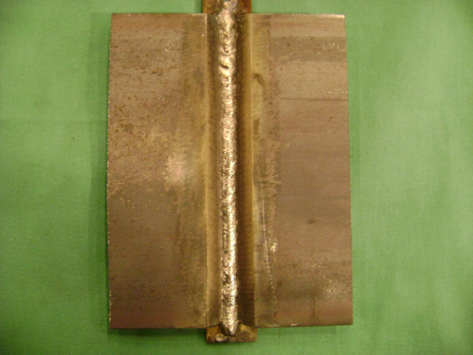

:confused2: Easy for you to say!!:laughing: With the 7018 rod having such a thick flux coating, there really isn't any room to move other than just a little wiggle here and there (usually due to bad grinding on my part). 1/8" 7018 is close to 1/4" OD, when you include the flux. It is one pass for us on the root, and no issues blowing through the backer that I have seen. We're running 110-115A. My biggest issue is that the bead won't fully lay down (humps a bit in the middle) so I get trapped slag at the edges that I can't get out (or can't see).
   / Arc blow in G3 test plate #25
Oh yeah! That is called wagon tracks. Bad business if you're not allowed to use a grinder. I never ever took a plate test where I could use a grinder.
If you're getting wagon tracks, you need to work on your rod angle, and travel speed. If everything is correct you should be able to just drag the rod up hill with very little movement. For my root pass with 7018 I'll have the rod about 5 degrees down angle, (85-degrees to the plate). When doing this if I get in trouble, I'll start making a J motion. Run up one side, back down into the puddle, hold until it fills, run up the same side again, repeat as many times as necessary.

   / Arc blow in G3 test plate #27
You mentioned speed - is this usually a too fast or too slow issue causing it?
It's a too slow, and too cold kind of thing.
Here is a vertical up root with 7018, I just stuck the rod in and drug it up hill, next to no movement at all. See how the heat started to effect the weld at the top?

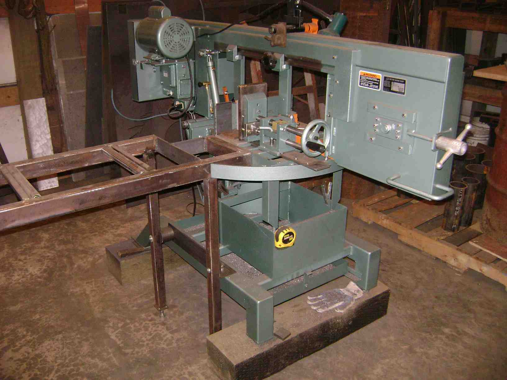

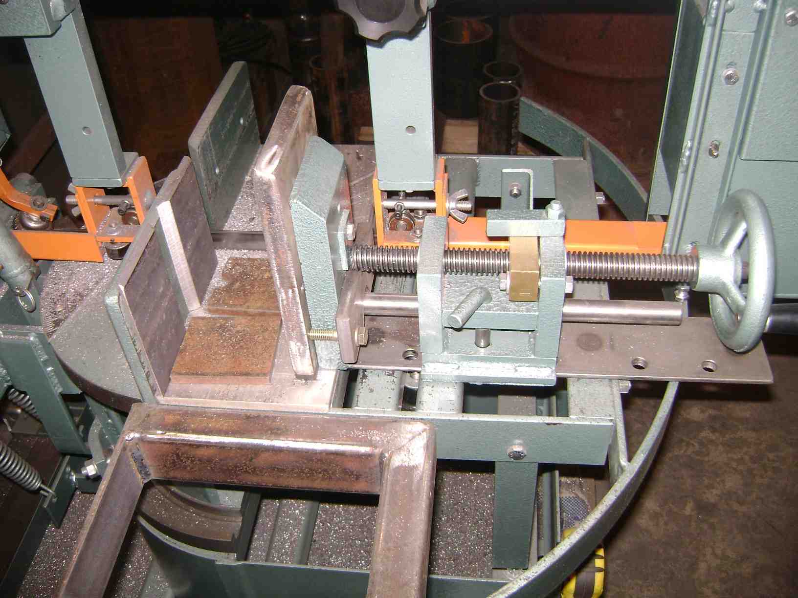

I have an Ellis 1800 saw, takes me just a couple minutes to cut the bevels, and tack up a plate.
