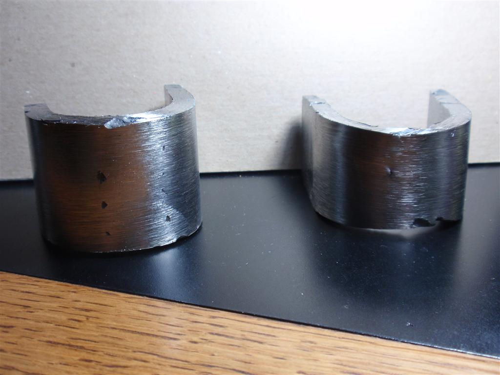

So here it is. The plate on the left is the face bend, and the one on the right is the root bend. I had one slag inclusion on the root you can see. I think it still "passes" from what the instructor says, but who knows. Basically I needed to start moving the rod more in a U or J shape, even though he was telling us to just drag it. Once I got there, it worked a lot better. Not perfect, but that is my lack of smoothness. For me, that is what I need. I would have no issue that my welds would hold well enough for the things I do. Practice helps a lot.
The face bend on the left, I didn't grind it flat as it was taking forever as it was. Plus I needed something to tell me which side was which. So those are the small pits you see.
Every other flaw is my bad torch cutting to make the bend plates...

Not bad.
It looks like the inclusion is small enough to pass from here. But it also may be related to the root pass busting through...which is a concern, depending upon how much you ground it down.
Just looks like the edges have a little underfill, even though you say you didn't grind it completely flat. A little more pause on the side will even it out.

I know for sure I am not steady enough or smooth enough, which is the "root" of the problem on both your counts, Mark (forgive the welding pun..). That is my downfall as a "weldor"...but for what I need, after this class I now know I have improved a lot and I have a much better idea of what is good/bad and why. I am in a better place now... :)
