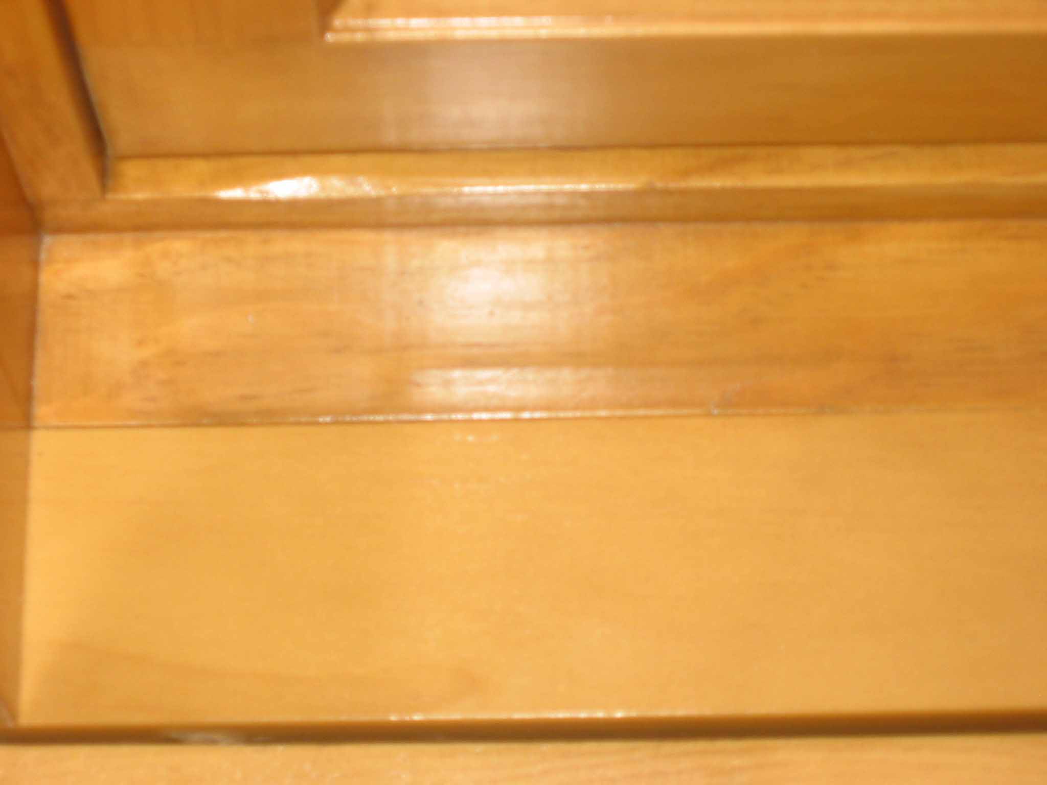

JDGreen - I think the extension jamb issue I was talking about is only on the 200 series, not the 400 series. We have both and the 400 series casements took an extension jamb that went all the way to the window frame eliminating the seam. The 200 series are all made initially for 2x4 walls and then the extension jamb is butted to the window jamb midway between the window frame and edge of the wall. Maybe the seam is just something I notice being the homeowner and around them all the time. I took a picture of our 200 series to show what I'm talking about. I also took a picture of our 400 series casement windows but I'm not sure if I can attach multiple picutres in this post. If not I'll attach it to another post immediately after this one. The pictures came out a little fuzzy but show what I'm talking about. I don't know if anyone cares to see them but here they are if you do.

I think Anderson is good quality for the money. If you want the absolute best then pay the extra and go with something else. However, we get nothing but compliments on our windows.
