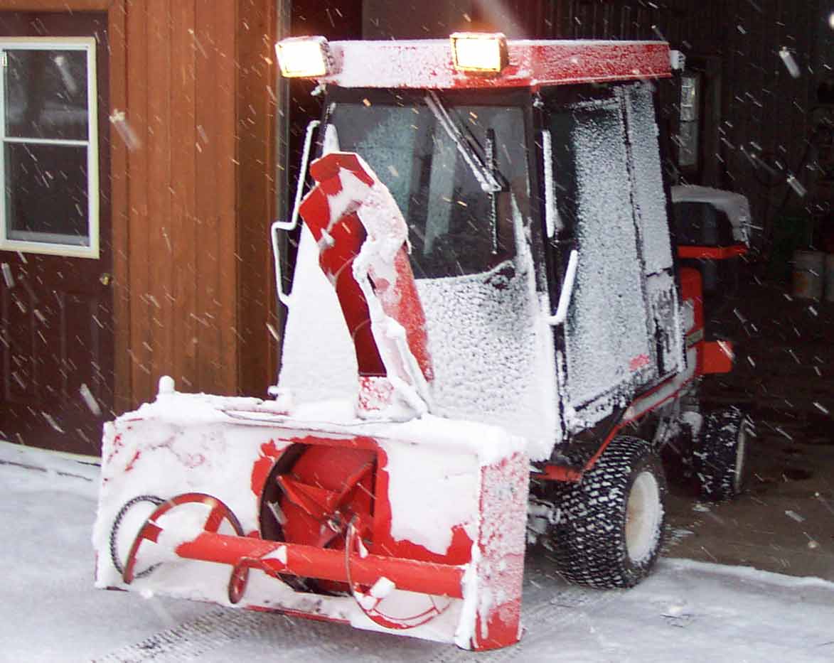

R W said:
A waste of money and fresh air.
Not all would agree. I agree with Atlas when he says a cab is just another attachment and whether or not it is desirable depends on your situation. My little Kubota F2400 is only 24hp but I specifically looked for a unit with a cab - snowblowing without a cab is no fun. Been there, done that, no more thanks! A heated cab keeps you warm and dry, especially when the wind is howling, its 0F and there is a foot of snow to be cleared off your driveway. It seldom goes over 100F here in the summer for more than a week at a time so I have no need for A/C. My cab is light enough (approx. 500 lbs.) that I can use a winch to take it off or put it on. I put the ROPS on for the summer. It only takes a couple of hours to make the switch either way.
