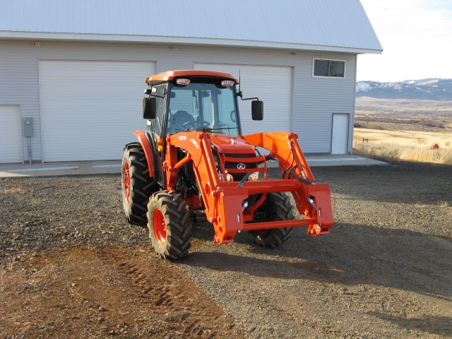

FWIW, the Kubota MX4700 and MX5100 use considerably larger tires and it is the same compact grand L 'chassis'. So you could upgrade (all around I'm guessing) to the MX4700 tires for a more beefy front tire.
I could be wrong, but I think the MX models are still using a 16" diameter wheel on the front, the same as the Grand L's, although the MX does take a wider tire. The rears are indeed on larger rims. Years ago there was a TBN member who wanted to upgrade the tires on his Grand L to a premium Michelin industrial series because it had aggressive R1-type lugs on a heavy R4 carcass - pretty neat concept, no? The issues were the cost and finding suitable sizes. After he bought the tires he found the new front tires would snag the loader brackets in a full lock turn, making it necessary to torch off some of the loader mounts before he could use the tractor. The more recent higher horsepower Grand L's have a slightly longer wheelbase, but it's still pretty tight quarters, particularly the clearance behind the front wheels.
   / are my front tires wimpy?
#23
sounds like all I would gain is an inch in height or width without running into things.
The moral of this story is they aren't very big, but they were designed that way.
I like the idea of more real ballast for all sorts of good reasons.

The Michelins work well on the front of the 5740.
   / are my front tires wimpy? #26
What tires/size do have on the front and rear of your 5740?
