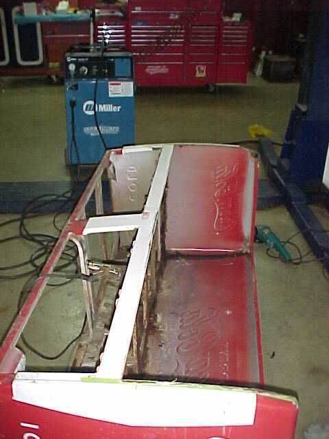

I started out with a Miller Spectrum 701 plasma. Great machine that gave zero trouble but it was hard on consumables. My air was dry but still it went through consumables and they were expensive.
I sold the 701 and got the inverter based Miller Spectrum 875. It's small in size and a beast. It seems to have twice the power of the Hugh 701 and it's so easy on consumables. I just love the thing. :thumbsup:
Here's a pic of the old Miller 701
This is the Miller Spectrum 875. He sure is a little fellow. I've since added a cart to it.

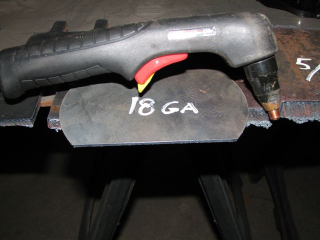

I fully agree that anyone that works with steel fabricating...should have an oxy-fuel torch before the investment is made in a plasma torch. Plasma torches historically have been a bit touchy (or finicky, as the thread title states!) when used on dirty, rusty materials...and also due to the torch shape (blunt front end) have typically not been the most visible, easy to use process. That however has all changed in recent years....and while it is more difficult to cut a nut off a bolt without damaging the threads with a plasma (it just cuts so freakin fast!), it can be done once you have gained a little experience. I often just cut the whole bolt off in a 1/2 second or so and replace it with a new one when I can.....although I know that is not always possible.
Try cutting stainless steel and aluminum and copper with the oxy-fuel torch....then try it with the plasma. Also....with the plasma you can stack up pieces of steel and cut it quite easily, oxy-fuel generally will not cut through a stack of plate....unless they are clamped tightly together.
Attached is a picture of the shape of the front end of a modern plasma torch....not much difference in size than an oxy-fuel torch.
Jim Colt Hypertherm
