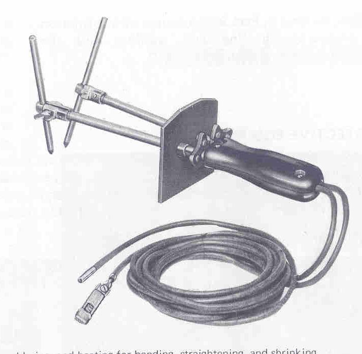

...Disadvantages - I still don't have a heat source for making things cherry red (bending metal, unsticking nuts, etc. )...

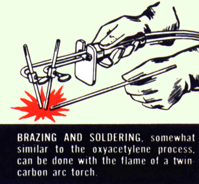

If you have an arc welder look into buying/or making a "twin carbon arc torch" head for your welder. It is old school technology and you have to wear your welding helmet, but it will actually heat metal hotter than oxy/acetylene will. Plus, you never have to lease bottles, run out of gas at the worst time, etc. again. You can braze with it and real savy user's can even improvise tig weld with it (I am not quite that savey yet though as most of my twin carbon arc flames seem more comparable to a rosebud tip on oxy/acet.).
It is also possible to use a twin carbon arc to loosen rusty bolts without any flame damage to the surrounding areas whatsoever by simply touching the two carbon rods on the nut and then turn the welder on - it will heat the nut cherry red without a flame. A very cheap must have tool for the occasional user in my opinion. A $10 box of the carbon rods will last the occasional user years. ( The torch head can literally be made for little of nothing by using internet plans, or Lincoln and Pwr-Kraft made the best commercial models although I think Lincoln recently discontinued their torch head but used ones are available on ebay all the time. Connection to the welder is easy. Stinger clamps to one lead and the ground clamp connects to the other lead).
NOTE: A TWIN CARBON ARC TORCH IS NOT THE SAME AS CARBON GOUGING (or an ArcAir gouging system) although the twin carbon arc torch head does utilize the same carbon type rods. You can NOT cut with a twin carbon arc torch - you can only heat things with it. In essence you strike an arc between the 2 carbon rods and then use the arc/flame that is created to do your heating work. The carbon rods burn very slowly, but you must wear your welding helmet. Having the welder in AC mode actually works best as the carbon rods consume themselves evenly in AC mode. DC mode will work too but just not as well - one rod will burn twice as fast as the other one in DC mode. Early cinema used twin carbon arc technology to power large movie projectors and early anti-aircraft search lights used the same technology to project searchlights into the sky.
   / Are Plasma Cutters "Finicky"? #57

Yep - that one looks like the Lincoln one. (The Lincoln is considered the best of the twin carbon arc torches and sometimes will still sell for $100 on ebay. I have an old Montgomery Wards Pwr-Kraft torch head that I paid $20 for on Craigslist - not as good as the Lincoln version but it works. I was going to build a free one using old automotive jumper cables for leads and modifying the plans on the internet, but could not even fool with it for $20).
My guess is that in the hands of an expert like you that you would end up being one of the savey user's who could even improvise tig weld with it. I have heard that many 1940's and 1950's era welders succesfully used these things on aluminum welding long before better methods came along that were affordable to the hobbyist.
Using only a Lincoln AC-225 AC buzzbox for the power source: Even a hack like me can easily control the flame well enough to heat metal with it in order to bend it or straighten things (these things can burn up to 1000 degrees hotter than oxy/acet if needed). I do not need extreme heat very often and one of these is the perfect low cost way to get that extreme heat on those rare occasions when I need it. A $10 box of rods will last a very long time. No expensive bottles to lease, no expensive gas to buy, never have to worry about running out of gas on the weekend and everywhere is closed, nor the dangers of having to store gas tanks.
Not necessarily the perfect tool for everyone, but the perfect tool for my infrequent needs and if it is all you have you make it work.

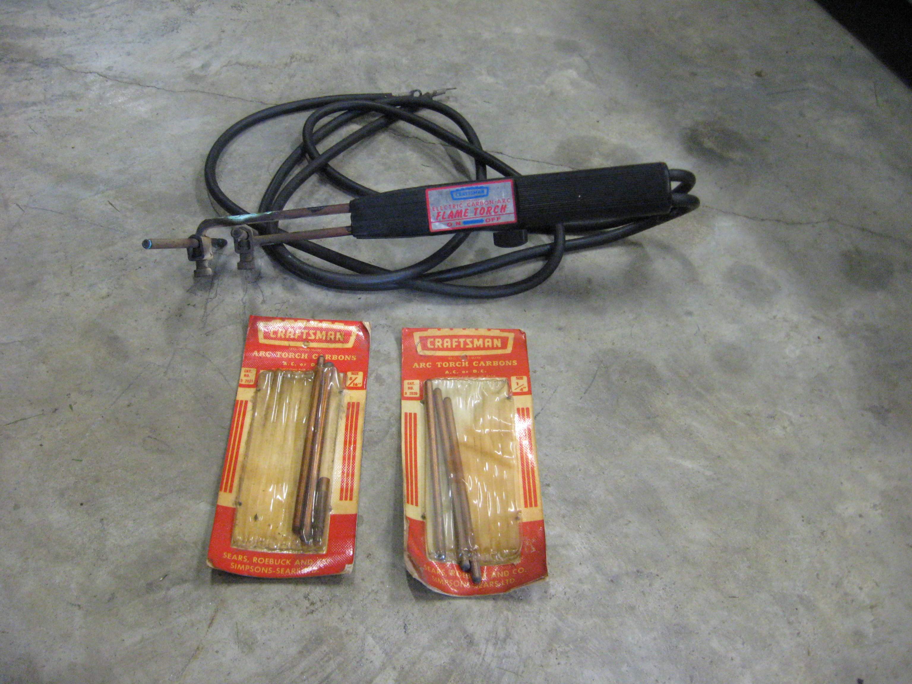

I have one. It's primitive, but it does work. Not very precise for cutting.
