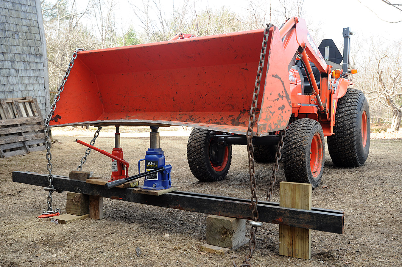

Seems to me that if it is THAT flimsy you should be able to just lay a few bits of 2 by and/or 4 by on the driveway, lower the bucket lip onto them, apply down pressure and bend it right back.
OTOH, if the tractor is too flimsy to press down hard enough on the bucket to get the front wheels off the ground... maybe you would be better off the get rid of the tractor AND it's flimsy bucket.

You can fix it yourself. I bought the tractor used with the smiling bucket and it is straight now. I had it under heavy load since then and it is still good. My guess is that your tractor's bucket may have had the bend when you bought it you just didn't notice it before.
Edit: No you do not have to have two jacks but I didn't want to point-load the cutting edge. Notice the plywood between bucket and jacks as well.

You can tack weld a piece of steel to the inner top edgeof the bucket and use that to give a square surface to jack against. The lip can be pushed back down that way. Simply cut the extra piece back out when you're done.
