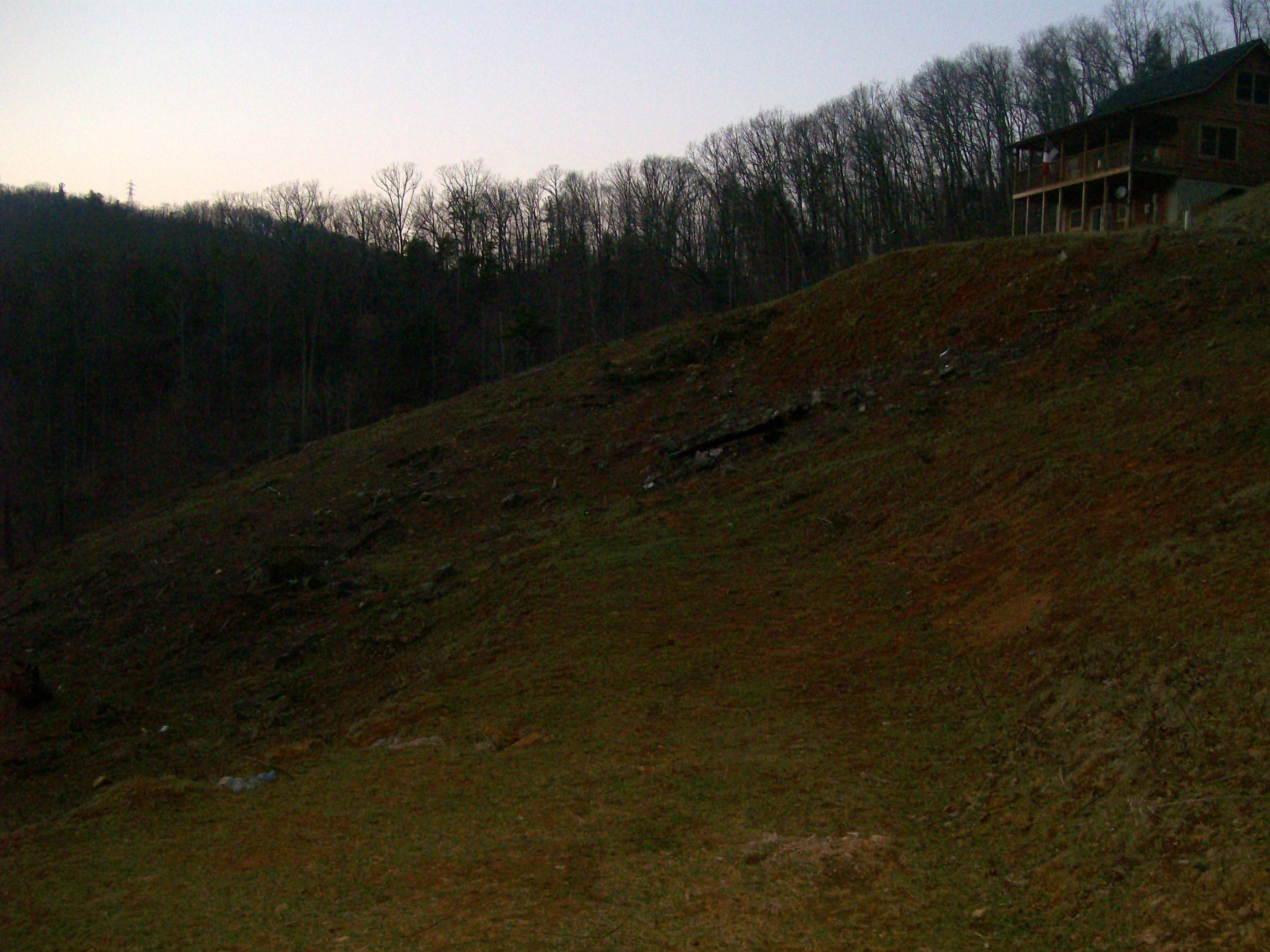

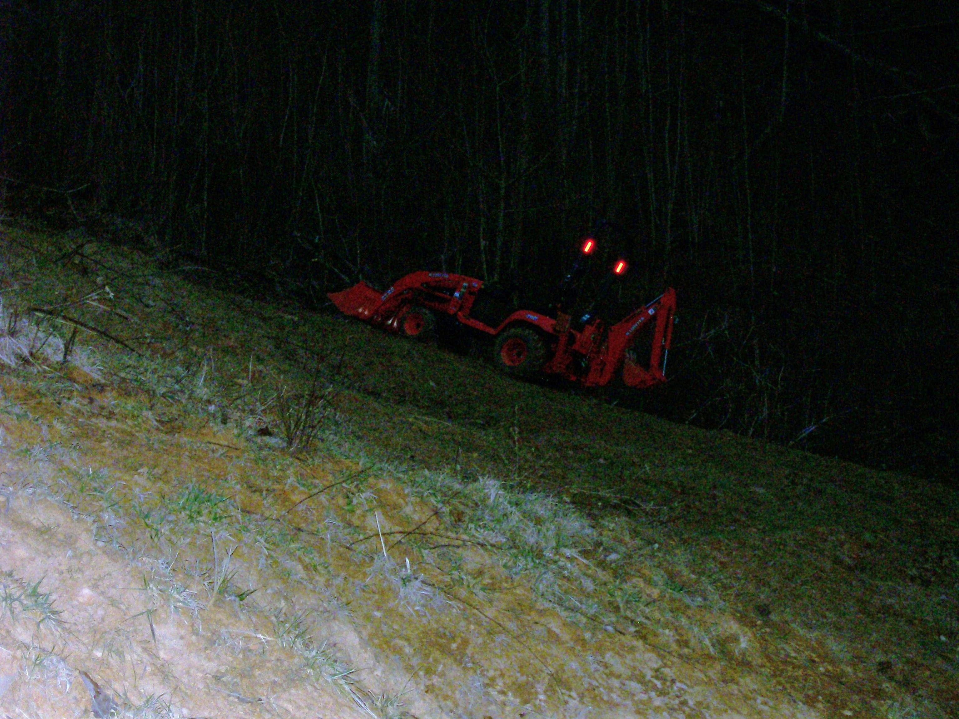

Before picking up my BX 25 in early December I was skeptical about how well it would perform on hillsides. After about 70 hours of use around my property, I'd like to say I'm very happy. The only TLBs I've used have been full size, and they have always made me nervous working around the hills of my property. This little machine is more susceptible to turnovers from uneven terrain than general slope angles. I'm not saying I won't flip this thing tomorrow, but it has proven to me that it is just as stable, if not more confidence inspiring, than any fullsize backhoes.
Below is a picture of my property, and some of the work yet to be done. The other shows my tractor. That day I moved boulders from the bottom of the hill to the top, and then used the tractor to transport bags of grass seed to be distributed.

That is a hill! :confused2:
